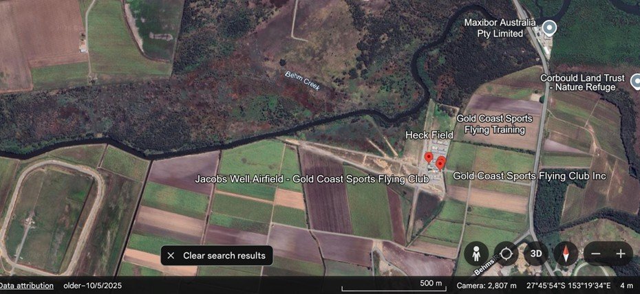

red750 Posted Monday at 09:35 PM Posted Monday at 09:35 PM A light aircraft with two persons on board crashed at Heck Field around 6:30 am today. Details are scarce, with authorities unsure if it was arriving or departing. Fears are that both occupants may be deceased. 7

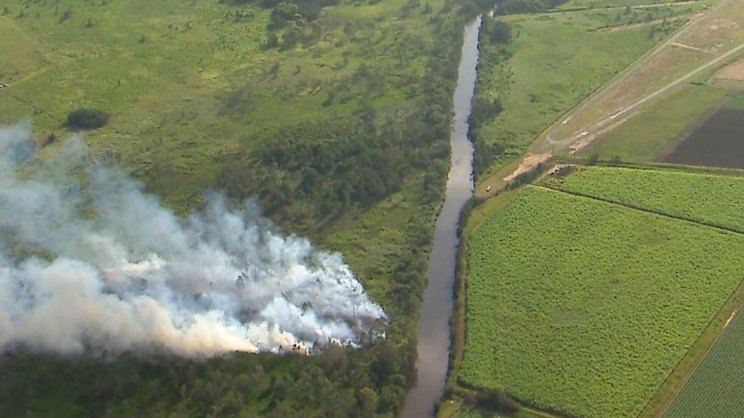

red750 Posted Tuesday at 01:09 AM Author Posted Tuesday at 01:09 AM Midday news report. Both male occupants confirmed deceased. Fire spreading fast in dry conditions with a strong wind. Most stupid report: They haven't located a black box. 1

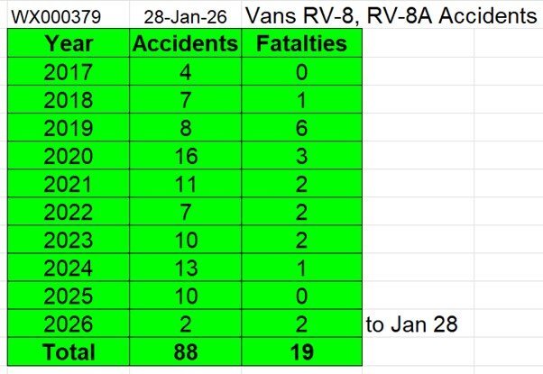

turboplanner Posted Tuesday at 01:34 PM Posted Tuesday at 01:34 PM Aviation Safety Network Accidents - Vans RV-8, RV-8A 1

Thruster88 Posted Tuesday at 07:08 PM Posted Tuesday at 07:08 PM 5 hours ago, turboplanner said: Aviation Safety Network Accidents - Vans RV-8, RV-8A I would point out this is world wide and the RV8 is a very popular aircraft. As an RV owner I read all these accident reports and think is that scenario likely to happen to me. How you fly and where you fly is a big factor in risk. RV's are beautiful, amazing, capable safe aircraft. 5 1 2 1
