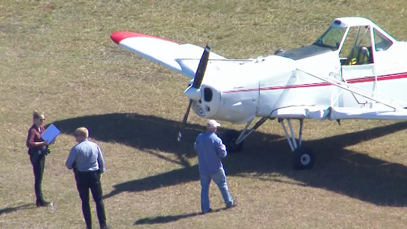

Looks like the Pawnee is the glider tug after all. So both pilots very experienced. Makes me worry about what chance I have around busy places with my lack of experience.

According to this report the Pawnee was going around as the Jabiru was taking off on the crossing runway.
WWW.ABC.NET.AU
One pilot survived the mid-air collision near Caboolture Airfield, which killed David and Jan Maddern on Friday morning.

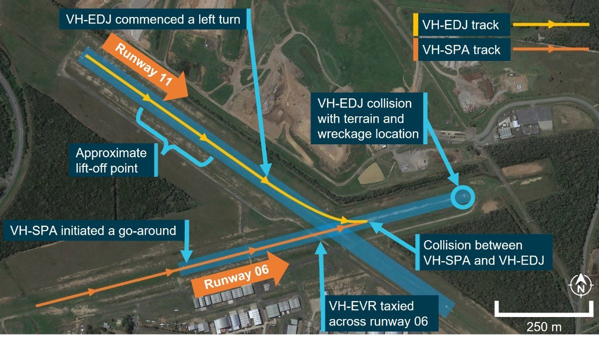

ATSB Update:
"ATSB transport safety investigators returned to Caboolture airfield this morning to continue collecting evidence as part of their investigation into yesterday’s tragic fatal mid-air collision.
An initial analysis of a number of sources of video footage showed that the Piper Pawnee glider tug aircraft was returning to land at the airfield on runway 06, while the Jabiru J430 was in the process of taking off from runway 11.
 The Pawnee was on approach to land before it commenced a go-around – an aborted landing. Go-arounds are a common and well-established practice in aviation and can be conducted for any number of reasons, but we will seek to understand why a go-around was conducted in this instance.
As well as continuing to analyse video footage, investigators will also conduct interviews with the Pawnee aircraft pilot and witnesses, download any available flight tracking data, and retrieve any avionics devices on either aircraft that may have recorded data.
On-site investigators will also use a drone to map the accident site, and look to fly indicative flightpaths of both aircraft to help build an understanding of what the pilots saw of the other aircraft.
The ATSB continues to call for any witnesses who may have seen the accident, and in particular for any pilots operating in the area who may have heard radio calls from either accident aircraft, to make contact with us via the witness form on our website.
The ATSB anticipates publishing a preliminary report, which will detail factual information established in the investigation’s evidence collection phase, in about 8 weeks' time.
A final report, detailing analysis and outlining contributing factors, will be published at the conclusion of the investigation.
However, should any critical safety issues be identified during the course of the investigation, the ATSB will immediately notify relevant parties so that appropriate safety action can be taken.

The report leads us to believe the tug pilot was going to land and hold short of the crossing runway, why was the cessna a factor?
Radio can not be relied on for traffic separation in a blind broadcast system anymore than traffic on a screen or tablet. All systems have multiple failure modes. Situational awareness is easily lost.
Edited by Thruster88
my radio goes on just after engine start and oil pressure established... squelch test button pulled/pushed to verify I can hear the radio open squelch noise in the headset. (IE verify audio path). this should give me about 10 miles of inbound approach aircraft traffic or at least 7 minutes of traffic listening (IE situational awareness). ADSB (in+out)  + tablet goes on about the same time  . Set to 4 kts minimum (ADSB broadcast velocity threshold) so that equipped aircraft can see me taxiing.
Edited by RFguy
There are nesting issues
If SPA had used the into wind runway it wouldn't have mattered about EVR
If EVR hadn't turned down his radio perhaps he wouldn't have crossed the runway
Aircraft taxying for the into wind runway should have been expected etc.
Who had the obligation to give way to the right etc.
Different weightings at different phases.
