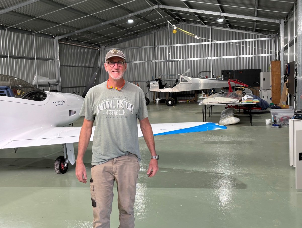

sfGnome Posted October 22, 2023 Posted October 22, 2023 A bit off topic (sorry!), but what is the finish on the hangar floor?
Kyle Communications Posted October 23, 2023 Posted October 23, 2023 looks like polished concrete..or a clear coat

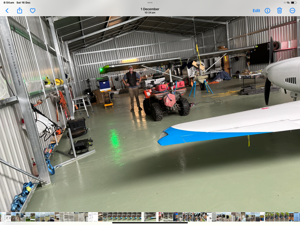

Mike Gearon Posted October 23, 2023 Author Posted October 23, 2023 I don’t mind a bit off topic when helpful information. Dulux 2 part epoxy. 4 x 20liter tins. Done properly with an acid wash and primer. 2 1
facthunter Posted October 23, 2023 Posted October 23, 2023 Makes little bits you might drop easier to find. Nev 1
Bernie Posted October 23, 2023 Posted October 23, 2023 In a factory I worked in back in 60/70's used PVA to seal a new concrete floor. It made it easier to keep clean. And smooth as. Bernie. 2
sfGnome Posted October 23, 2023 Posted October 23, 2023 Yep. My son-in-law has put an epoxy down on his shed floor, and it is *so* easy to sweep out. However, it did scratch quite easily when something sharp was dragged over it. One of these years, the DA for my shed will be approved, so I have to decide. Epoxy so it’s easy to keep clean, heavy duty vinyl or timber to help it keep warm (and a bit easier on the legs when you’re standing for a long period), or just bare concrete. Dunno. Guess it depends on how far the budget stretches. 1
