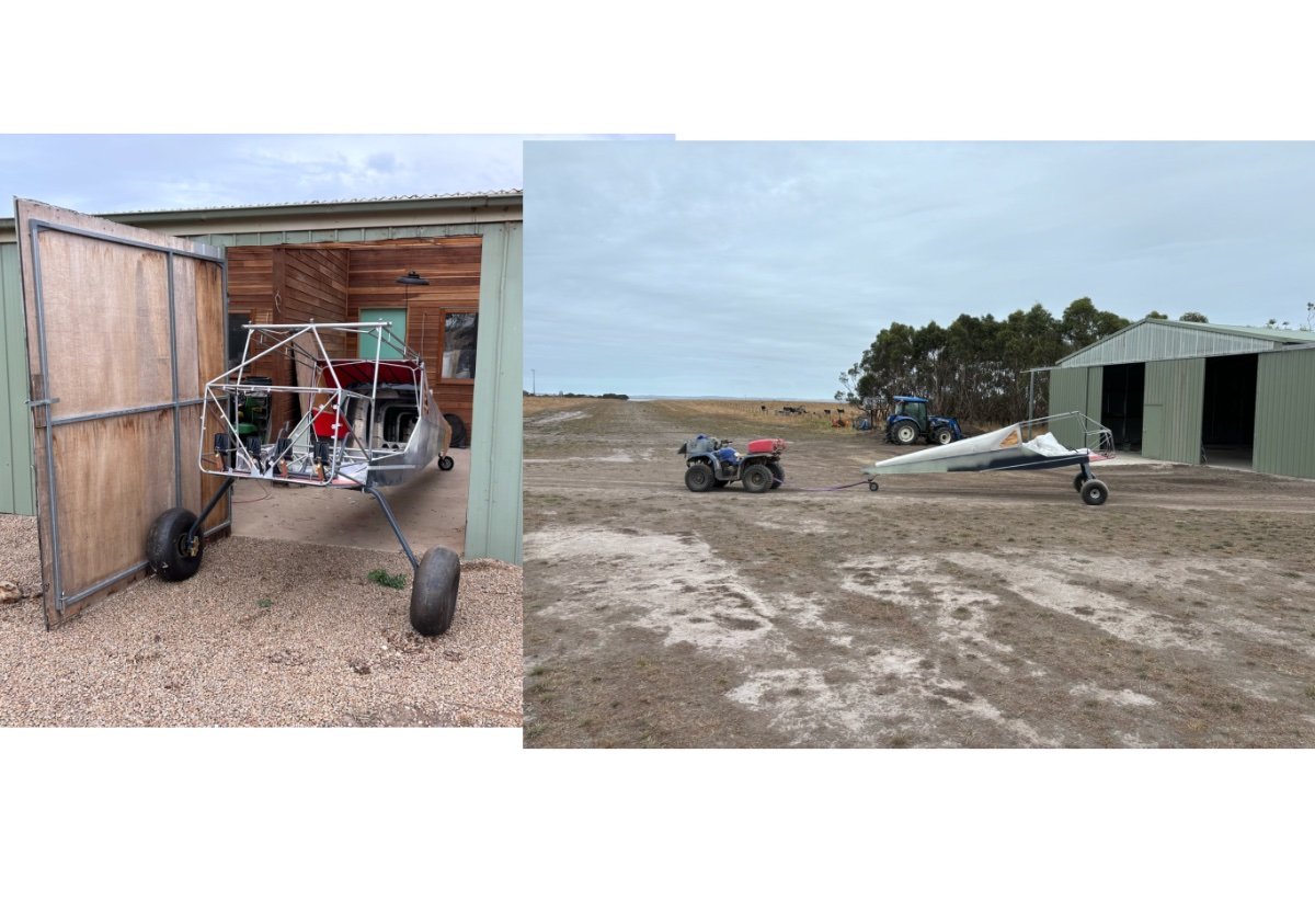

Temporarily moving the motor glider and S21 in. Motor glider has to go to Phil Organ north of Melbourne to get GFA certification for Australia. Can’t turn the motor off in RAA or CASA. I checked with RAA just to be sure. Can’t turn off. It’s a very involved process apparently to have it certified here. Will cost north of 10k. Loads of paperwork apparently and I thought of doing it but stopped at the word paperwork.

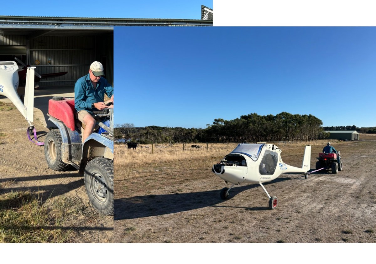

S21 towed from its old home.
