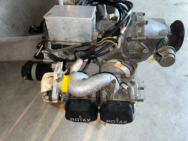

BrendAn Posted 16 hours ago Posted 16 hours ago 10 minutes ago, facthunter said: It was brought up if there was a risk of the Pipe collapsing, remember. I wouldn't be altering the original set up which is multiples lower in Volume. without a lot of testing including throttle response. Nev I understand that but I can't see how joiners would collapse. 1
facthunter Posted 15 hours ago Posted 15 hours ago You Pull a pretty high vacuum with the throttle closed if the engine is in good Nick. Bigger dia Hoses are More susceptible, but it wouldn't be the end of the world in any case . You have to allow for a slight change of length. Nev
