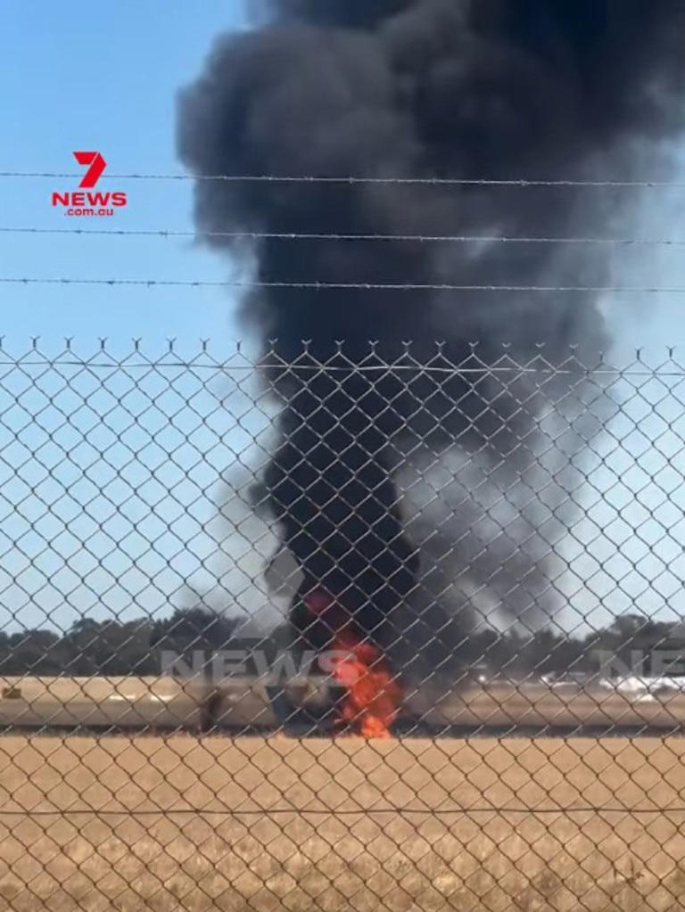

red750 Posted January 5 Posted January 5 A student conducting a solo flight in a Cessna 172 at Parafield Airport crashed into the runway. The plane caught fire, which spread to a grass fire, but the student walked away without a scratch. 2 3

red750 Posted Tuesday at 01:47 AM Author Posted Tuesday at 01:47 AM The video was shown on Sunrise this morning but has not been uploaded to the news page on the internet, and has not been uploaded to 7plus streaming, even the Adelaide News version. Other video, of the student pilot being interviewed by the Ch 7 reporter, and vision of the fire and burnt out plane are shown, but not the stall/crash. That may be uploaded later. 1
red750 Posted Tuesday at 02:30 AM Author Posted Tuesday at 02:30 AM A report posted on Facebook... A transport safety boss has said a trainee pilot is “a very lucky young man” after his light aircraft crashed into the runway and caught fire at an airport. The 21-year-old was conducting just his third solo flight when the incident occurred at Parafield Airport in Adelaide’s north at 12.30pm on Monday. The ATSB has revealed the student was conducting circuit training and attempting a touch-and-go manoeuvre when things went wrong. “They’ve bounced heavily on their first go of touching down the runway. Then, in that sequence of trying to then lift off and apply power, there’s been insufficient airspeed,” Australian Transport Safety Bureau (ATSB) Chief Commissioner Angus Mitchell explained. “That’s caused the left wing to stall and to come down and impact with the runway there.” The pilot managed to extract himself from the aircraft and move to safety around 30 seconds after the collision with the ground. The aircraft then caught fire and was destroyed. Despite the dramatic incident, the young aviator, who was unhurt, says he’s keen to get back in the air. “I feel lucky,” he told reporters of the incident. “I just want to practice more and fly better and next time will be better. “It’s a bit sad to lose the plane I’ve been flying like 20 hours (in), but I just want to move on, just want to learn more.” The Australian Transport Safety Bureau has confirmed it is investigating the crash. “Very fortunate student pilot, less so fortunate owner of the aircraft,” Mitchell said. Mitchell said investigators would examine the aircraft itself and gather more details about the pilot’s experience and what led to the loss of airspeed that caused the collision. “We see around 20 incidents and accidents every year with student pilots doing solo flights,” he said, noting that student pilots on solo flights present a certain level of risk. The ATSB is still gathering information to determine the full extent of the investigation. The video accompanying the report concentrated on the fire, pall of smoke and burnt out aircraft, and did not show the stall and crash. 1
