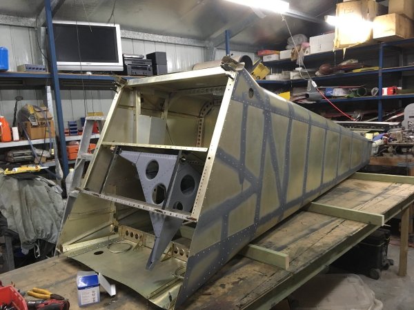

Just to clarify, where you talk about etch primer on the rivet lines, you mean on the outside of the skin only (ie not on the inside where the black stuff is)?
Does having primer under the rivets stop them from making a tight joint? Could the layer of primer flatten over time and allow the rivets to loosen?
Yes correct only on the outside that way the heads of the rivets have a coat of etch under them. The etch primer is super thin not like a full paint job like the pictures

 Anyhow the rivets work by Holding the surfaces TIGHTLY together and rely on the friction to prevent movement and putting more shear load on the rivet(s). .015 thou sheet is really too tin to just rivet. Bonding would be the answer in these circumstances where the stress needs to be  spred along the lap join. It would also serve to stop moisture. If you sprayed WD 40 , or anything oily it would weaken the joints by reducing the friction between the  sheets. and putting more shear load on the actual rivets and star cracks to form from the Hole(s).  Nev
Very rare that 0.016" is riveted to another 0.016". Mostly to 0.025", 0.032" or thicker.
So, generally speaking, don't use etch primer AND black stuff I got out of this. So I'm still not sure what I should do to prevent corrosion apart from using the black stuff. I'll be flying coastal A LOT, the plane will be outside and I won't always have access to fresh water to hose it down straight away. I'm just concerned if bare metal is left inside the plane I'll regret not having done anything in a few years.
The bloke who did the first inspection of my 701 advised me to get a spray inhibitor - think it was Cor-Ban - and said it misted so well that even giving a few blasts into the wings through the root lightening holes would give a good coating.
Unfortunately I bought the wrong one by mistake - ended up with avionics corrosion inhibitor which doesn't mist well at all.
In any case something like that or ACF-50 which seems to be heavily advertised when you search "Aircraft Anti Corrosion spray" could be an option.
If you're rolling the black stuff neatly then maybe you could tape over it after it's dry and spray the rest of the part with either etch primer or a corrosion inhibitor.
I did mention :
My Sonex Legacy has been undercoated/treated, during the fabrication/pre assembly stage, using the following spayed on products:
  • External: DeSoto 51X349
  • Internal: Alodined,/ BMS10-11
As I was not the original builder of my Sonex, I don't know  what the selection process was for these products  however I am assured they are both excellent anticorrosion coatings for aluminium aircraft.
Definitely do not spray any oil containing substance around. Rivets rely on contact between the two (or more) surfaces.. In your circumstances Christin, I'd specifically seek advice from people operating in salt  I know the C-180 float plane is stronger and  specially corrosion treated when built.  Nev
Christin
In the light of your intention to carry out beach landings you may want to consider whole of airframe corrosion resisting treatments;
I have used Tectyl 506 in marine & agricultural environments, as a corrosion inhibitor. It's a sprayable wax that is usually thinned to spray or "fog". I have found it to be excellent. Best applied with the appropriate "gun"
An earlier respondent mentioned aircraft specific ACF-50 and I have heard of ARDROX DINITROL AV8 . Being aimed at aviator, I imagine they will be costly. Note: I have no experince of these products.
It is water based and supplied in the ICP savannah kits for putting between mating surfaces. We tried finding a equivalent here. I found a maybe similar product used in marine applications but never bought any to try. I just order the tins direct from Aerokits the ICP distributor. My RANS is being done with it as well. Having dealt with a few wrecked sv's and rebuilds and a new build this stuff is very good and the alu does not corrode or scale at all between panels..rivets maybe corroded and other parts but where ever the black stuff is the alu is perfect no matter what age
Christian if you are going to be coastal all the time then consider alodining.
It actually isnt that expensive if you can find a powwdercoating place that does it. There are plenty around and they often have 6 metre long tanks that can do your skins no problem. The smaller parts you can do at home like I did. Just need to make a good size tank about 1 mtr long and about 300 high and 300 wide. Alodine..the good stuff is available...I got mine from a distributor over the south side of bbrisbane. My S rebuild is completely alodined . The sheets are easy..well the big parts because someone else does them for you but there is a lot of small parts. You need a acid bath first then wash them off then alodine them and let the alodine dry.
The black stuff is still a must. I also would spray etch prime over the where you will be putting in all external rivets like the pics I posted
Alumiprep was what was recommended to ME to be used first. It came from the same place I got the alodine. An aircraft only supply place near Essendon airport. Nev
