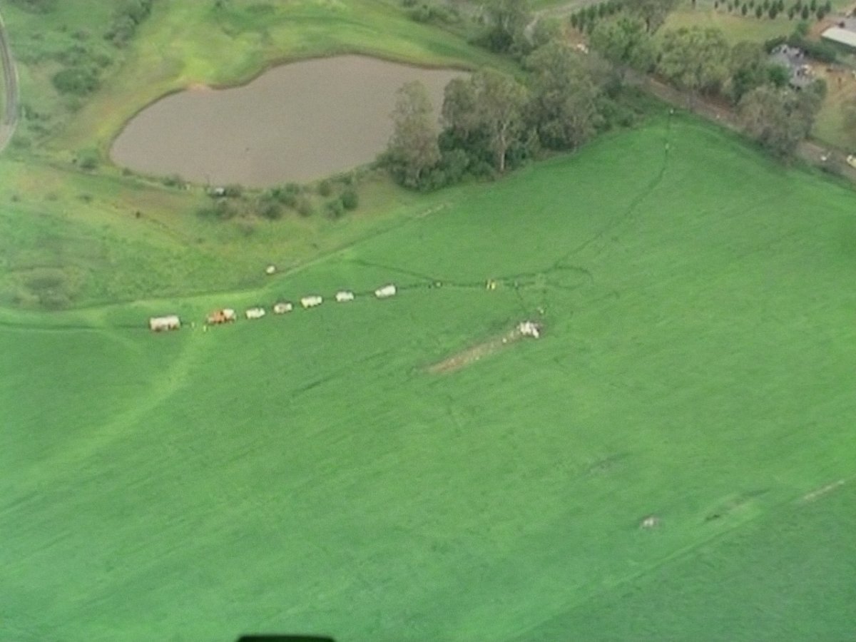

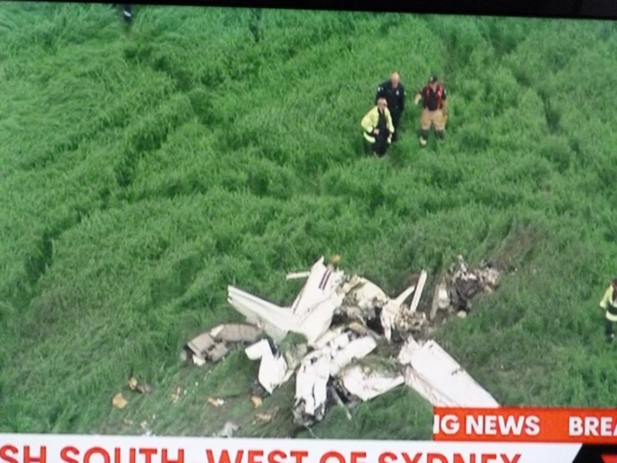

red750 Posted January 24, 2024 Posted January 24, 2024 Another light plane has crashed south west of Sydney. No further details to hand at this time, but it looks pretty serious. Photos from Channel 7 News chopper.
kgwilson Posted January 24, 2024 Posted January 24, 2024 Not much left there. It will be miraculous if anyone survived that.
FlyingVizsla Posted January 24, 2024 Posted January 24, 2024 Channel 7 saying one has died. One suspected dead in plane crash near Sydney 7NEWS.COM.AU Emergency services are responding. Channel 9 says it is a Cessna from a local flying school. https://www.msn.com/en-au/news/australia/light-plane-crashes-south-west-of-sydney/ar-BB1hap1T Mr FV is doubtful it is a Cessna and want to know what the crop is. Seems strange that it ended up in such a mess in a clear paddock.? All the wreckage together and a short straight scar on the land. RIP
facthunter Posted January 24, 2024 Posted January 24, 2024 It possibly IS a Cessna. Maybe there was only ONE in it. . Pretty heavy contact. Nev

KRviator Posted January 25, 2024 Posted January 25, 2024 (edited) Something's not adding up for me... The reported wind at the time (1500L)was out of the northwest at 9G13, so almost direct crosswind for the runway (and downwind leg...) meaning GS is almost equal to KIAS. The last ADS-B return on the downwind had him doing 80Kts GS, before it increased to a reported 90 and beyond in a 3000FPM descent and entering a slight left turn. 80KIAS is way above the S&L stall speed of a light 172 - even cranking a load of bank you're going to need near 60* and about 2G to get close to stalling it at 80KIAS - and that kind of turn isn't reflective of the ADS-B track - especially when you compare that to the track of that Cirrus at Gundaroo you'll find they don't marry up insofar as a stall/spin accident. It looks more like that 172S prang out of Melbourne where the student lost the fight with the autopilot ALT HOLD mode - though why you'd be using the AP on a downwind leg on your first solo in a 172 I cannot fathom... Edited January 25, 2024 by KRviator 2 3
kgwilson Posted January 25, 2024 Posted January 25, 2024 You wouldn't intentionally be using AP & the student would not have even been shown how to activate it. He may have inadvertently activated it but that seems pretty unlikely, but then anything is possible. 2
facthunter Posted January 25, 2024 Posted January 25, 2024 I'm inclined to think that something was amiss with the aeroplane, itself . Nev 5 3 1
