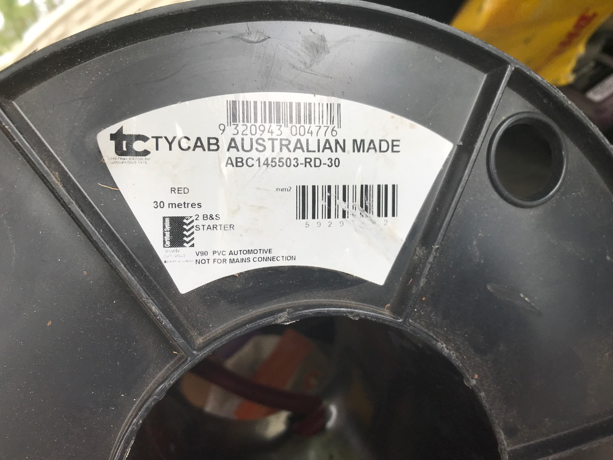

I buy Tycab Australian Made cable via Cooldrive, cost more but worth it. Gave  Junkar away a long time ago…..
https://www.tycab.com.au/

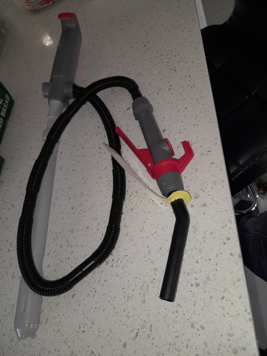

Try one of these. Put drum on wing, turn on and pull nozzle trigger, runs on 2 "d" batteries and lasts for ages.

l’ve had my eye on one of these.
What do u reckon they would be like in lifting fuel 1.8m from the ground straight up to a high wing ?

Its not much more than a powered syphoned - a jiggler would be just as good, at a fraction of the price AND you still have to lift your 10 -20L up onto the wing.
If I am being charitable, I would say that it probably reduces the chances of accidental spillage but at $78-90 that's a lot of dough to spend on a syphon.
I could envisage hanging a collapsible jerry can on the tiedown point at the top of the strut, and then pumping from there with one of these. This is still uphill so a siphon wouldn’t work. Lifting 17kg of collapsible jerry can to this point beneath the wing is readily doable, and the pumping lift from there would be around 75cm.

Only used it for the Piper and car, if you can get it within a metre it would work fine.
