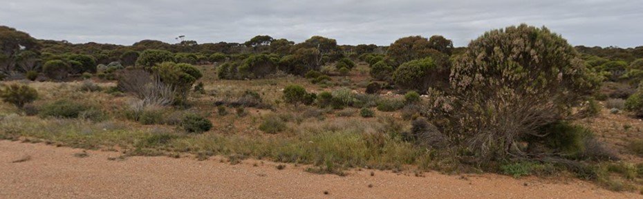

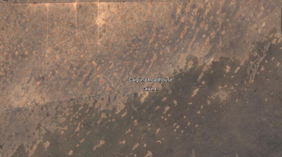

North of Caiguna/strip is open country, south is scrub and dangerous, so I wouldn't be planning any circuits over the scrub. Photo xCaiguna shows the strip and Highway, xOpen is the land north of the highway, xscrub is south of the highway. The definition is not good enough to decide whether the Open area is landable, but it would only be about 30 degrees from the takeoff line.
(The strip is in the picture, one of the patches just SW of the roadhouse.)
Edited by turboplanner
It is a pretty decent strip of 1265 metres according to Mr Google. The best place to land is on the Eyre highway or to the North where there is no scrub. To the South West though there are quite a few clear patches. One is about 3km from the runway and is about 1100 metres long in the same direction as the runway. If you had some height this would be quite possible but without it in this direction your choices are very limited.
