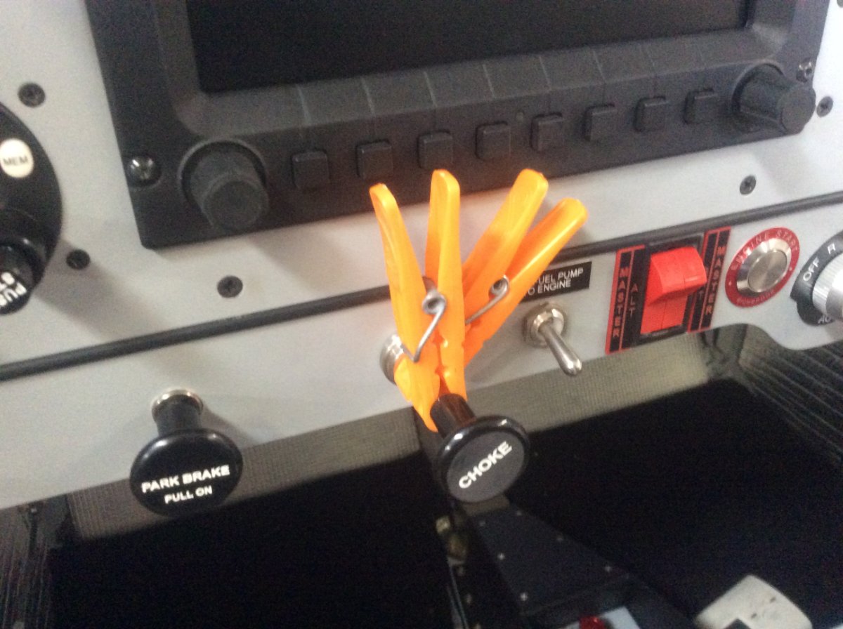

I fitted my last aircraft with a nifty motorcycle choke that had a friction nob so that I could lock it full closed, thus freeing my hands to do other things in the cockpit while I started the engine.
My new aircraft comes with a genuine aircraft choke, that must be held in the full closed position for starting (no friction devise). I find this to be very inconvenient. A  third or even forth hand, would be a great help. In leu of additional hands ,this is what I have come up with:
Crude, simple, efficient, cost effective and allows for half choke very soon after start
Very inventive. Now you just have to find a place to clip them when not in use. It’s just occurred to me that there is a whole generation (or two?) of car drivers who would have no idea what a choke is. Damn, that makes me feel old! 🤨

Correct and the engine won't start if there is any more than a crack of throttle. Part of the cold start procedure is to make sure the throttle is fully closed. The choke stays where it is put on my Bing.

You could move the start button between the park brake valve and the choke. Fingers on the choke, thumb on the start, other hand on throttle. Problem solved. Got a pic of the entire panel layout?
Agree, needs rearrangement.  Pegs stupid.  I would have had the start button and enricher (Choke) closer, from the getgo.  Moving the Alt / Battery switch unit will also allow them to be closer.

Thank you for your kind words - Its easy to be critical but in the end the "clever" pilot works with what he has - pegs, in this instance are cost effective, light weight, do not require reengineering/wiring and easy to use.
My comment is directed at the builder, yourself and it is an easy fix if you want to do it.  I would not accept the use of pegs like you have.  It's not good in my opinion.  Even change out the enricher device.  I have seen setups where the enricher is pull to 'ON' and a 90 degree turn locks the position.  After starting it is turned 90 degrees opposite and it springs to fully off.  You should consider such / similar.  You have asked assistance / comment with many things for your build and this is my comment to help.  Its not a direction just a comment.
I'm not sure I'd be using items such as pegs in an aircraft. What if one slips off, or out of your hand, particularly in flight? - and lodges in a position where it cannot be retrieved, or is extremely difficult to retrieve?
Coins are notorious for lodging in control systems and causing disasters or near-disasters, pegs are likely to be up there with stray coins.
You don't need the choke for more than a few seconds in a 912.  Engine fires then slowly push choke back in
. don't see why you need to keep it pulled out like that.
In the Jabiru, the engine will not start if you have the throttle open and try and use the choke. If you try to put it away too soon, the engine stops. You need to run it for about 20 seconds before you can shut down the choke.

Geez! Critics. I might be a nut, but when I read the original post, and having met Skippy, I simply saw it as a bit of humour.
I was going to suggest these: J.Burrows 15mm Foldback Clips 28 Pack Only $3.24 a pack from your local Officeworks store.
When not in use, the clip can come back over the shaft of the handle and be out of the way.
"What if one slips off, or out of your hand, particularly in flight?" - , slightly odd comment, - the choke is not used in flighty (or at least I have never done so) so a your concern is moot.
Rotax 912 ULS starts easily on full choke a (which includes a slightly elevated engine speed) however it is desirable to reduce to about 1/2 choke within a few seconds (the engine note will guide the pilot). There is then a (only) slightly longer few second and the reaming choke can be opened.
The choke actuating cable (it has Siamese ends for the twin carburettors)) is a  certified unit (not as per my last aircrafts adaptation from a motorcycle). The carburettor return (open) springs are quite strong so the "button" will literally snap back into the open (in) position if not held in place.
I reperched alternative Siamese choke actuators and only found one  (in the US) that had any sort of stay closed ability - not in production at the time.
The two pegs fit perfectly on the choke button shaft giving full rich & increased RPM  for start up and  then with the removal of one 1/2 open for on going engine running again engine note will guide the pilot for removal of last peg. They are easily & safely stowed for flight.
Of course the pegs need not be used but then one hand is fully occupied for the short start period leaving the other to perform such tasks as the pilot may require - having both hands free makes a significant & welcome improvement. It is far easier to know with certainty that the choke is fully closed (without having to have your hand there) - start, listen for the engine note (smooth out) change, remove one peg (& stow) leaving partial choke while monitoring/reacting too  RPM, oil pressure, EGT rise, listening out/responding, etc etc. The last peg can be removed & stowed without hast a little while after initial start.
The pegs also give a high visibility indication of choke position - a friction or 1/4 turn locking, devise may not be quite so obvious, resulting in reduced engine power and elevated fuel consumption
For this person, multi tasking is possible, despite my masculine handy cap but any little aid to reduce the burden  is welcome.
Yes, my apologies, my wording wasn't really good enough, I was referring to "flight" as including the starting procedure, where you were actually commencing a flight, and a peg fell off.
Being on the ground still, even though the engine is running, is better than being airborne, and losing a peg in the cabin.
