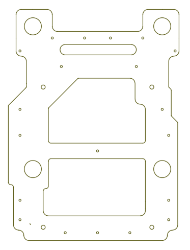

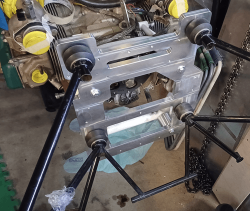

Finally got around to finishing the CAD for the mount adaptor plate.
Off the to fab shop for that 12mm slab of 6061T6. 5005 would have been fine but its what I could get in the size.
The big holes mate with the Jabiru engine mount with the rubber donuts.
The smaller holes (4) interface to the ring mount
lots of little ones are just utility threaded M5 thru. dont need the rib across the middle but I can always cut it out.
Edited by RFguy

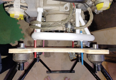

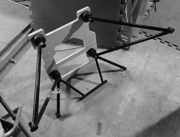

Well, looks like the drawing is good (Plywood CNC) . Will ponder it a bit then get the ally cut.....
Three pics below
not holding perfectly aligned/square but you get the idea.
  • Like 7

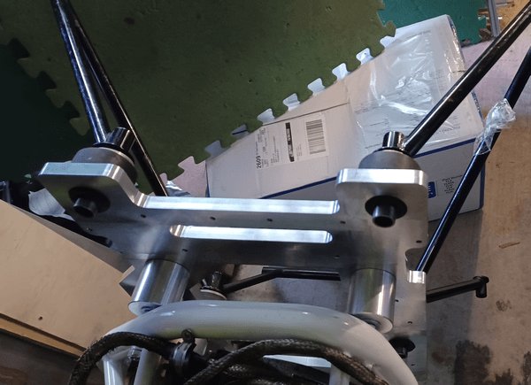

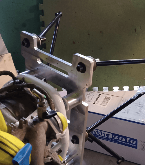

...The fat spacers ensure the bolts stage square with the plate. next rev I would pin the spacers to the plate, also.
image.png.601332105ef2783e2f639971bc5586e7.pngimage.png.118c56792d783846a493d7c07100a91f.png
Edited by RFguy
  • Like 7

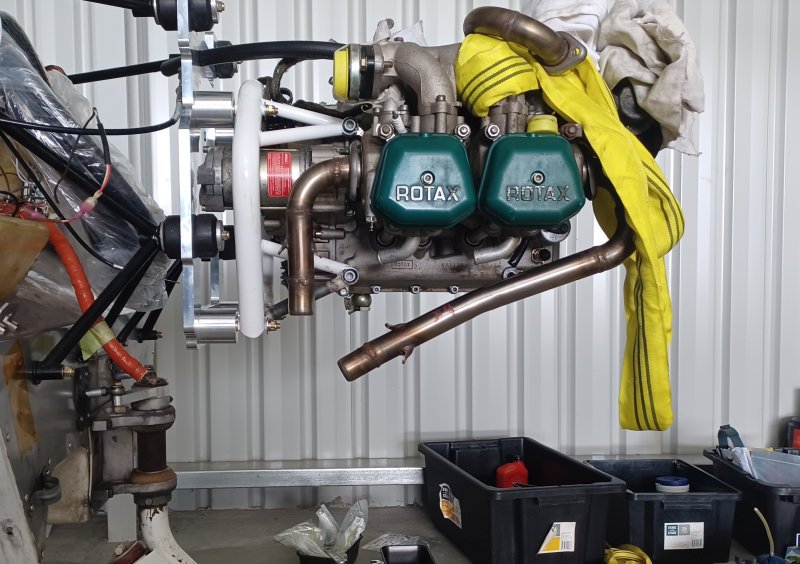

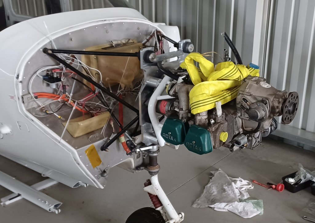

Next steps:
1) Fit engine mount back onto aircraft. that's a bit of a bastard of a job to get at the nuts behind the instrument panel.
2) bolt mount, adaptor and rotax  and simulated weight prop  on the front
3) Weigh aircraft- measure CG to see where I am at (I should be *slightly* nose light, still) - this will guide my oil and water cooler and oil tank  locations.
4) slap the cowls on and see how the underside looks for space. The rotax sits lower than the Jab engine because of the gearbox. My mount adaptor is designed to preserve the thrust line precisely. I am expecting some modification because the exhaust is slung under.
The prop flange is about 25mm further forward.  This was unavoidable as I needed the bushing spacers between the adaptor and the ring mount because the rubber donuts would get in the way.
There is good access to the water accessories , alternator/ignition magnets etc through the rear.

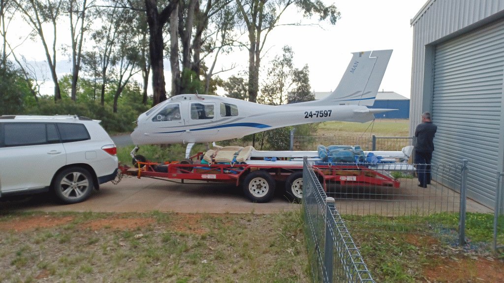

moved back to Cowra from Temora for Rotax install.. Thanks Thruster88 for your invaluable experience and assistance. (pictured)
Edited by RFguy
Sorry for dumb question but, what happens to 24 rego for your conversion?
Calculating my engine mount bolts and tensions....
1stly, I choose AN bolts, they're well specified, can choose precise grip length, and metal lock nuts are available. AN bolts have a reasonble tension gap between yield and ultimate tensile strength. They're not brittle like a 12.12 , more like a 5.7 etc
Total grip length required :
* 12.7mm Adaptor Plate thickness
* 45.0mm spacer thickness (the role of the spacer is to ensure the bolt stays in tension not shear on the plate), and for clearance of the Jab suspension donuts and starter motor needs about 43-45mm.
* 37.0mm : minimum length of the four of the  8mm ID tubes through the ring mount.
*1.6mm x 3 (three washers 0.062") . one of these washers is between the aluminium spacer and the 8mm ID tube as a LOAD spreader.... otherwise the pressure on the spacer from the end of the tube would exceed the ALuminium compressive strength)
=99.5mm total.  That is what I need for GRIP LENGTH
This is (99.6 - 76.2)  =3" + 23.3/25.4 inches = 3.9173" , or 3"  and (0.9173/( 1/16" )) = 3" and 14.6/16  which need to choose the next lkower to ensure we can pull thread with some margin - so next lower is 13/16"
Looking up the AN catalog - nearest bolt size is 3" 13/16" , this is an AN5-42.
Local supplier has AN5-43... these are 3 " 15/16" grip - total 100.01mm. too long. nothing an extra 62 thou (1.6mm) washer wont fix for the moment even if that isnt perfect.
Now, these are long bolts,  bolt stretch at tension will be significant, let us calculate the likely bolt stretch to determine if our grip length is too long.
The minimum spec for the bolt  is they yield at 4980 and shear at 5750 pounds.... back in metric - 2259kg / 2608kg. or 22kN/25kN
Working back for the cross section of the grip region, (~ 7.93mm dia) , this amounts to a yield strength of 449Mpa
The tension needs to be at least the likely load variation over use. That's pretty low . The bolts will always be in tension unless a bolt becomes loose or stretched, IE JOINT SEPARATION and then it could be all shear if another bolt does same.  The joint must remain in tension during eload excursions.   The weight on the mount is call it 80kg , lets say two bolts end up doing all the work due to some other failure, so we have 40kg/bolt and lets also so this loads are purely tension loads, for the moment  say... aircraft suffers 10G bumps, so there is 400kg on a bolt- . 400kg on a bolt out of 2259kg yield is only 17% of yield ! so that is our minimum tension.  We'll use 20%.
Now! Bolts with combined tension and shear loads have lower limits, and it is possible we might have this scenario in a partial failure mode (joint spearation) . But since we are not up near the limits, we can simplify the requirement.
For a 20% preload on these fasteners, about 4400N , this corresponds to a stretch of 43um.  luckily I can measure this to verify tension because I have access to both ends of the bolt. At 50% preload, we are up to 110um (0.11mm very measurable ) . Note that the yield strength numbers are the MINIMUMS. this means that if we measure 0.11mm stretch and the bolt is much higher in strength than the minimum, then we have alot more tension than we expected.
Another aspect of the preload is that it pulls the joint together .The 45mm diameter, 45mm long cylindrical solid spacer needs to be kep fast against the plate. Preload tension will assist that.
Consulting AC43.13-7 , using regular nuts MS20365, the maximum torque for a bolt at 40ksi  (something approaching 60% of yield )   is met at ~ 100 to 140 inch pounds.
Dry cadmium plating  with a torque of 60 inchpounds, the lower end of the AC spec ,  will deliver approx 5900N tension.  We wanted 4400N. If we torque to 50 inch pounds, we would have about the desired tension. We can cross check this with bolt stretch monitoring.
Let's now check the pressure on the aluminium plate under the standard washer :  0.562" OD,  = 0.248sqinches - 160e-06 sq meters, and a tension of 4400N, provides = =4400N / 160e-06sqM = 27Mpa, well below the 170MPa+  for the 6061T6
How about the steel tube through the ring mount- this is a tube welded at each end, a column fixed at both ends.  the maximum loading comes out to some ridiculous number of  newtons.  No issue...
Let's check the shear resistance for the ally plate onto the ally spaces. The cylindrical ally spacer has mated area of 0.00154m2, and a pressure (with 4400N of bolt tension) of 4400/0.000154 = 2.86MPa.  Given the thickness of the spacer (almost square length = diameter) the pressure will be almost uniform and provide same bolt tension/clamp pressure.  The spacer and plate joint should be assembled clean, no lube or contamination in order to provide maximum shear resistance.

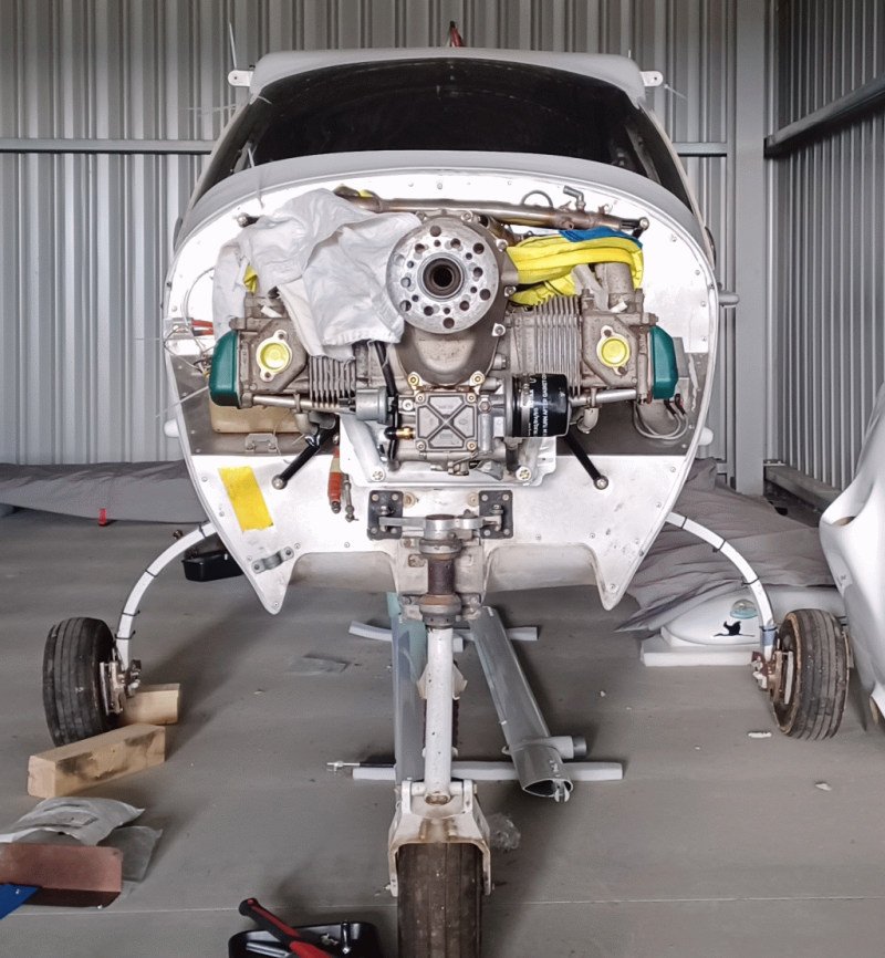

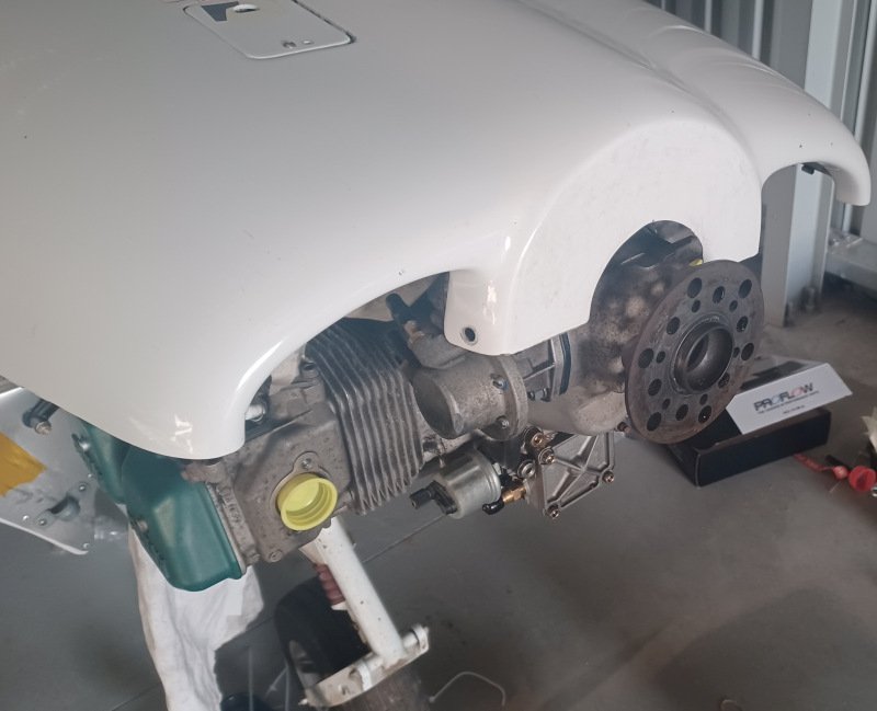

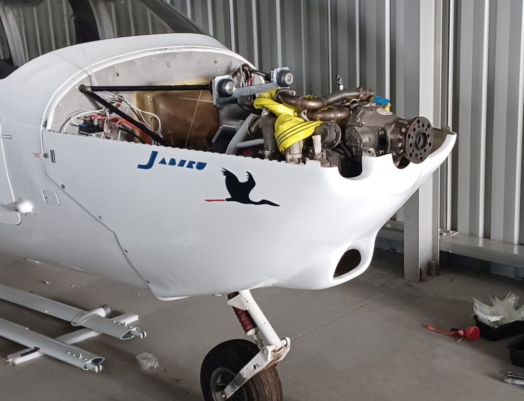

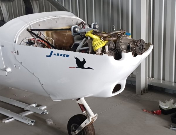

progress. as known, engine is about 30mm further forward, and the front of the top and bottom cowling needs modifications.  thrust line and centre is all good.
Edited by RFguy
  • Like 7
The exhaust ill be custom- that's just what I got.
some weird phone camera image distortion in the side view
The oil and water cooler will be underneath. The exhaust and turbocharger will be under and forward of the ring mount. That pipe is heavy. 30mm OD, 1.6mm wall. Wil use corrugated SS hose to connect collector, and maybe see how the collector goes paper thin. the turbocharger has to mount to something.
The front cylinder  cheeks will need to be made a bit wider in the case I reduce compression with cylinder shims.
Edited by RFguy
