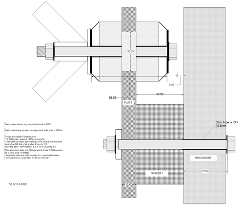

For the drawing in fine, see the bitmap attached.
The jab mount interface with the standard Jab mount, and has the standard compliant donuts doesnt need any further thought- that is per jabiru design.
But the interface to the ring mount needs some thought - Calcs done for 10g shock load
Is 10g enough ?
Shear and overturning moment Loads on the bolts are OK at that. AND
- the Jab mount- the rubber donuts are compliant so that the transient- peak shock load at the  ring mount will not all be imparted on the ring mount-plate bolts .
However- the M8 ring mount bolt running through the ring mount and aluminium plate - on the ally plate- it is within the min 100 Mpa proof stress of the plate , but  load there requires those holes to be tight fit to maximize the load area .
Spacer between ring mount and ally interface plate ideally needs to be a milled ally block with the ring mount radiused into it for a tube  snug mate or a tubing saddle washer used.
Preload tension in those bolts needs some thought, if the spacer is non compressible,  regular cyclic loads should be within the preload.
If the spacer is compliant, the bolts will see more shear and overturning loads. Does the spacer need to be pinned to the ally plate ? Spacer should be sized such that the face clamp forces do that work.
conclusion - Overall, the peak loads are well within the bolt's and interface plate capability assuming the interface plate was fixed in space. Because the existing Jabiru shock mount is present , the full peak loads will not be present on the ring--interface plate interface .
If the interface bolts were tightened to 16Nm, (on a 5.6 bolt) there would be approx 10kN preload (~ 80% of proof)  for k=0.2 , which would be plenty. actually likely to be 2x more than necessary. A 16mm dia washer on the ally plate would generate 69Mpa on the ally plate  - need to check if that is a long-term stress problem even though way below the max.
The non compressible spacer is an easily calculable solution- I'm left with nearly pure tension and sheer loads .
A compliant, compressible spacer is a different story.
I will have to do the calcs on the bending stiffness of the interface bolts IF there is compilance in the spacer. and this is bending on a preloaded bolt, just to complicate things. which likely means that expecting peak bending stresses + required preload should be < ultimate stress.
I will need to do some research on the different behaviour (elastisicity ) of the different bolt numbers/materials.  = like ASTM307 is quite elastic compared to A574
What is my analysis like - Engineering comments please ? (useful comments only please, not commentary)
image.png.a41fb99c3f40acd8af04ed51bc6c103d.pngimage.png.c3b5c5127c0c8b69fbb6ce5e5c381c64.png
Edited by RFguy
post script - bending moment calcs on the interface bolts show that the 40mm spacer MUST be non compressible , non compliant,  as the 10g overturning moment peak shock loads are wayyyyyyy  above any M8 bolt capability.
You could get the adaptor milled from 50mm plate with nice radius curves on the four integrated spacers.  M8 12.9 grade socket head cap screws?
