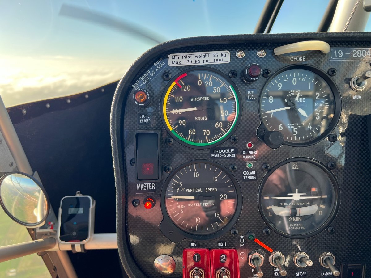

Fitted in an hour flight in the Nynja this morning. My findings were that I'm very happy with the E-Prop propeller. It was set with the three blades at 24.9, 25 and 25.1 degrees; being within the 0.3* I decided to leave as is and fly to evaluate. Ground static rpm was 5,400. First flight climb 1,400 f/m (better than DUC never much over 1,000 one up) Noticed had to put in right rudder (was perfect with DUC and the rudder input was more than acceptable) also during taxi to take off point noticed low rpm was a faster travel speed, also runway is bitumen sealed. 4,500 rpm 85 kts; 5,250 gave 108kts (quickest with DUC was 105 kts at 5,500 rpm). Landed and moved rudder bungee 6mm to port. Take off climb 5,250rpm and 1,250 ft/m OAT 24*C. Only slight need of right rudder (certainly acceptable) so will move rudder bungee another 2mm to port. Will before next flight re-pitch for 5,500rpm static. There is wild weather coming so will be a week or so before flight.

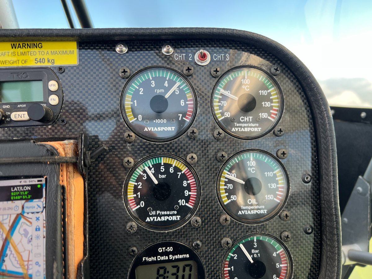

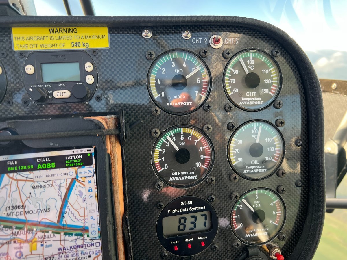

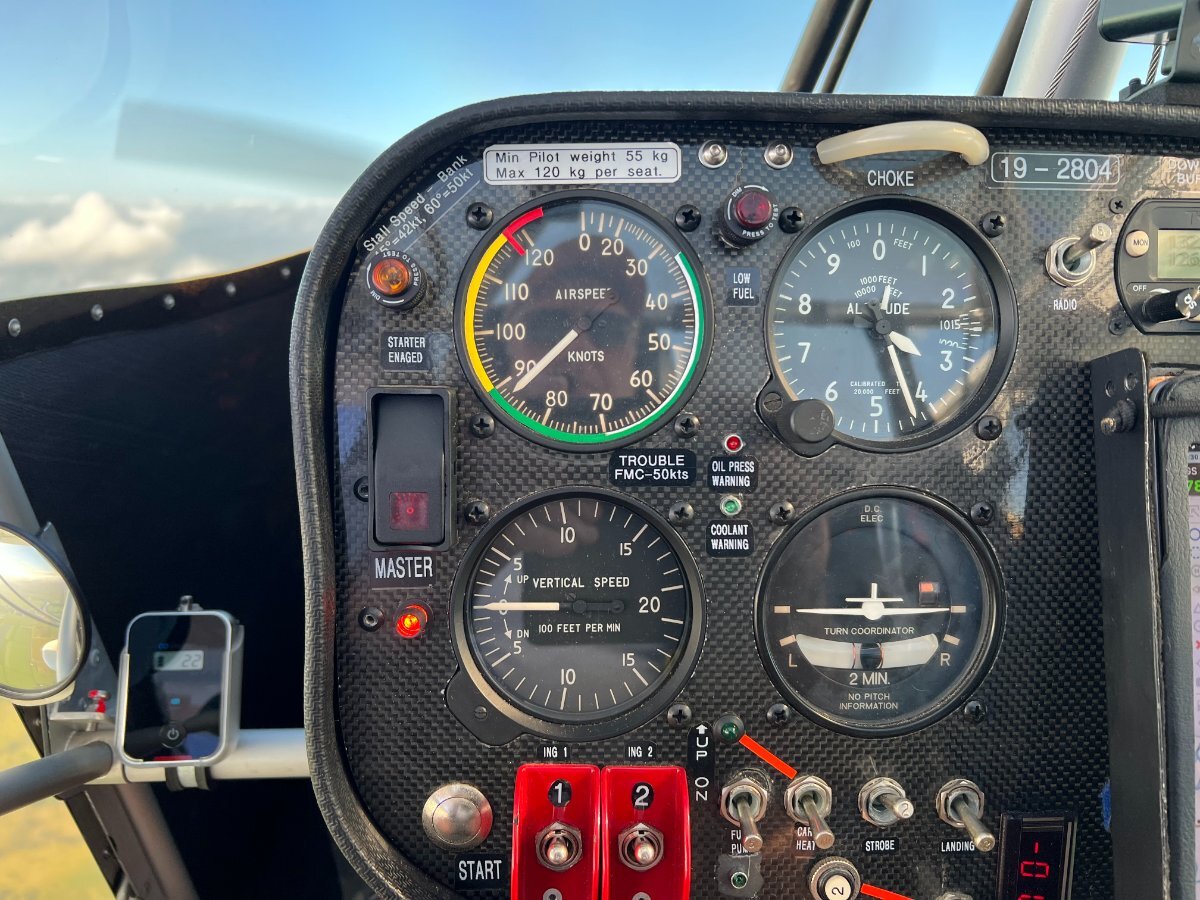

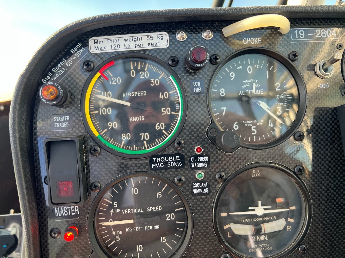

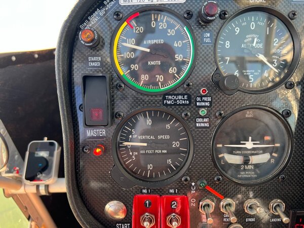

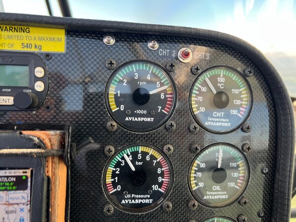

Did another hour today; 2nd session and third flight with the E-Prop.  Pitched decreased to 24.5* from 25*.  Turbulent air so had to get above 3,500ft for smooth air.   Happy with results.  WOT s&l 5,450rpm 108Kts.   4,000rpm - 75kts, 4,200rpm - 80kts, 4,400rpm 85kts, 4,800rpm - 90kts, 5,100 - 100kts,   I'll look at 4,800 to 5,000rpm for cruise of 90 to 95kts.  Have a two hour trip end of month to Old Station so will start seeing the actual performance including fuel usage etc and do a few local trips before hand.

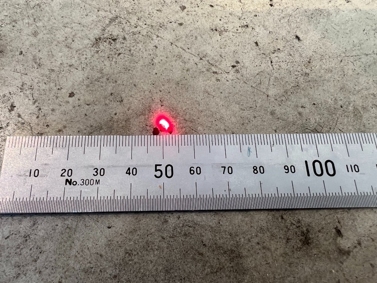

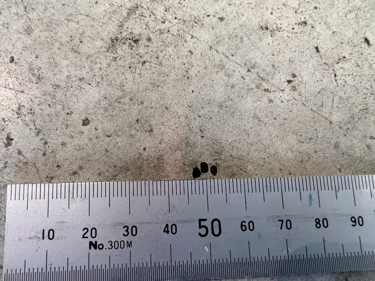

For info; after adjusting the pitch I check and make final adjustment with my laser pointer pen fitted on my pitch adjuster.  The distance between the dots is means that pitch is within 0.09 (less than 0.1 and the manual asks for within maximum 0.3 degree so close enough for the second pitch adjustment trail.  All good now at 24.5 degrees so will fly this for a while.
Edited by Blueadventures
