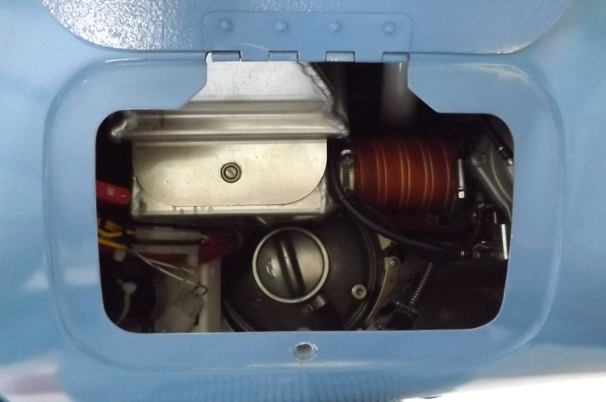

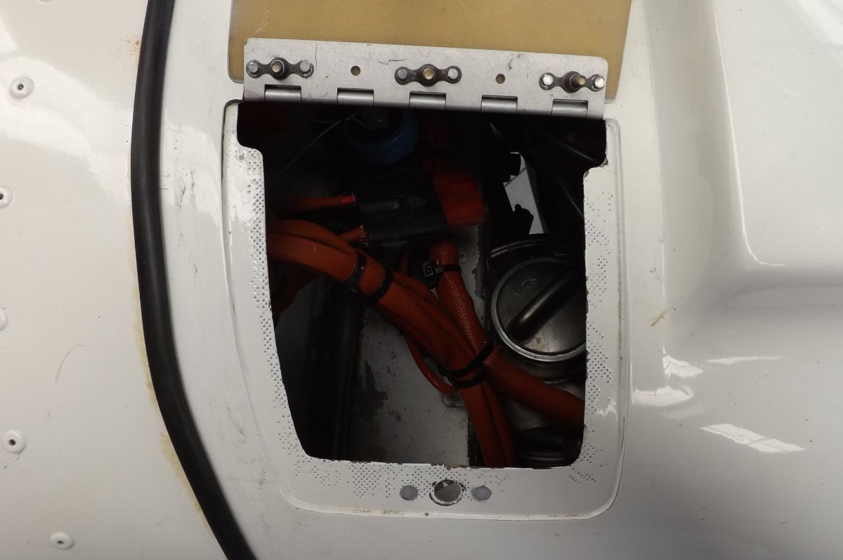

IBob Posted February 18, 2023 Posted February 18, 2023 Here ya go Marty. This is on the S, 190mm wide x 105mm deep (IF the recessed lip was carried all the way round. Since it's not, 115mm deep at centre). Doesn't need to be that wide, I'd guess it's supplied like that to cater for different engines/mounts. 2 2

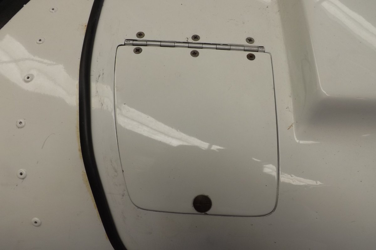

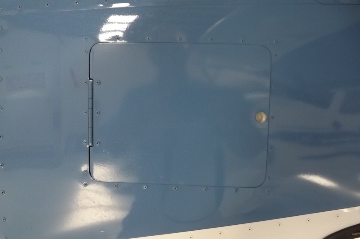

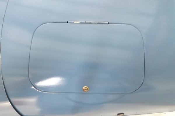

IBob Posted February 18, 2023 Posted February 18, 2023 And here is a very tidy DIY hatch on a VG, probably a better fit for you. 100mm wide at the midpoint of the sides, 125 from hinge to fastener side. (These are the dimensions of the final hole: note this also has an inner lip, so the cover sits down flush). 1

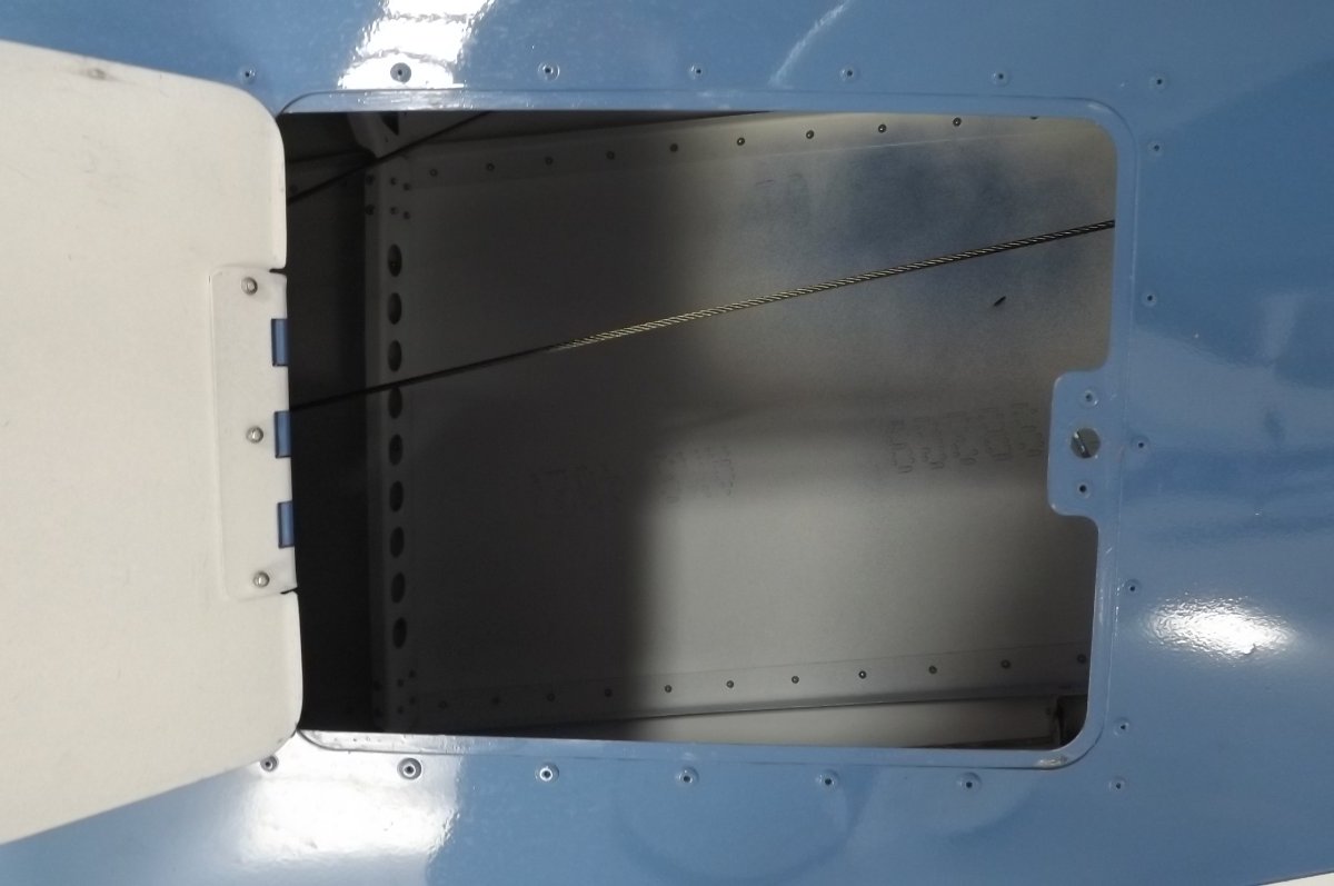

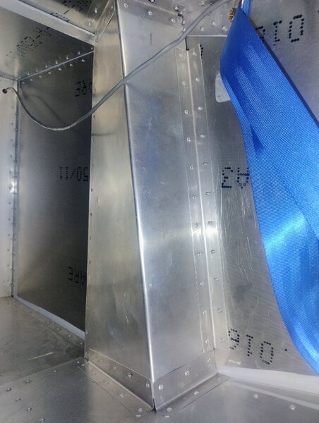

IBob Posted February 18, 2023 Posted February 18, 2023 FWIW, for hatches in the 6061 panel, they supply a doubler with a slightly smaller hole, which rivets inside the skin. This stiffens the edges of the skin, and provides a lip so the cover sits flush to the skin. This is the rear fuselage side hatch, gives access to control cables and used to be where the battery was, you can see the doubler: 1

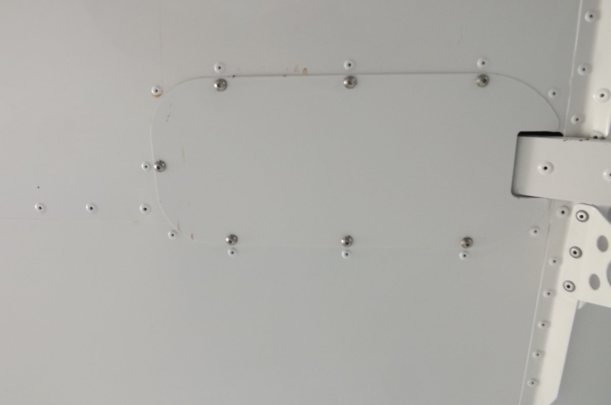

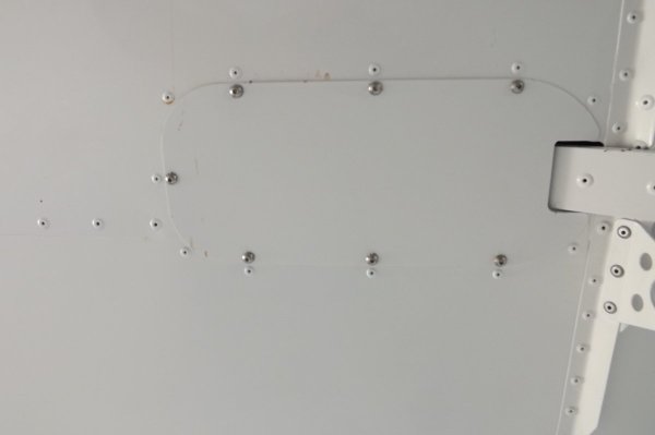

IBob Posted February 18, 2023 Posted February 18, 2023 (edited) And here are the underwing inspection hatches. Again they have a doubler riveted inside. In this case there is no lip and the cover sits on, rather than flush to, the skin, secured by rivnuts and hex head screws. Edited February 18, 2023 by IBob 1

Marty_d Posted February 18, 2023 Author Posted February 18, 2023 9 hours ago, IBob said: And here is a very tidy DIY hatch on a VG, probably a better fit for you. 100mm wide at the midpoint of the sides, 125 from hinge to fastener side. (These are the dimensions of the final hole: note this also has an inner lip, so the cover sits down flush). Thanks Bob! And everyone else too. Yes I have to epoxy in a recess which is going to be difficult. Interesting how they've used nut plates on the hinge as well in that one. 1

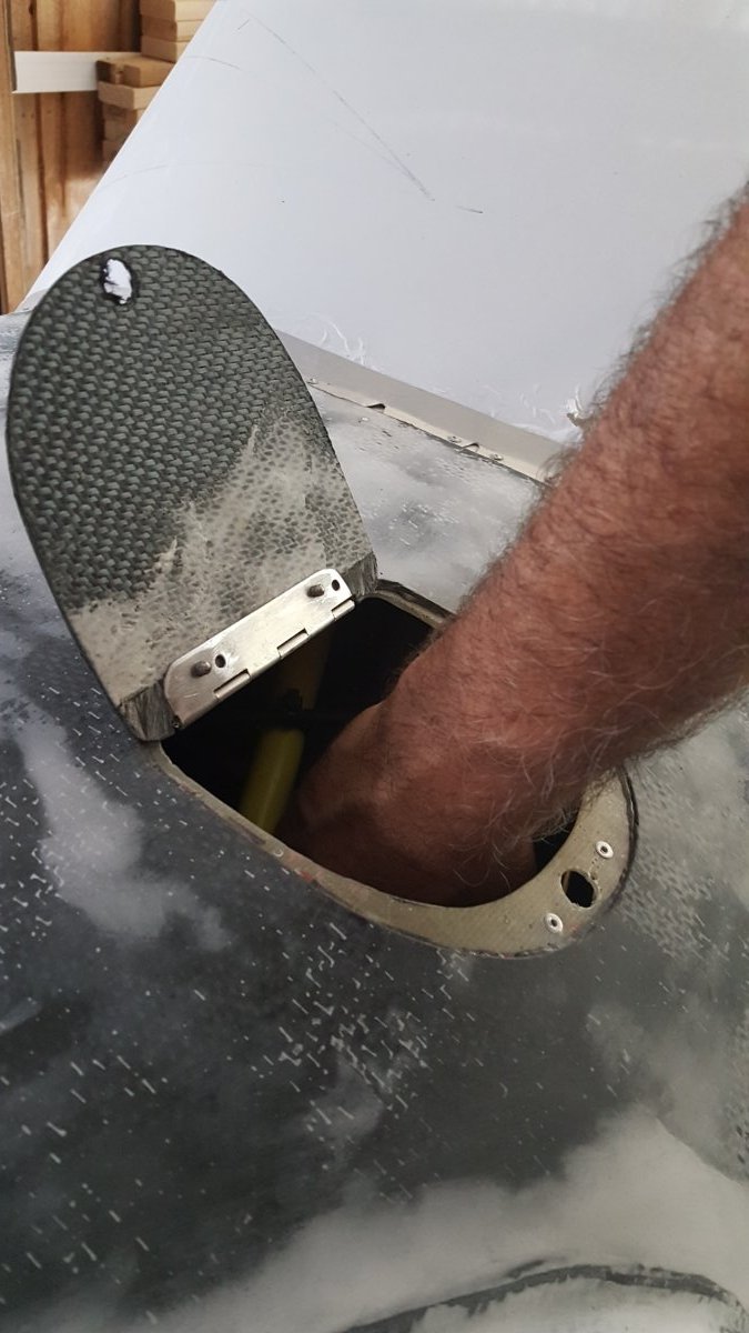

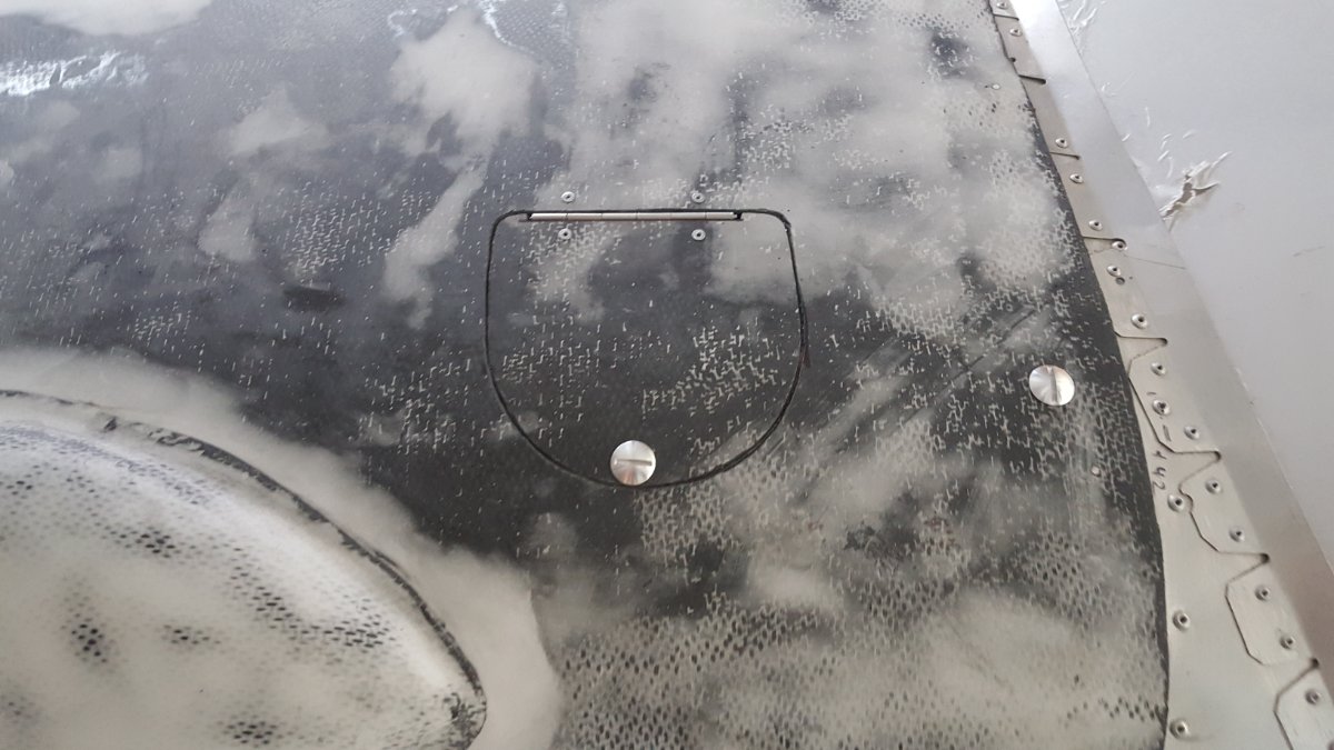

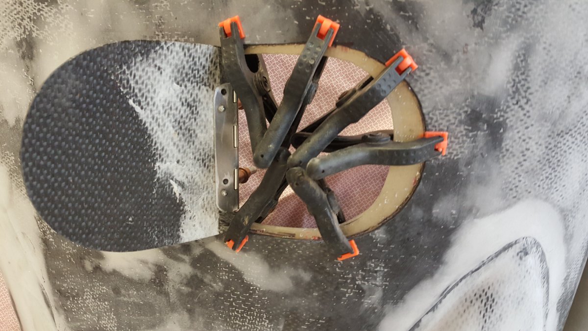

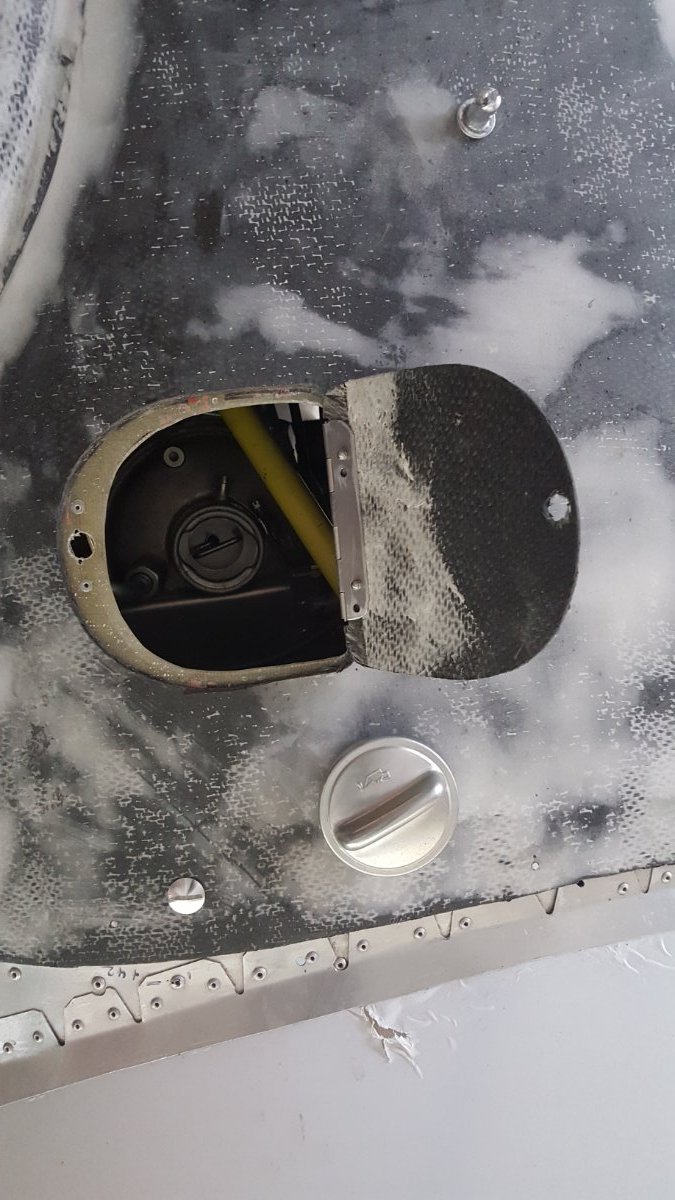

Marty_d Posted February 26, 2023 Author Posted February 26, 2023 Well, I got the oil hatch done. Decided to go with the DZUS because otherwise I'd have to carry a different screwdriver for the camloc. Besides, I had the spare DZUS. I made the recessed bit out of a section of a "first attempt" fibreglass cowl that the owner of the moulds had given me, so it matched the curvature. Epoxied that to the underside of my cowl and then hinged the door. Size seems about right for my arm, especially as a bit of wrestling is needed with the oil tank cap - are they always this tight?? 4
IBob Posted February 26, 2023 Posted February 26, 2023 Very neat, Marty. You must be well pleased with that! Yep the cap is a bit stiff, but probably less so once you get a bit of oil on the seal. 2

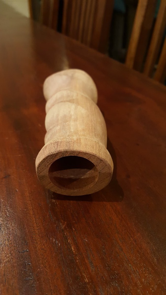

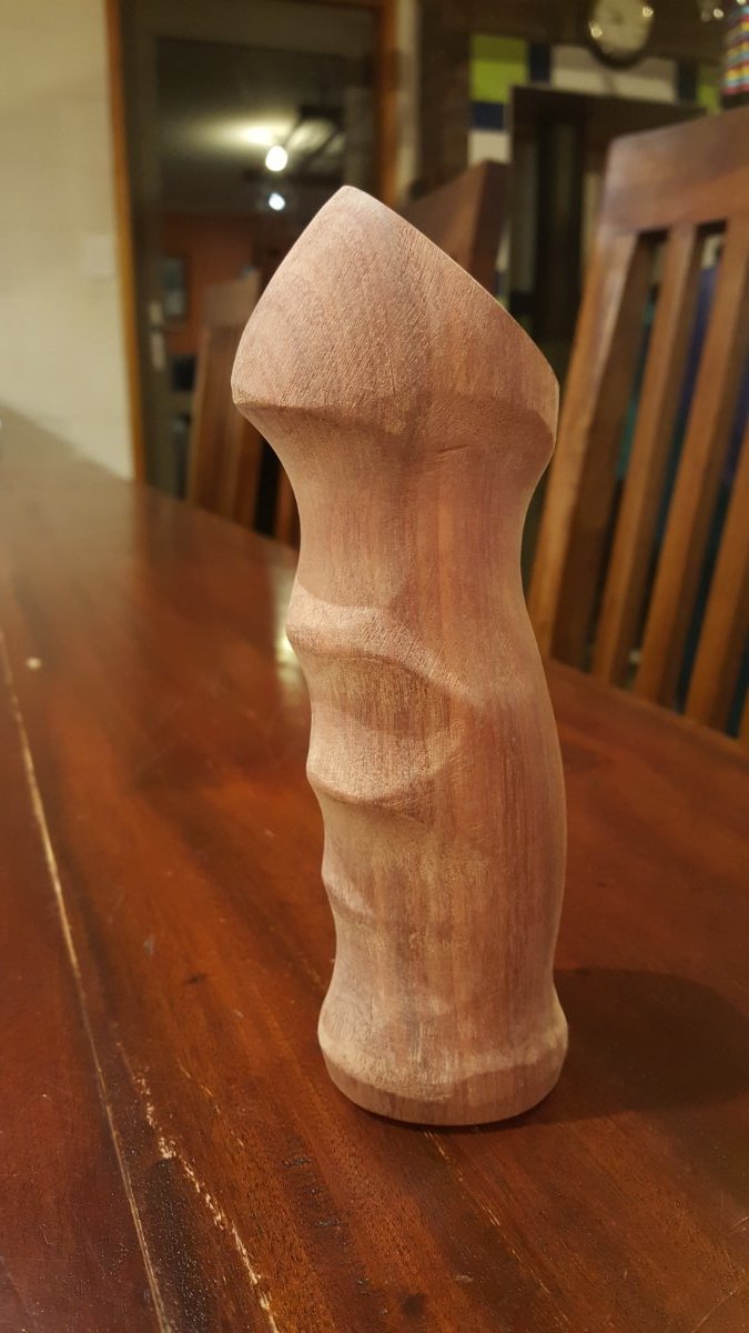

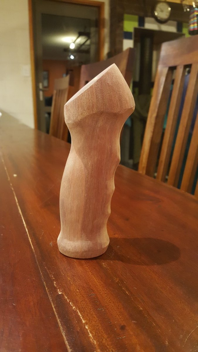

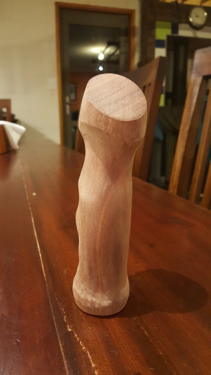

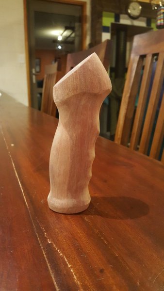

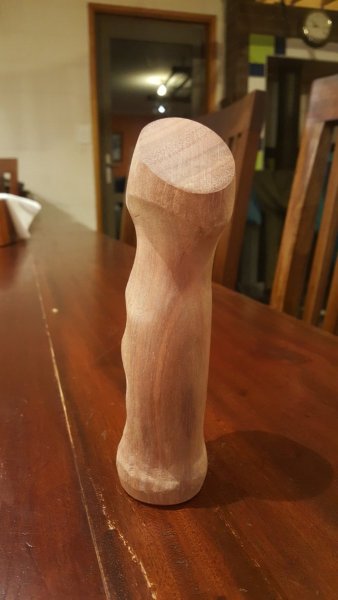

Marty_d Posted April 30, 2023 Author Posted April 30, 2023 Again I have to thank Peter, he spent most of Saturday working on my wiring. At the end of the day most of the instruments were connected, and I got to turn the ignition switch and see the trim indicator, volt meter and hour meter on the tacho (0.0) light up. Then one more turn and the Rotax turned over (very briefly!) Today I spent a few hours making a wooden grip for the Y-stick (trouble is, now I'll have to make another one!) I used a bit of scrap hardwood I found in the shed, no idea what it is but I think it'll have a nice reddish shade when I varnish it. Fits my hand, but makes my wife laugh every time she sees it, for some reason... 2

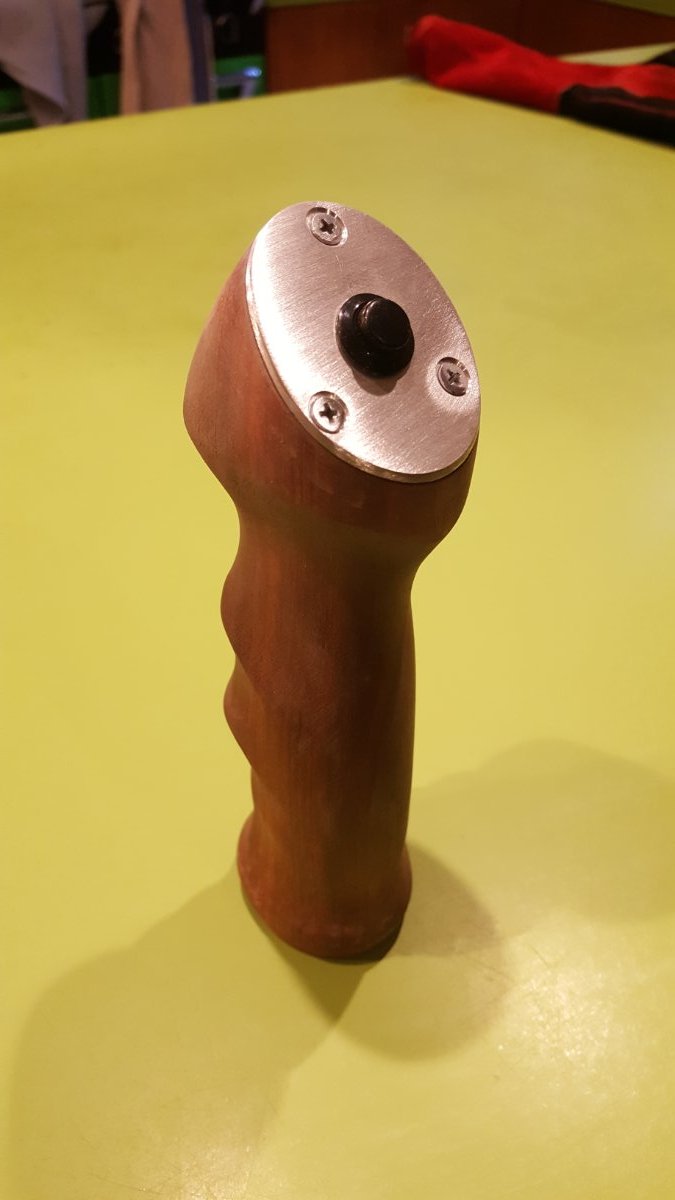

Marty_d Posted May 7, 2023 Author Posted May 7, 2023 After a couple of false starts I installed the PTT on the dildo, sorry, stick grip. Tried insetting a smaller aluminium disk into the wood but it didn't work too well, so went with fully covering the end. I think it works. 6 2
