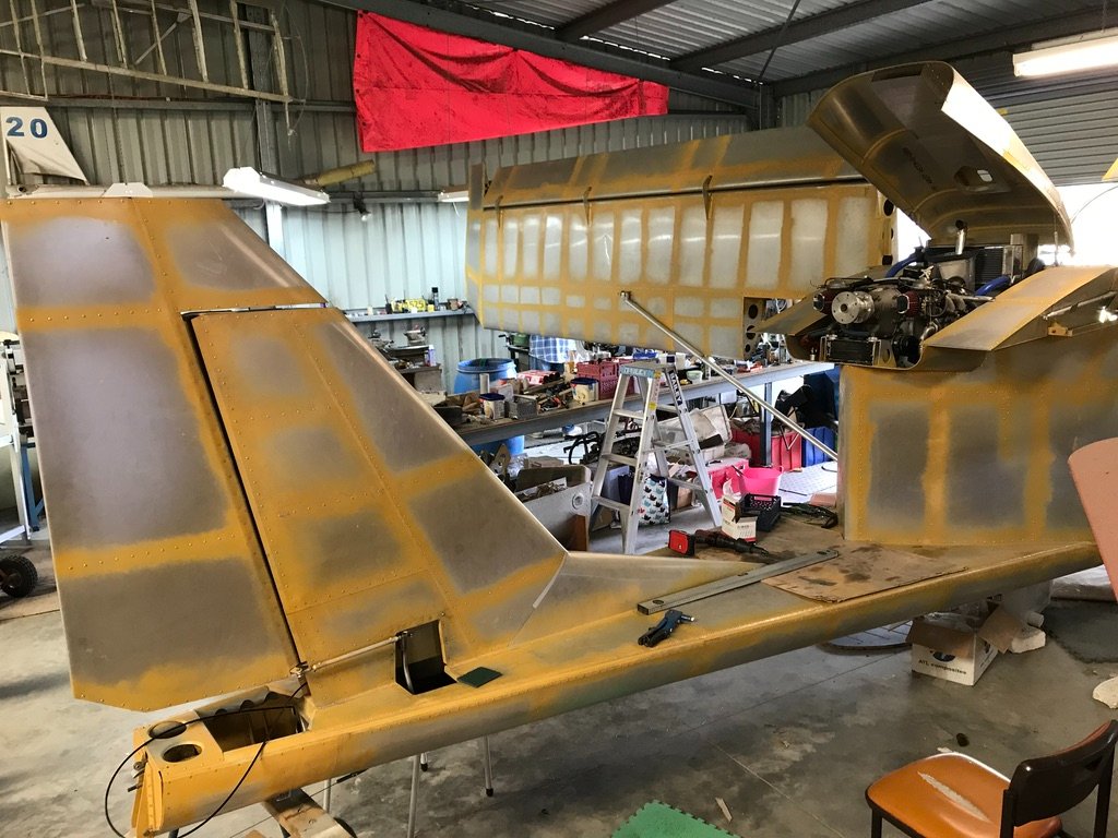

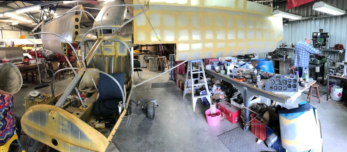

Just happened on this thread, so the actual layout of the plane baffles me.
More pix please, or even a video.
I'm not sure if these make it much clearer than the pics already posted.  They're just a couple of clips taken last year of Pylon500 at work on some other of his projects. However, the subject of this thread (his original design for planet47) can also be seen.  In the first shot we pan past it from the front. In the second clip, it can be seen from the rear in the background as Pylon tells me about the almost finished wings of that other project on-the-go.

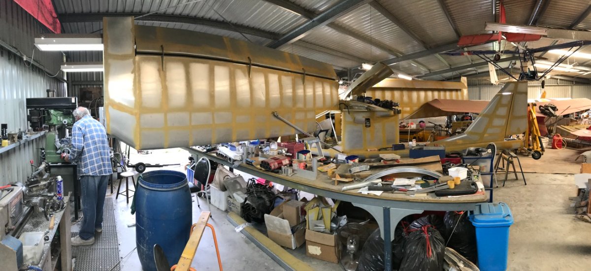

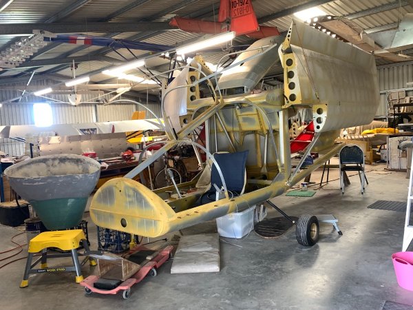

For another perspective on the weekend's activity, here's Planet's airplane-to-be with its speed brakes deployed.    ;- )
For a demonstration of the folding concept here's a video of the aircraft's designer - our Pylon500 - showing how it's done.
(Meanwhile, planet47 - who's happy to remain anonymous - took a break from riveting this weekend to polish up the nose cone.)
And, oh yeah, it does have an engine.

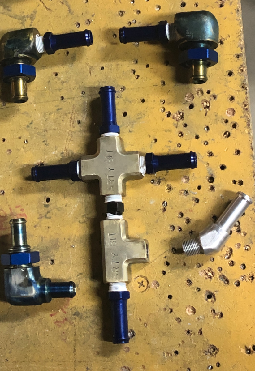

I used to remember the old two stroke diaphragm pumps could pull fuel up about two feet (at least), in our situation the tanks are about level with the carbi's (they would be above during climb), so I'm assuming the 912 mechanical pump should maintain pressure to the carbi's as a 'level' system.
My biggest concern was exposing the fuel pickups in the tanks when the wings are folded, so I've got a slightly more complex fuel system than just a line to the engine.
Tank fuel will come into the side tubes and will have to flow down to the T branch where it will then feed to the engine. the lower tube will go to a below fuselage drain point, and the top tube goes to a 'purge' pump, that will scavenge all bubbles in the lines and pump it back to one of the tanks.
That's the theory anyway, was initially going to use a header tank, but figured the lines were enough volume to do the job.

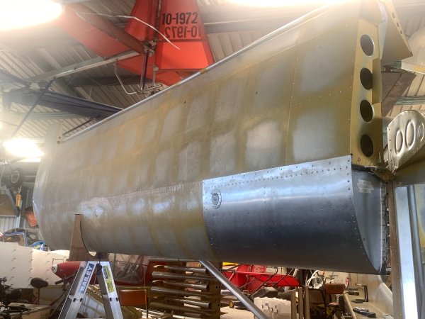

On 26/01/2025 at 8:11 PM, planet47 said:
……..and a few more rivets later
Wow, great work. I'd like to have gone down this path twenty or thirty years ago. I started motor body building in WA just over forty years ago when I had stamina like you guys. This type of project would have been right up my alley. I love your work.
