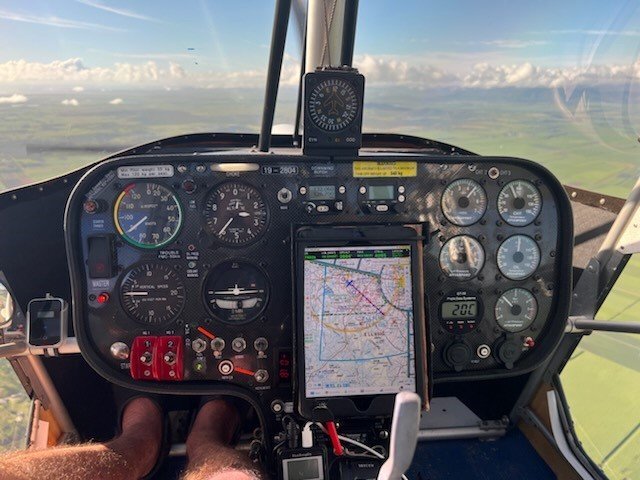

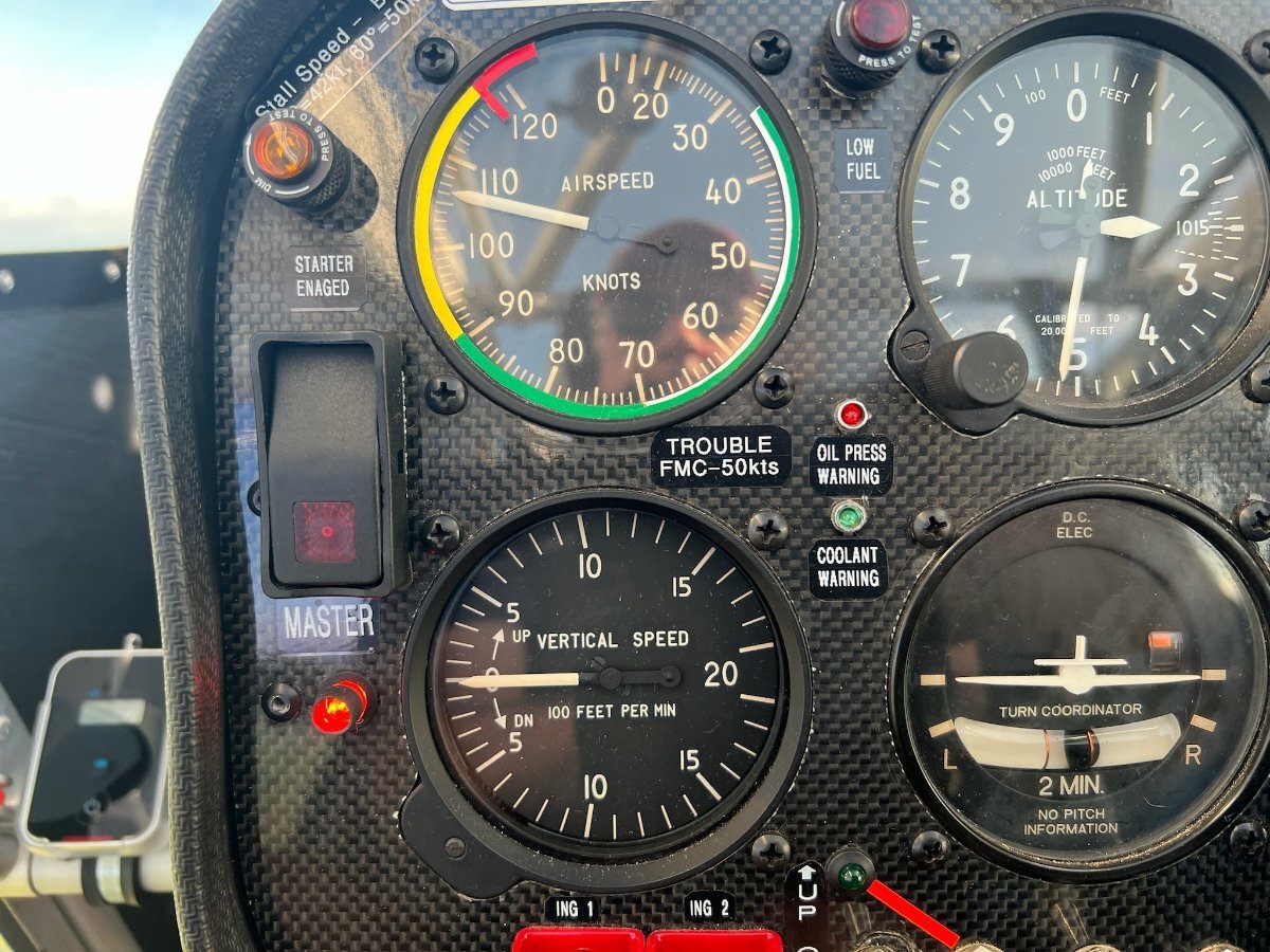

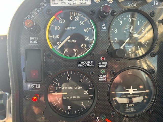

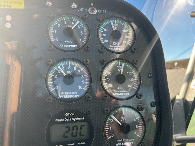

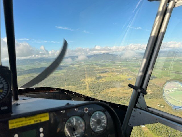

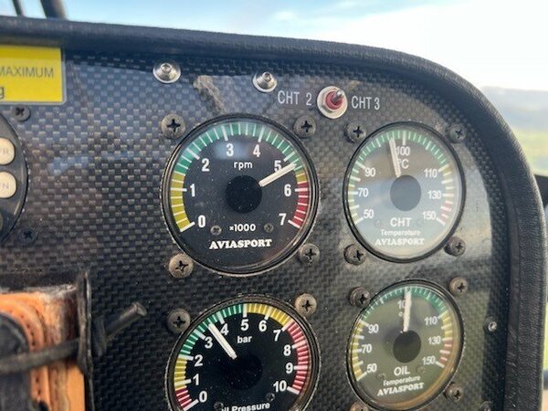

Images of E-prop flight on 20 April 2022 also my rat catching hangar snake resting on the door panel.  Image of 4,600rpm and 87 kts and 5,250 rpm and ASI on its way to 108 kts (reading lower due to when image taken. Needed to adjust rudder bungee as I needed to input right rudder a bit, slip ball to right a little.

With data from your instruments and assuming air temp of 25°C yields a true airspeed of 115knots at 5250rpm. That is super impressive for that style of aircraft.
Hi Thruster88
They are a nice bird to fly and I enjoy it and can handle it well.  (I was crap at landing my previous Skyfox taildragger and have no issues in Drifters.)
Back to speed; I pretty much work off IAS and GS on the ipad and usually fly under 4,500 and never really been over 7,500.  (Been higher in my Blanik L131-A glider in the past.)
I'll work the approximate TAS calculations as never doing trips longer than 4 hours legs (not far at a 90 plus cruise speed).
A memory aide is plus 3 kts every 1,000 feet I'm at above 3,000 ft.   (Bit like the gliding rough rule for temperature drop per 1,000 ft.)
At the end if the day an happy doing between 0.135 and 0.170 MACH:)
WE have crap weather up here set in until end of next week at least.  So will get to the hangar and decrease the pitch, adjust the rudder trim bungee and do a new w&b (although not much difference in weight of the DUC but good for loading the next trip away.  Cheers

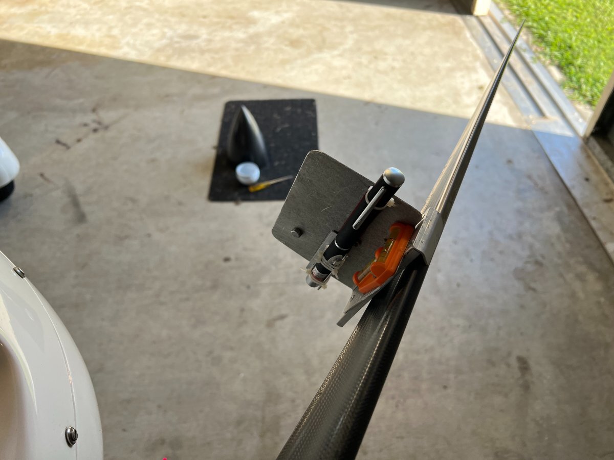

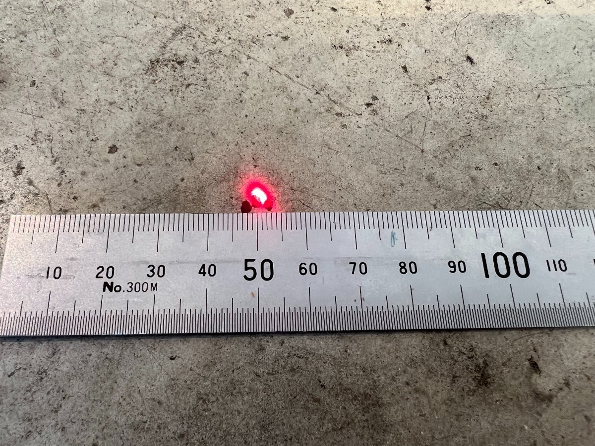

For info; after adjusting the E-prop and any other prop pitch I check and make final adjustment with my laser pointer pen fitted on my pitch adjuster.  The distance between the dots means that pitch is within 0.09 (less than 0.1 and the manual asks for within maximum 0.3 degree so close enough for the second pitch adjustment trail.  All good now at 24.5 degrees so will fly this for a while.

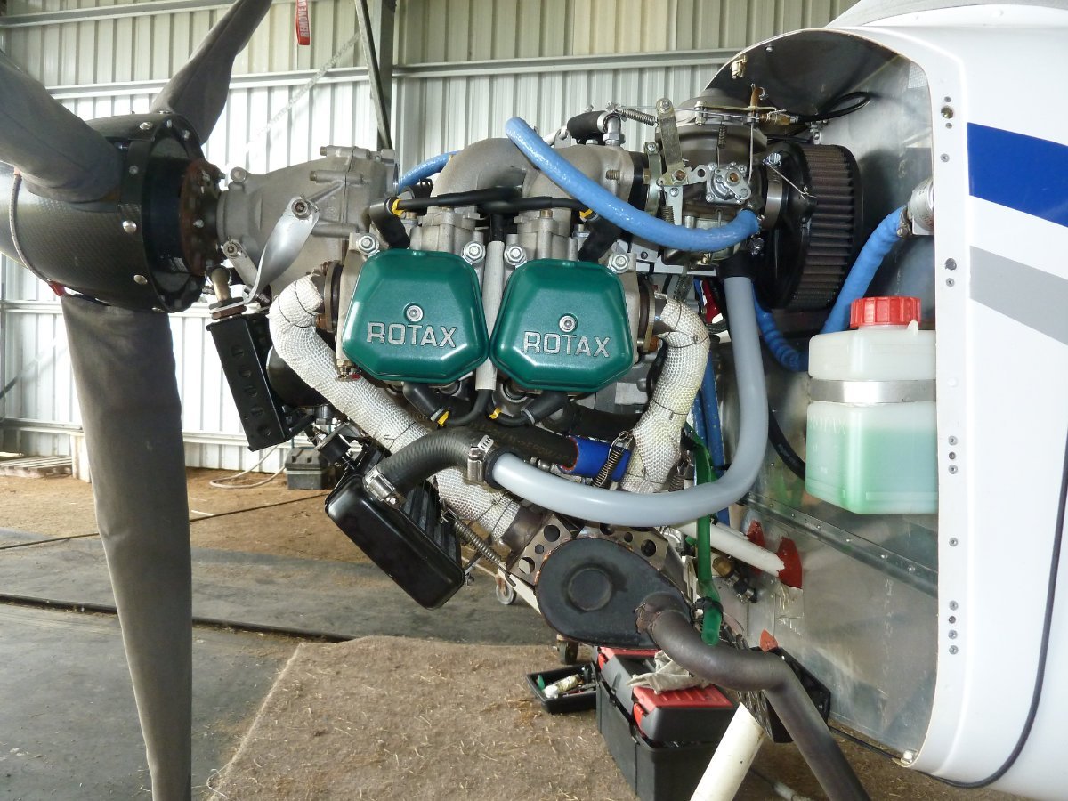

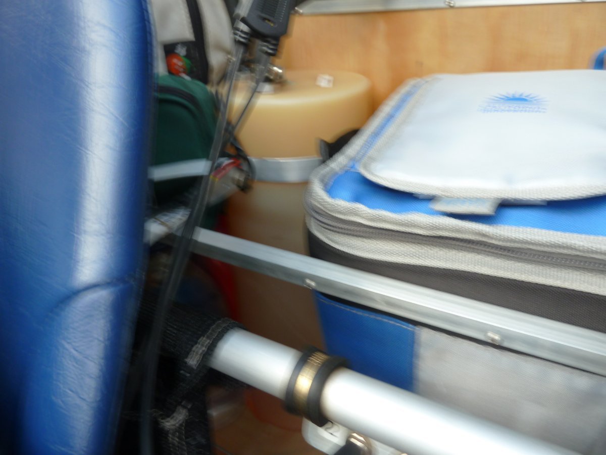

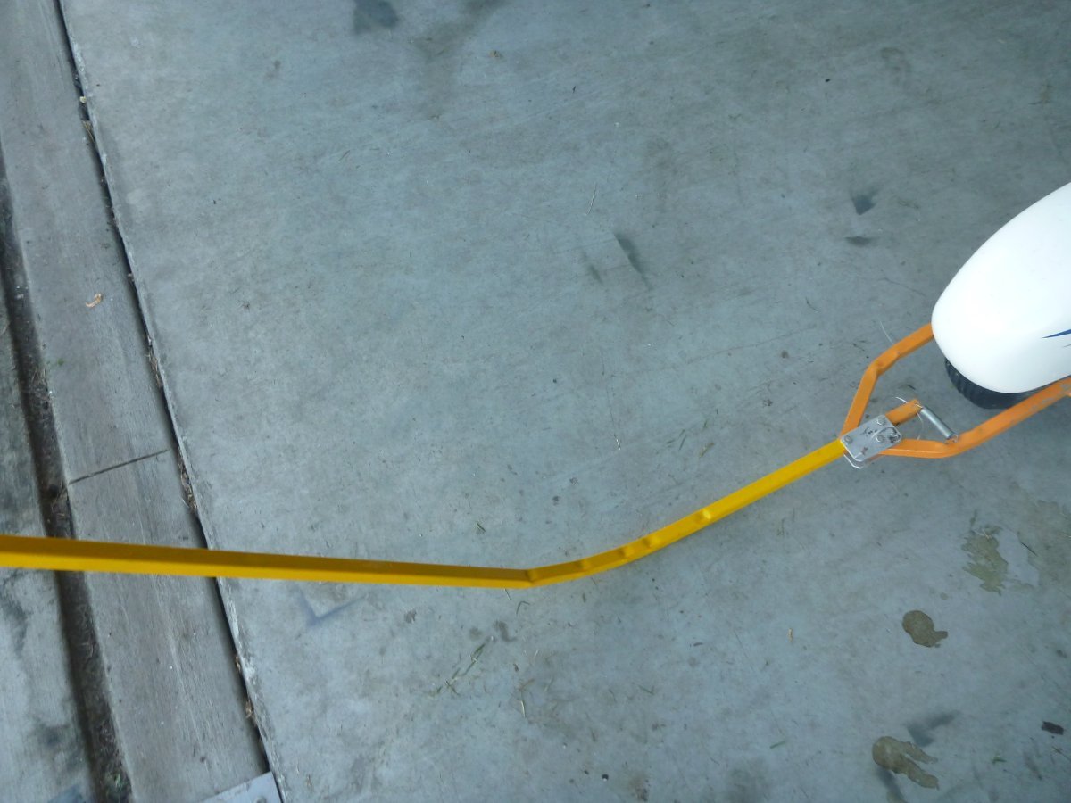

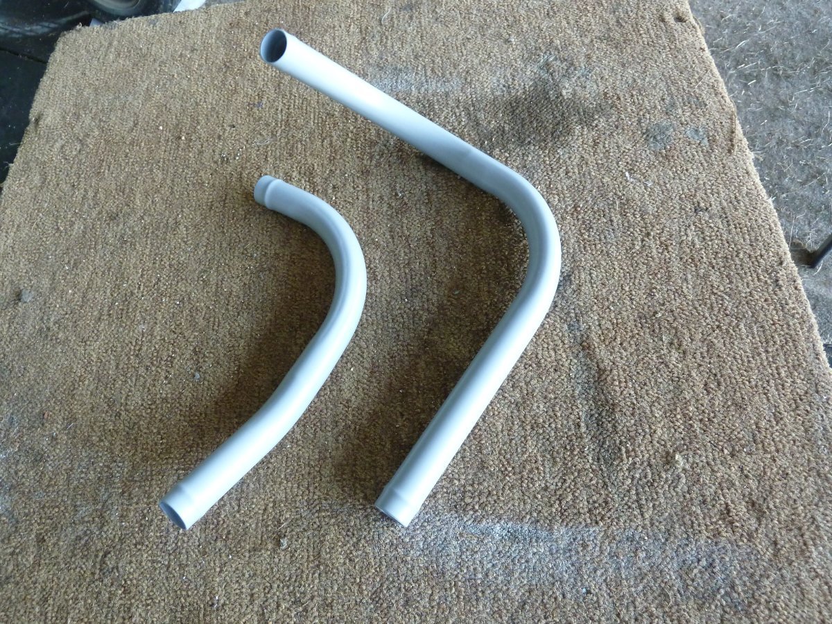

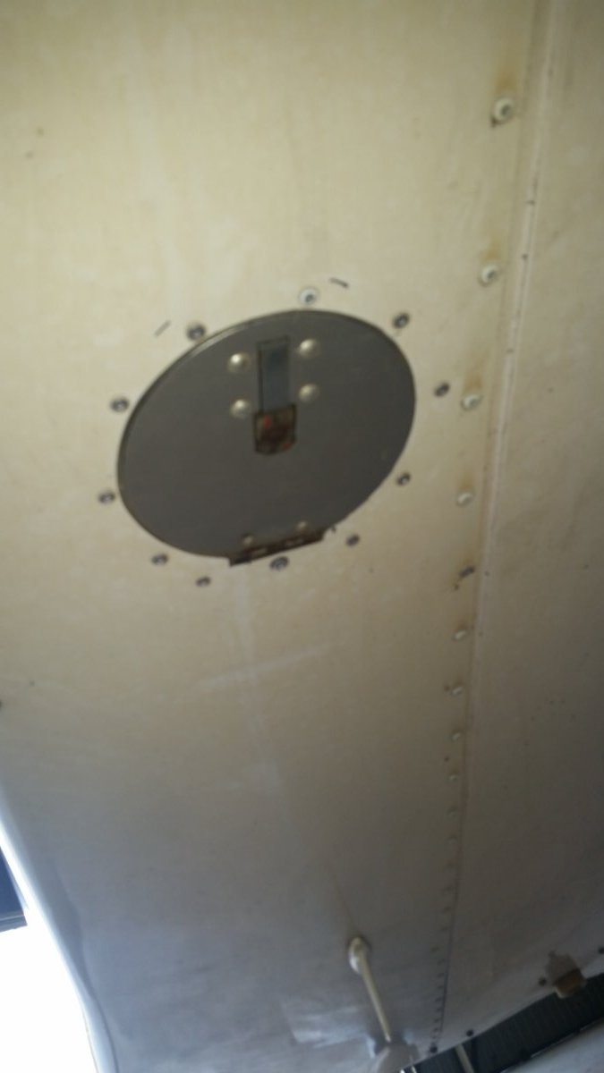

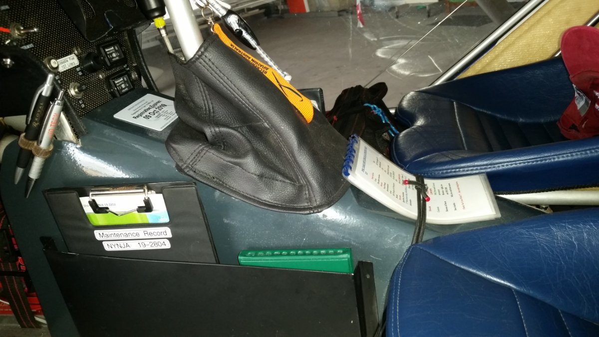

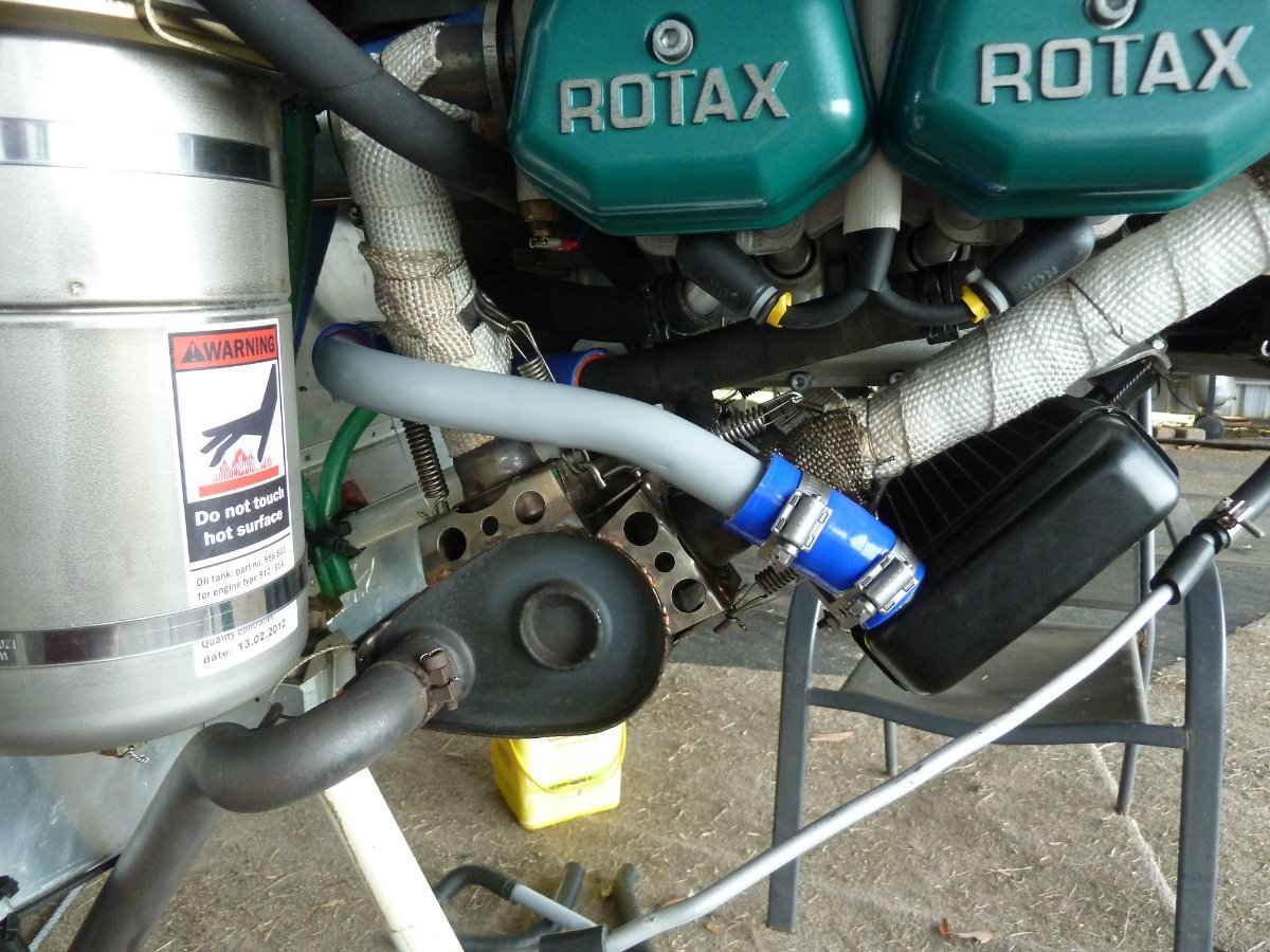

Some assorted images of bits of my build.

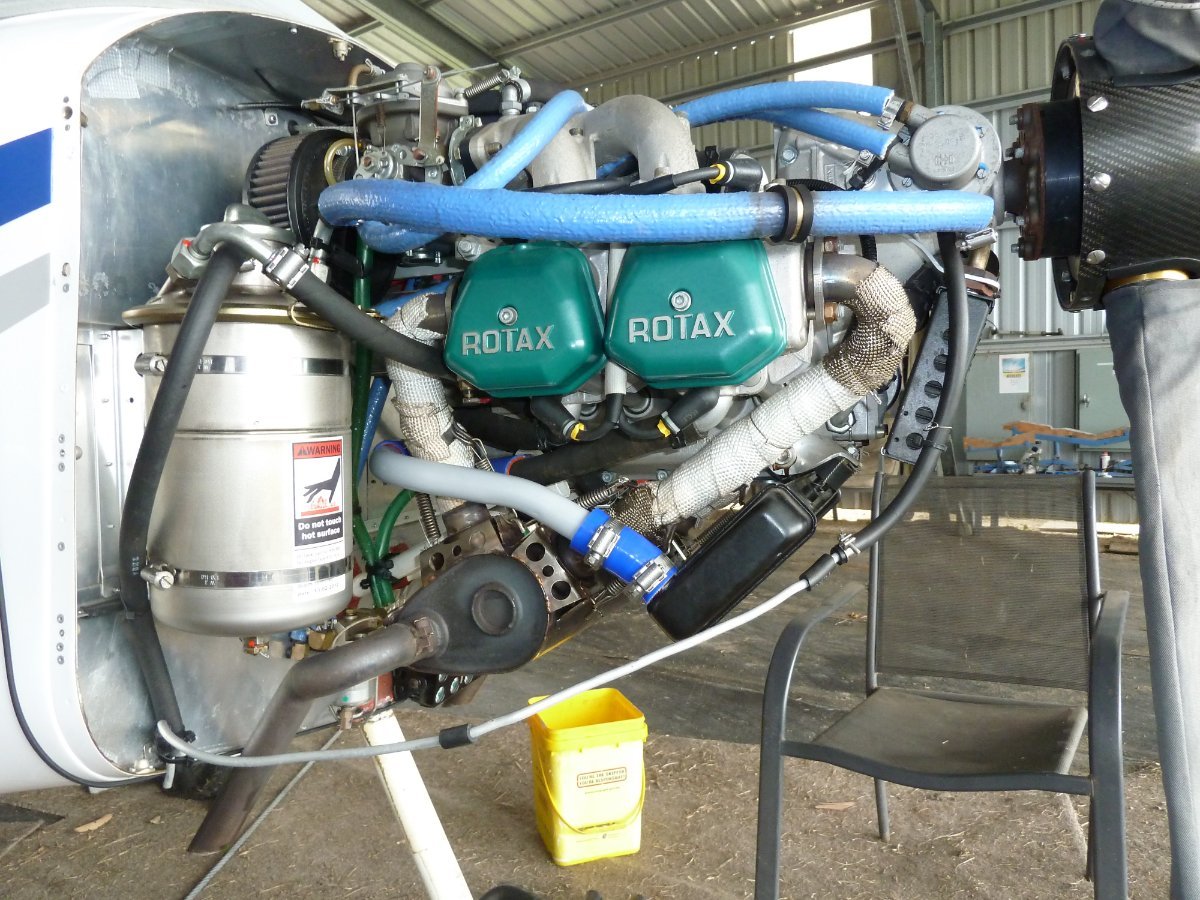

Grey coloured coolant pipes from Flylight, 2 one each side in alloy
Nose wheel dolly
Parcel box behind seats
document holder beside console both sides
Alloy tube support under door sill

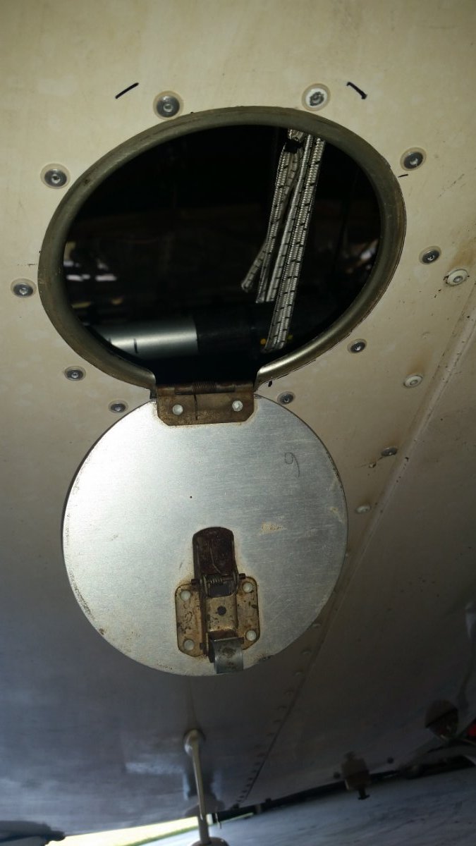

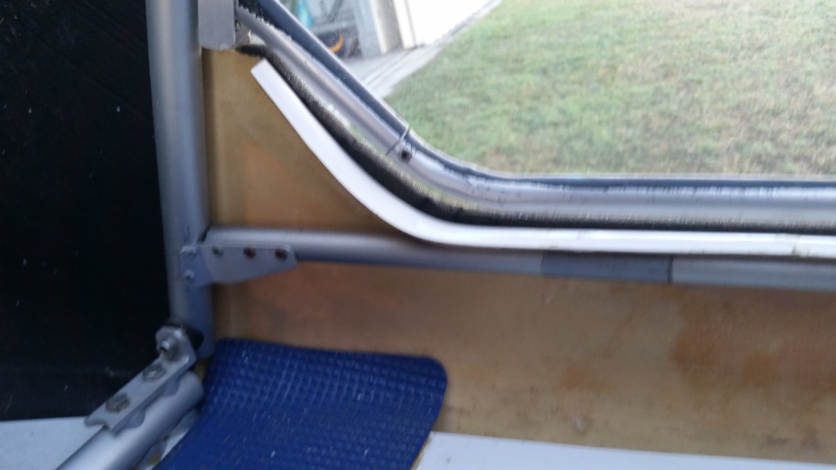

access to rudder bungee, alloy inspection ports from an old Blanik glider wing I had, makes access easy and quick to open and close.
P1020764.thumb.JPG.6b028c943b9a8f4fbac2498042cdfba1.JPG321410479_P1020750-Copy.thumb.JPG.e1094a987cc6916ce7fac4a2c1ca33ca.JPGP1020342.thumb.JPG.199412e7f8cded9033813f0da0531b59.JPGP1010958.thumb.JPG.0d1e89743870dbbbab8186c5a1486702.JPG1493992041_20181104_090820Documentholderandchecklist-Copy.thumb.jpg.96e652ded83e498f89c18cb16c351392.jpg838889396_20180725_083044-Copy.thumb.jpg.f6210d92a49eb95fbd8ae417429465e6.jpg1919903241_20180608_105707-Copy.thumb.jpg.ac22135c67e2b6f0339407f6aff653d0.jpg2087614091_20180608_105656-Copy.thumb.jpg.d23cfac2ac97679156d31e130831ee21.jpg2069008882_P1020770-Copy.thumb.JPG.a6bb8748fd7b2bd23b9da96f48970a3c.JPG
Those alloy water pipes would be perfect for Savannahs..the radiator pipes is crap as std. I have had to make my own solutions on the original and of course on Mabel
Yes, Mark they are a ripper item.  Only discovered their availability in 2017 and bought them straight away.  Would be a good addition to the Savannah parts inventory.
Posted the items for build info to enhance the sites information.
Edited by Blueadventures
16 hours ago, Kyle Communications said:
The rear waterpump outlet do you have a different fitting?..or do you just use a flex pipe to go from the pump to the alu pipe
Silicone hose connection.  The alloy pipe just reduces the length of hose that is a cost saving over time and more rigid over the length. The pipes are bent specific for this location of the radiator although mine is mounted to engine and the usual Nynja fit is to the cowl also like what the Lightwings do; makes more work to remove the lower cowl for access.  Cheers.

Changed out the remaining two radiator hoses to 25mm id silicone elbows and replaced the coolant so a quick 36 minute lap around the block to check the hoses are secure and coolant level correct.  A little bumpy as down at 1,500 feet.  Nice otherwise so now ready for a bit of a trip. Also trying the Gopro on the super wide angle setting.

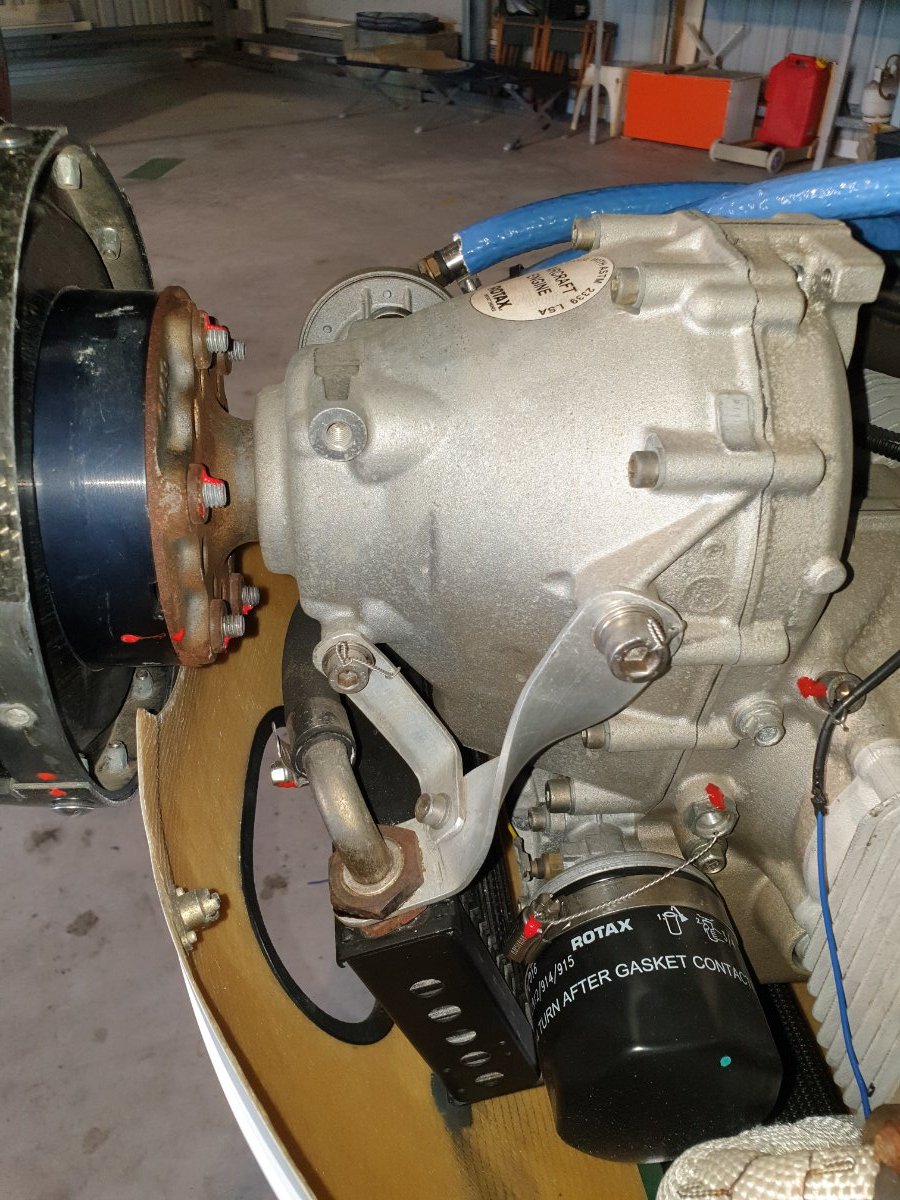

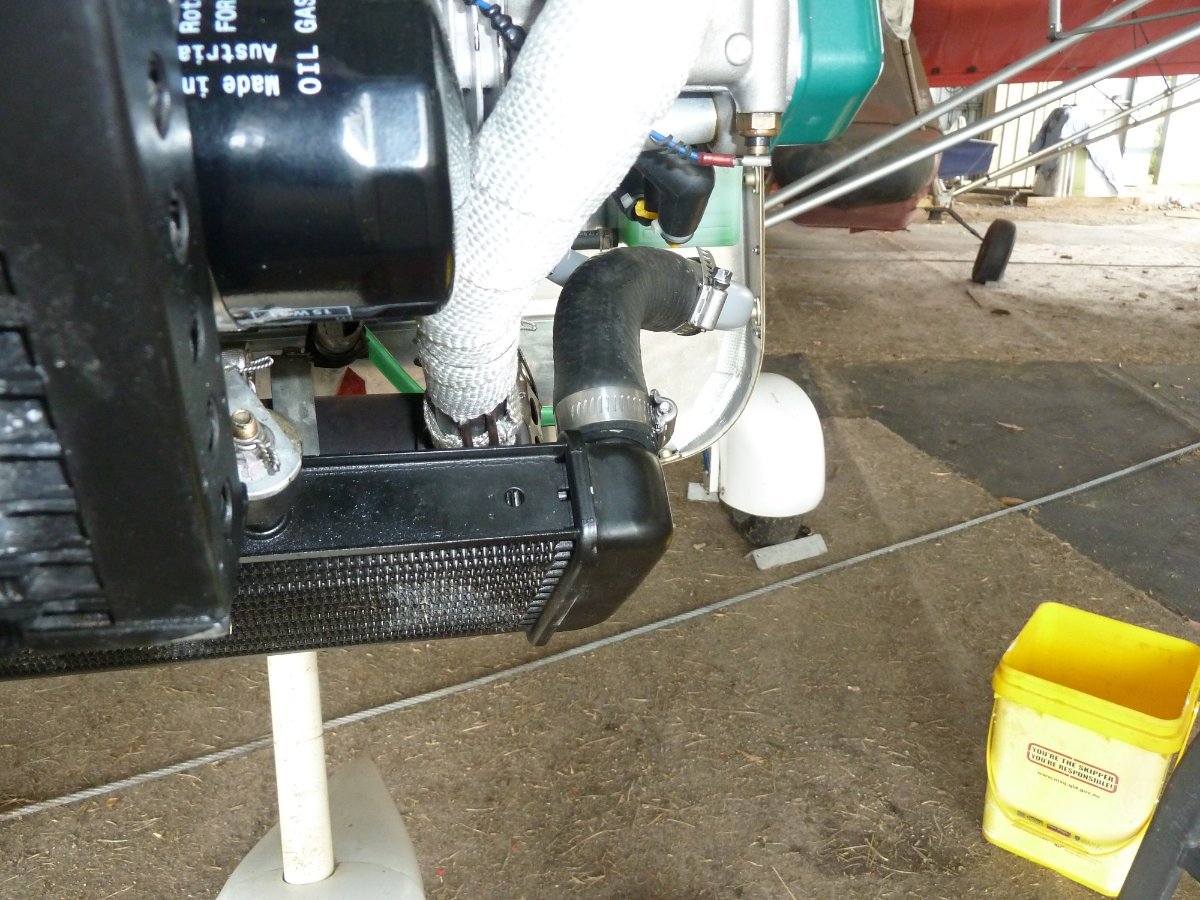

Images of radiator and oil cooler brackets to save having the units attached to the lower cowl as shown in the build manual as it makes removal of lower cowl very easy and quick.  Most are 3mm by 25mm alloy flat bar.   The 90 degree elbows on the oil cooler are Rotax part number 924-5
