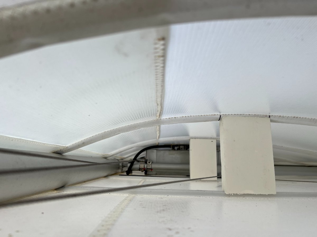

Definitely investing in one of those stick on sun screens to push into the appropriate roof area.

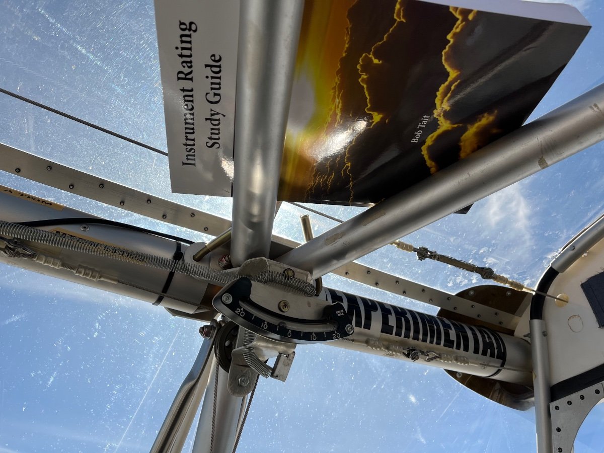

I finally worked out how to work that spring up top. You can lengthen or shorten it to get exactly the right wind correction for course. It’s just in front of Bob Tait wrapped around.
Trimmed out and hands off for a fair portion of the flight. Really enjoyed the trip and meeting John and Guy. Guy is the good looking chap left seat in Nynja.

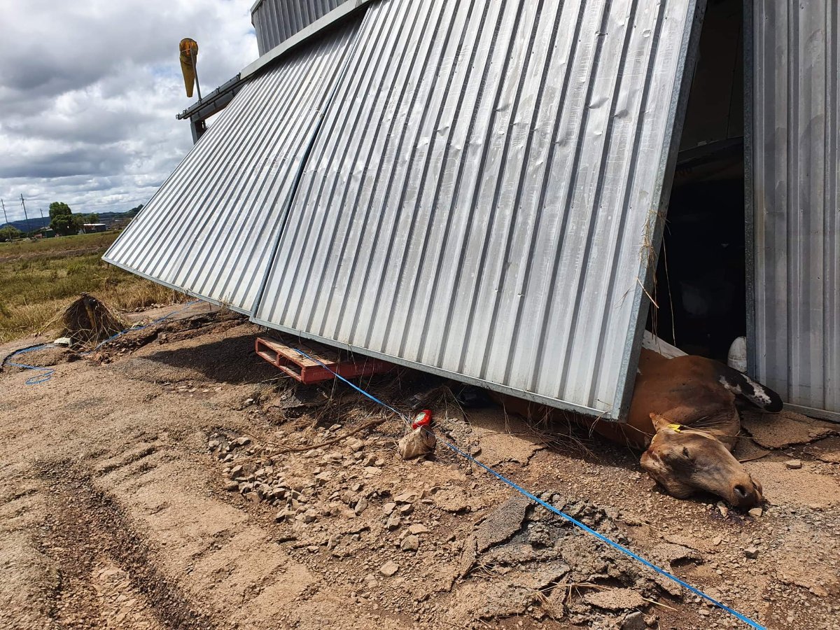

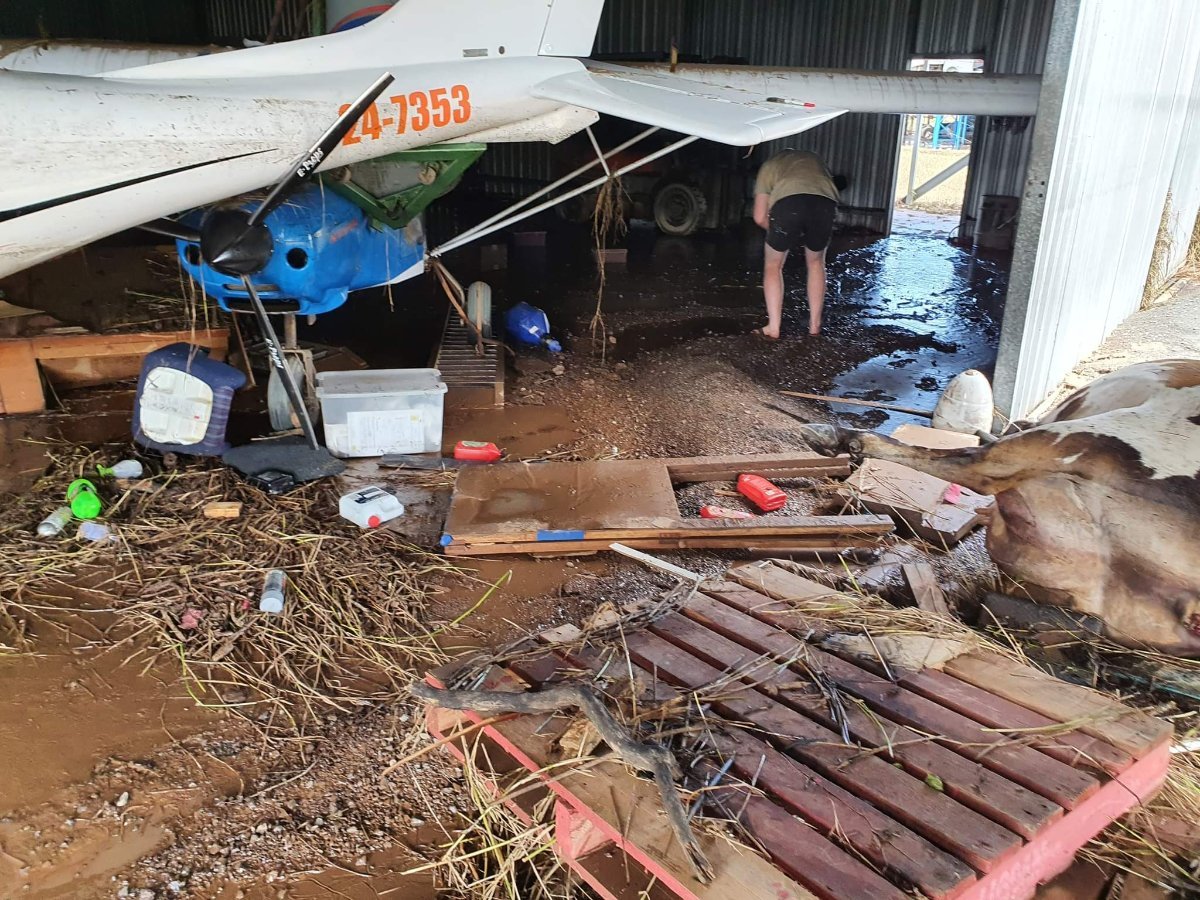

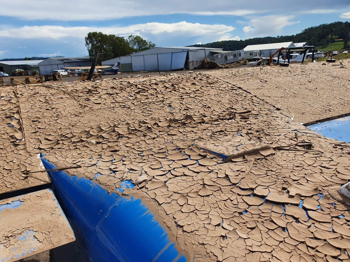

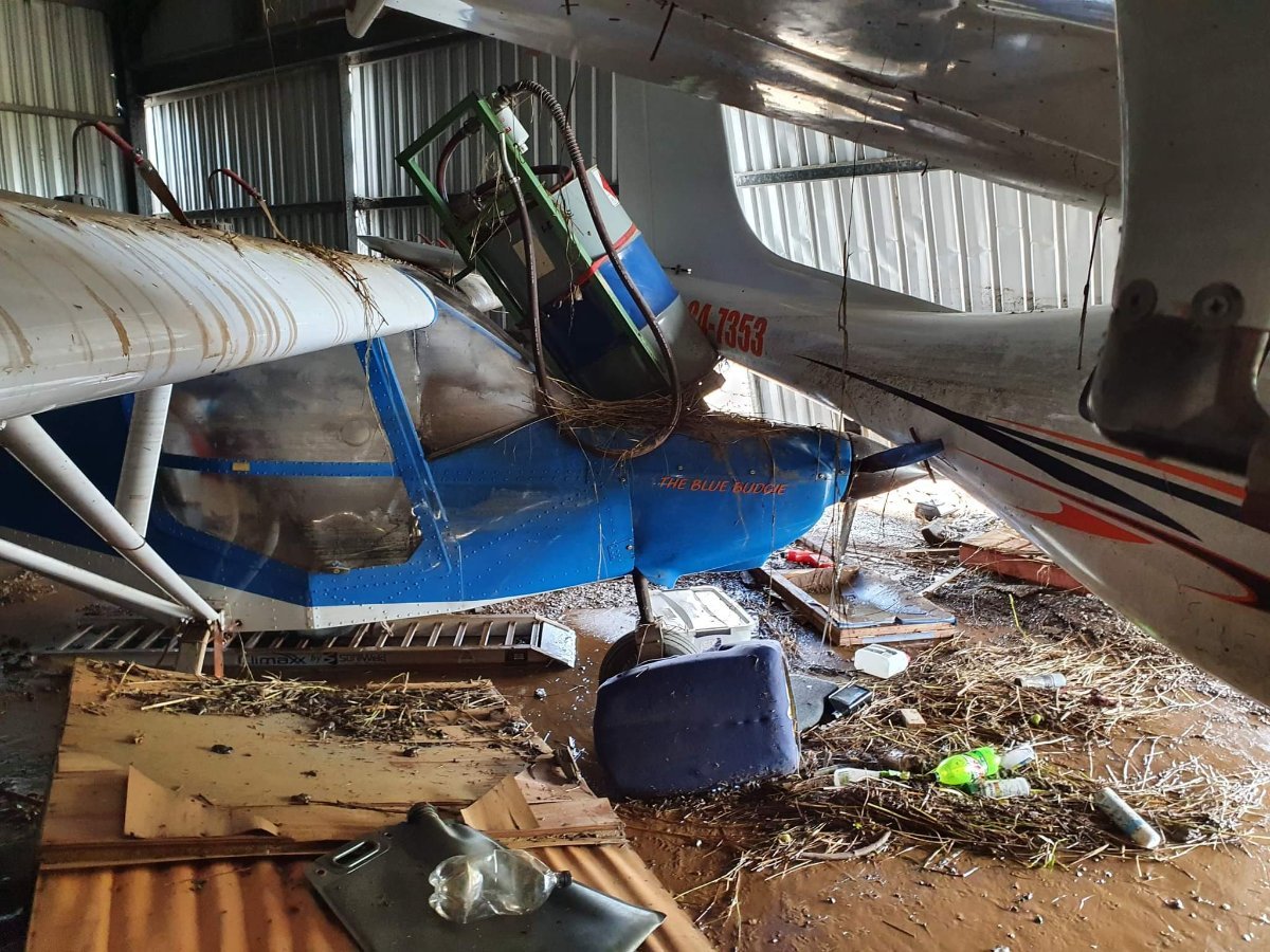

After losing the Blue budgie (Savannah S) to Lismore flood waters (Northern Nsw) and the bottom end of Qld late feb which was devastating on a huge scale.
I've attached some photos of what I saw the first day I was able to get into the hanger and spent the day walking around bewildered and in shock.
I plan on rebuilding the Savannah,  which virtually had very little damage surprisingly, except for the leading wing edge. I'm going to de-laminate the whole leading edge so i can clean out the mud properly and put new skins on. I have all new gauges, wiring harness etc but I reckon it will take me a few yrs to do get her flying again.

That damage is very confronting. You guys have been through an awful lot.

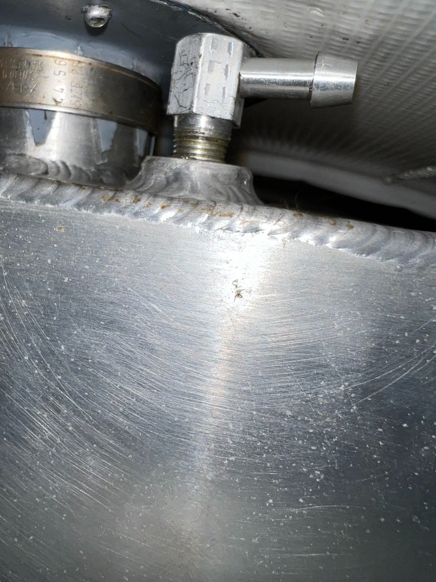

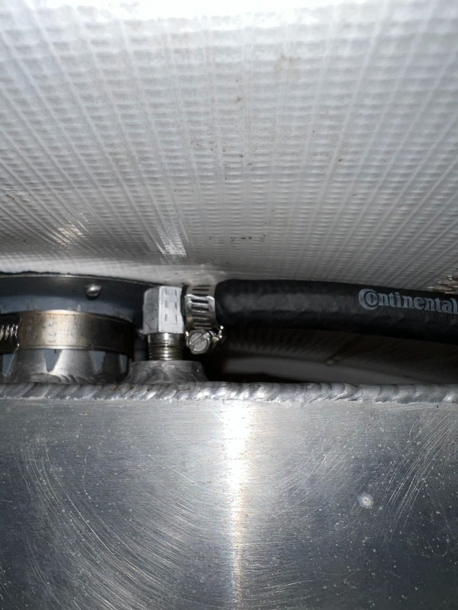

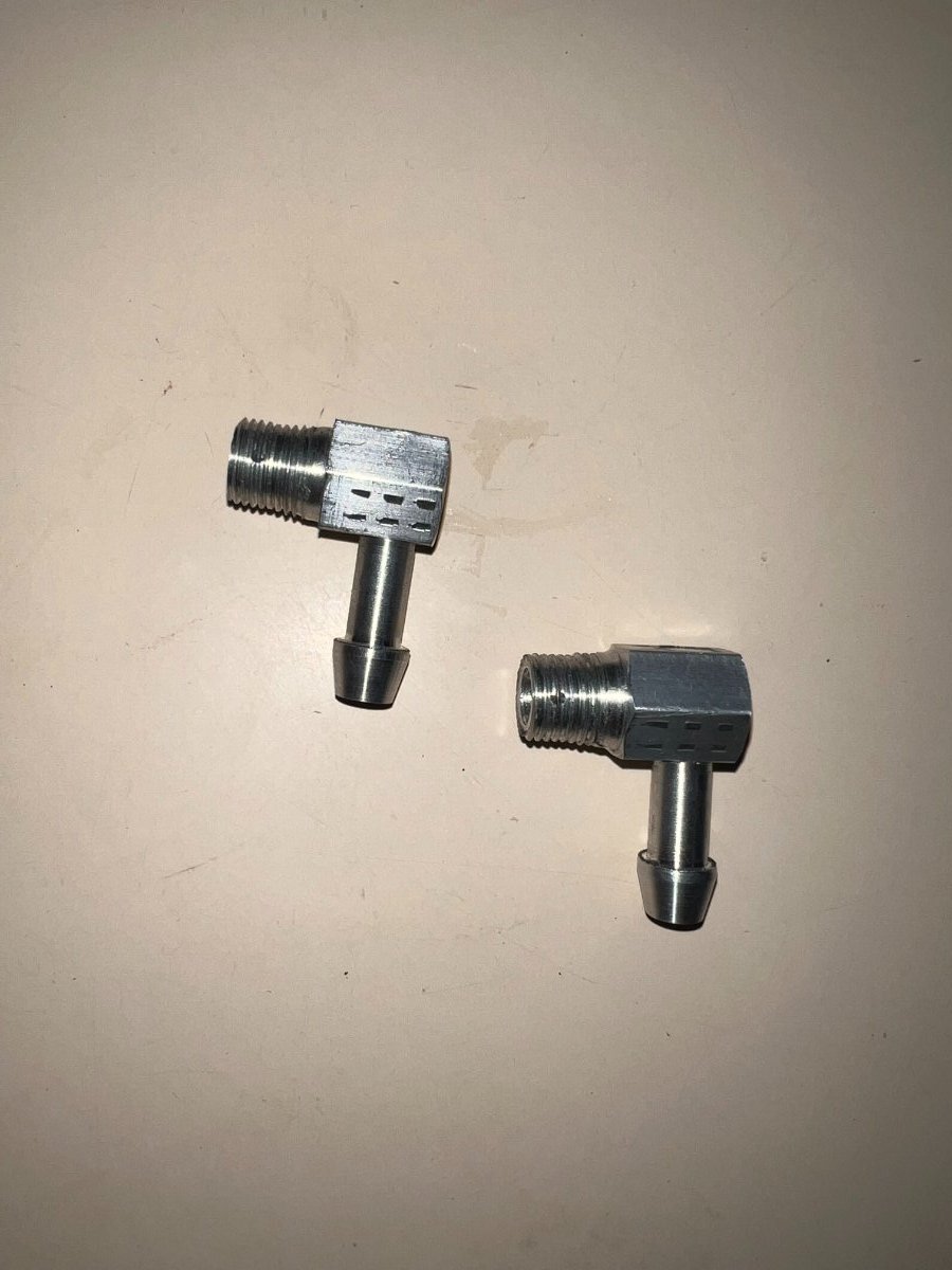

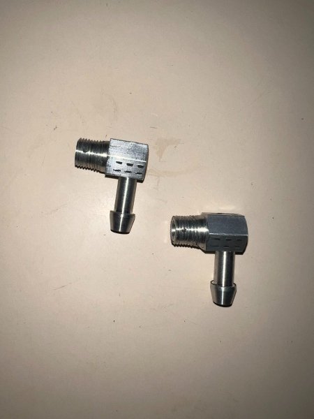

Received in the post two check valves for my wing tanks vent arrangement.  Made by Peter Anson Engineering and will stop the fuel flow out the vent pipes when taxing with full tanks.  I'll commence taxi on the tank that the return line is plumbed to.  Hopefully fit tomorrow or in near future.  They have a 3/16" ball inside that is positioned that it lets in the outside air and when fuel flows out of the tanks the ball seals.
$35 each and valve for money as specially made the Nynja wing tanks and vent setup.
Edited by Blueadventures
Fitted the non-return fuel tank vent valves to the wing tanks today.  Fiddly job but all done now.  Used 577 locktite to seal.  Keen to try out with filled tanks.

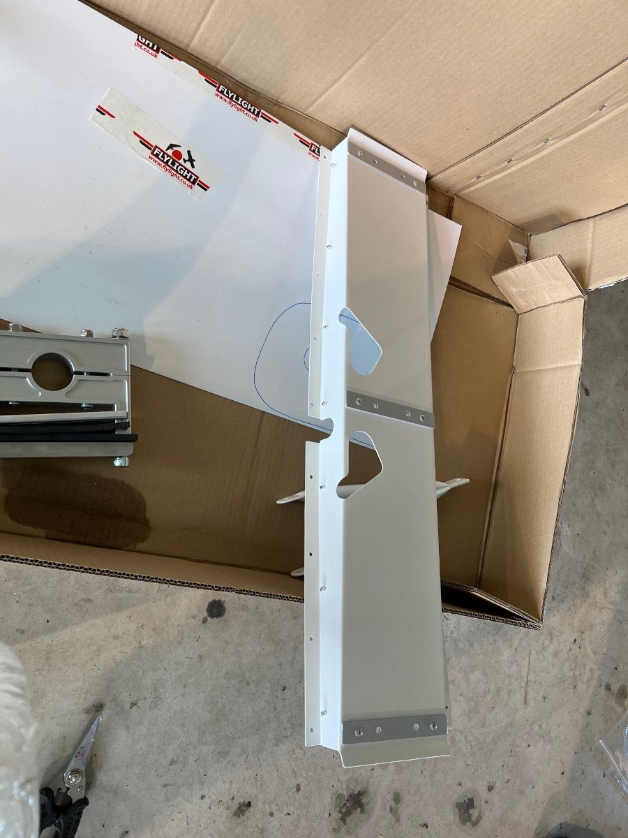

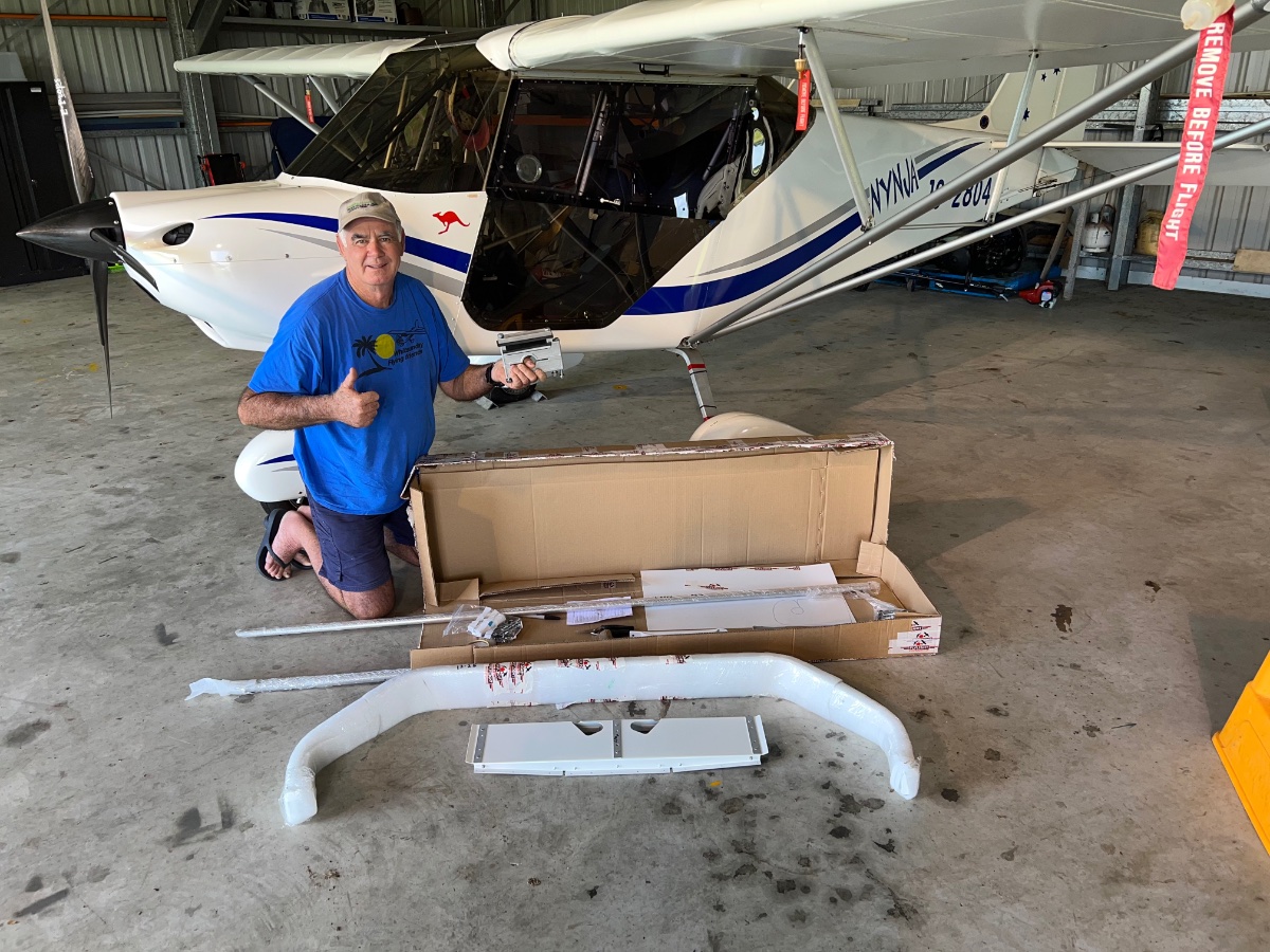

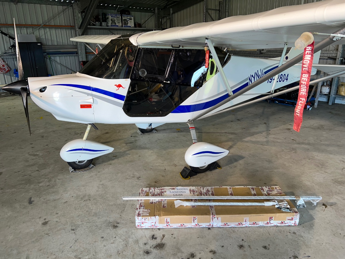

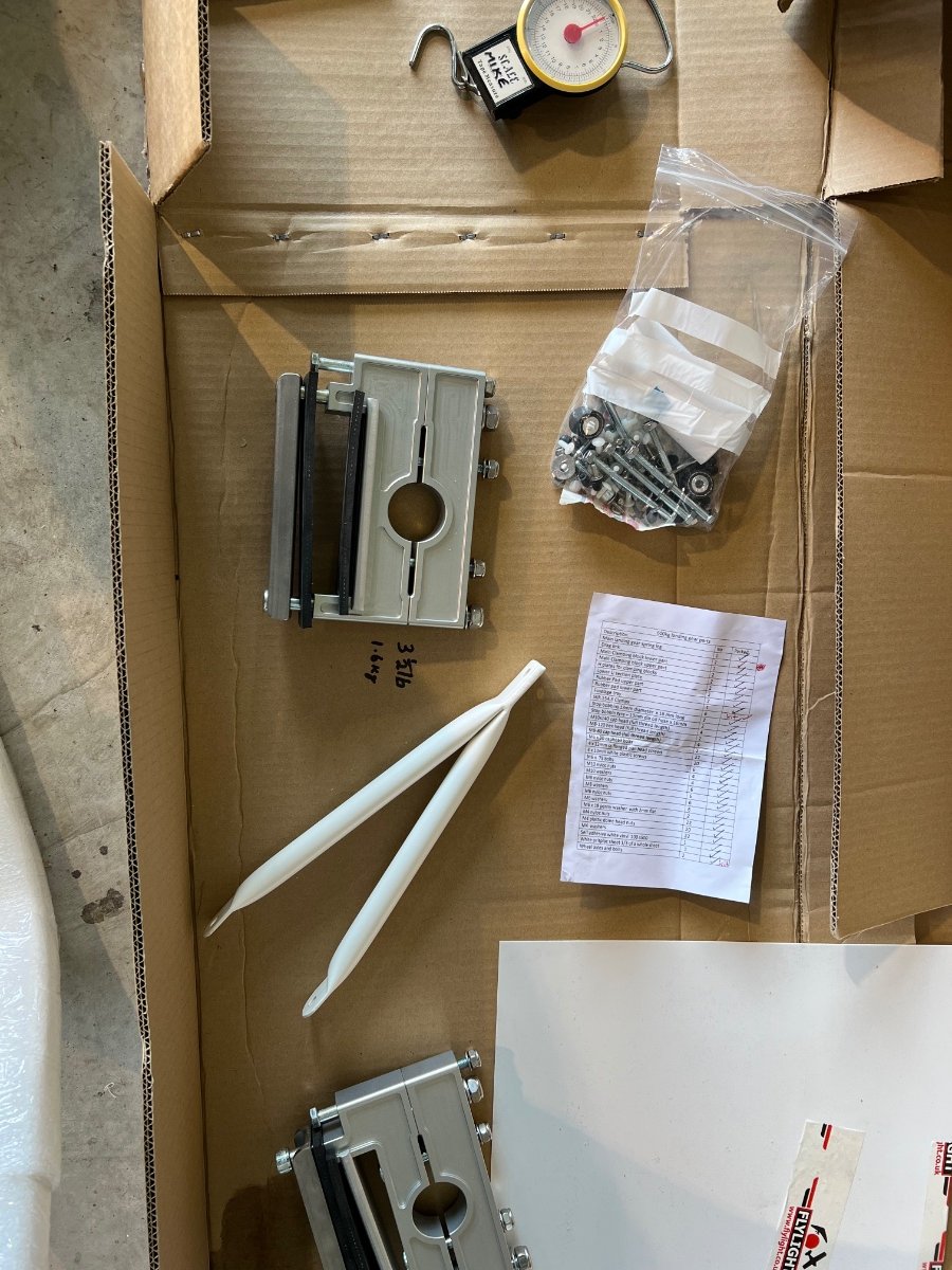

Have the 600kg upgrade kit on the way to be fitted, undercarriage first then do the wings upgrade. Also viewed Barry’s build that is a new 600kg variant.
  • Like 5

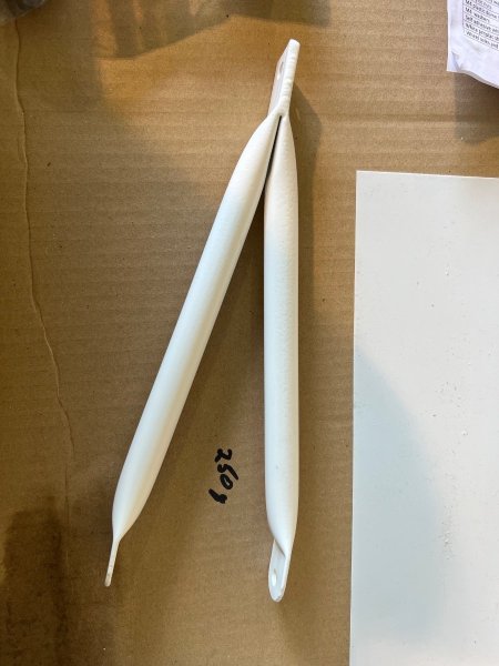

Unpacked the upgrade kit today.  Weighed the items so I have a record of the new structural bits.  I’ll weigh the respective bits removed. A new w&b will be carried out on completion.  Doing the upgrade in two stages, undercarriage first then later the wing upgrade then I’ll be the 600kg variant.  Caving up two lift attachment plates to allow suspending the aircraft without removing the wings. Cardboard template and being made in 25 x 3mm flat bar, made and just need dressing the edges.
Very interesting Mike!  Looking forward to further reports. That solid one-piece undercarriage member is very impressive.  The U-bolted individual legs of the earlier Rangers never did inspire a lot of confidence (though they seem to work ;- )

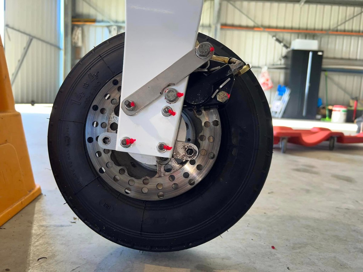

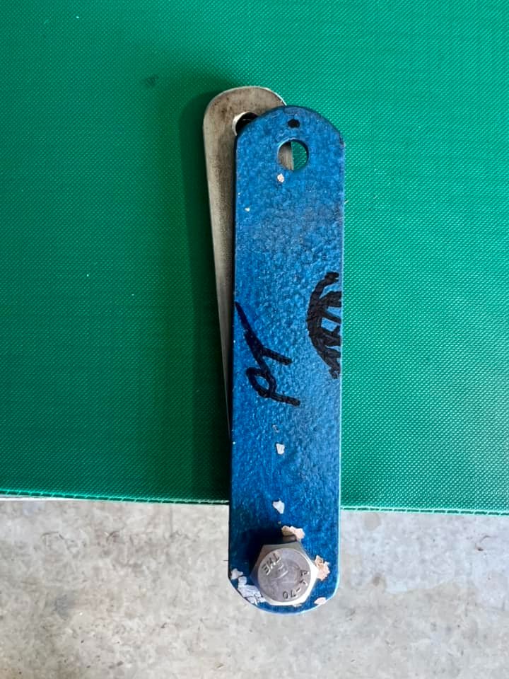

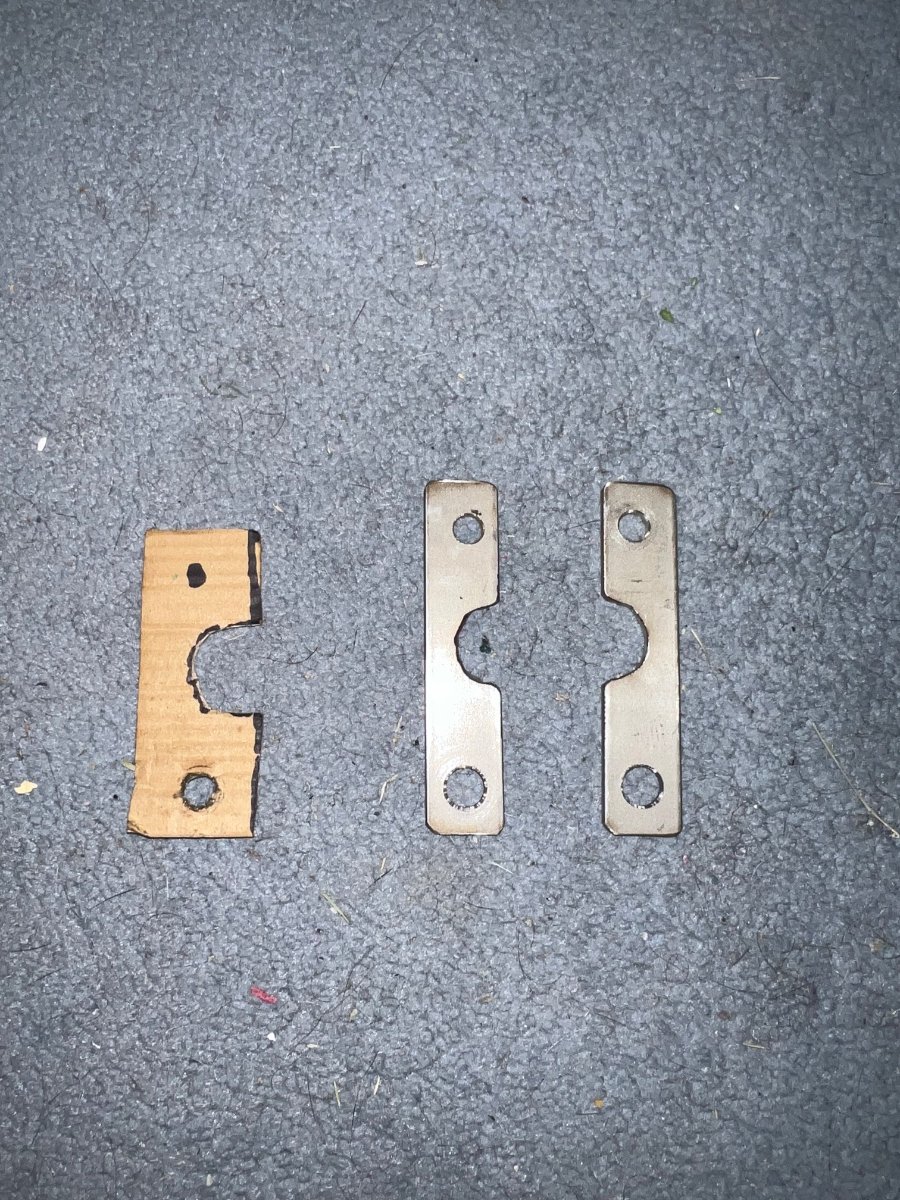

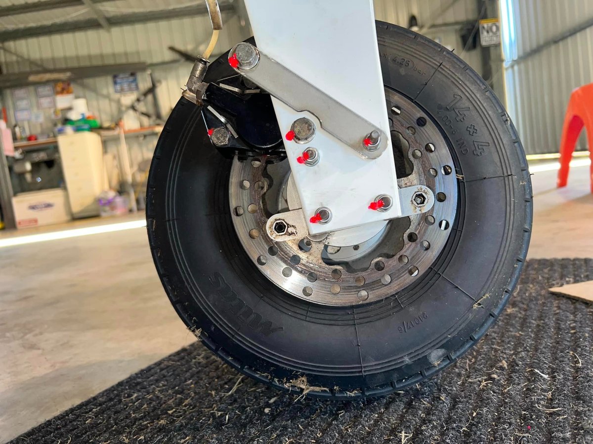

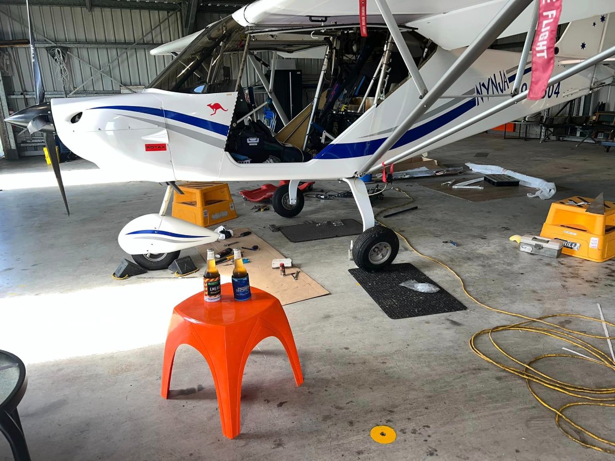

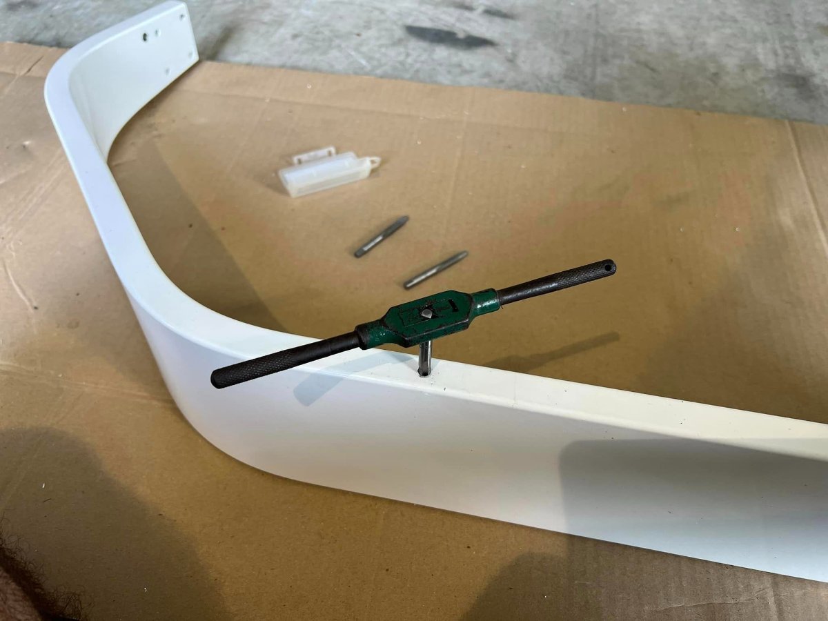

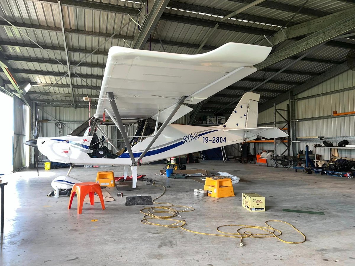

The Nynja is back on her wheels now and detached from being lifted. Tapped the threads for the bobbins that prevent sideways movement of the undercarriage. Yesterday had the wheels back on but needed some long sockets to allow torque up of the nylocks for the 10mm undercarriage bolts. Stopped for the day and had a beer with my mate who was helping. No more work is ever done once a beer is opened.
Did them today, looked at elongating the brake band holes and decided to fabricate up new ones as a perfect fit. Put some fuel in the tanks and plan to double check things in morning, vacuum the inside, fit the seats, and doors then try it out.
