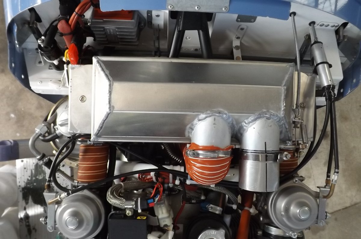

IBob Posted December 18, 2022 Posted December 18, 2022 6 minutes ago, danny_galaga said: Oh, KISS applies here. See attached. Ah, gotcha. The Savannah 'carb heat' just takes air from over the muffler into the airbox, so is divorced from other systems and not at risk of complicating them. 1

IBob Posted December 18, 2022 Posted December 18, 2022 AUTO CARB HEAT: The Savannah XL and S take air in to the airbox via a NACA scoop on the top of the cowling. The airbox has a temperature probe, and I noticed that in a hard climb, the airbox temperature would rise. The reason was that the increased angle of attack altered the airflow through and round the cowling with warm undercowl air being taken at the 20-25mm gap between the NACA scoop fibreglass and the airbox inlet, instead of cold air from the NACA scoop. This was easily fixed by extending the airbox inlet with an aluminium tube, held in place with a hose clamp. I left a gap of approx 3mm to allow drainage in the event of rain while parked. The extension is marked with a black felt pen line at the RH end of the airbox. (The scat tube is warm air from the muffler for those times when you do actually want carb heat). 2
