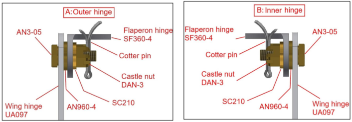

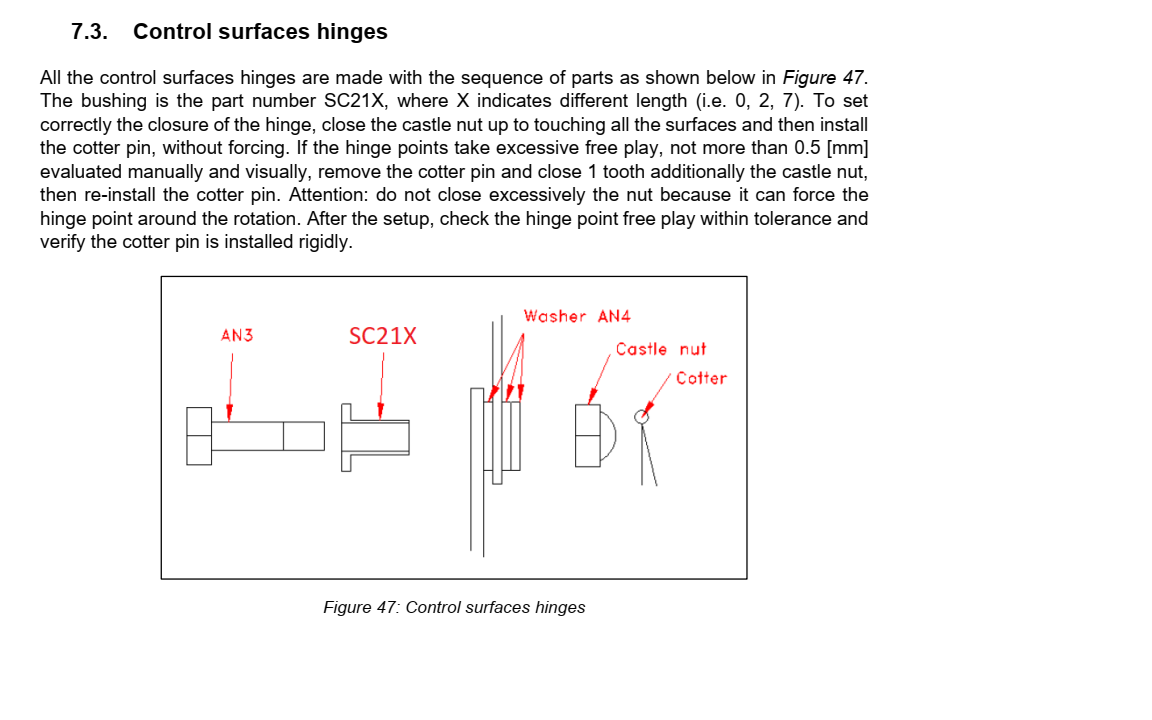

Lukeh Posted 17 hours ago Posted 17 hours ago I noticed free play on both outer hinges on Savannah S. Will I need to change bushing and pin, or could there be a more serious problem concerning metal parts of the wing and flaperons? Anybody has done this?
