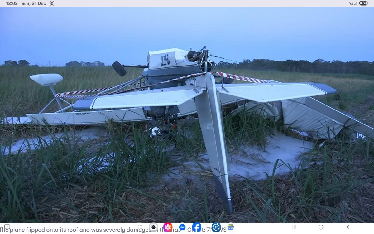

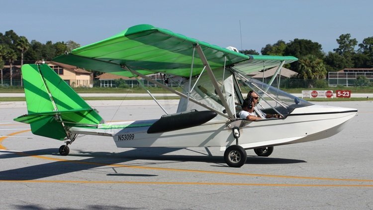

red750 Posted 15 hours ago Posted 15 hours ago A 61 year old pilot was lucky to escape injury when his light plane crashed upside down at Norwell Qld. The plane, which looked similar to the photo below, was moderately damaged and identification was difficult from the TV footage. 2
red750 Posted 12 hours ago Author Posted 12 hours ago Traced the rego. It was a Progressive Aerodyne Searey. 1 1
Thruster88 Posted 11 hours ago Posted 11 hours ago (edited) From the pictures it could be said the aircraft crashed heavily in a left wing low attitude and then rolled/pitched over. The vertical stabilizer and RH undercarriage has minimal damage. Perhaps a departure stall. Airspeed is life. Edited 11 hours ago by Thruster88 1 1 1

turboplanner Posted 8 hours ago Posted 8 hours ago 1 hour ago, BrendAn said: I can't get over how many stall accidents there are. It's not hard to fly the correct speeds or even add a bit of not sure High engine pod RA aircraft have a history of pitching nose high if the thrust from the engine stops. People don't seem to be quick enough to react. 1 1

Blueadventures Posted 2 hours ago Posted 2 hours ago (edited) 8 hours ago, Thruster88 said: From the pictures it could be said the aircraft crashed heavily in a left wing low attitude and then rolled/pitched over. The vertical stabilizer and RH undercarriage has minimal damage. Perhaps a departure stall. Airspeed is life. Agree, (Following comment not meant to be instruction as I'm not an instructor ; just a comment) this type doesn't like losing airspeed in initial climb (low to ground and too higher climb initiated resulting in slowing the airspeed; will be near impossible to correct with nose over due to hight and rpm will already be at max, so nothing available - (yep higher AOA than desirable). Edited 2 hours ago by Blueadventures 2
