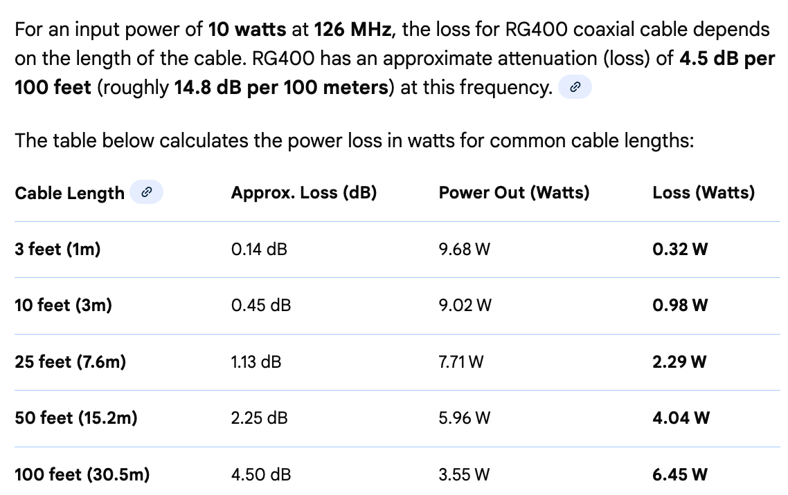

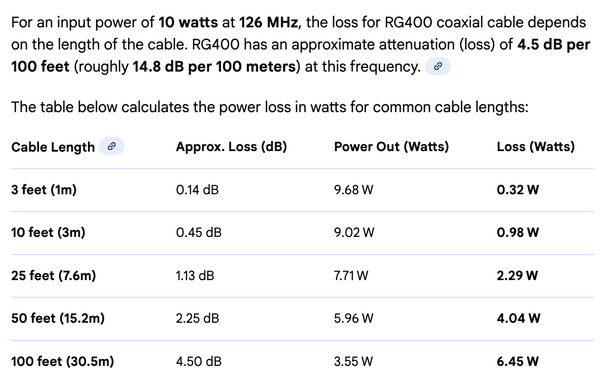

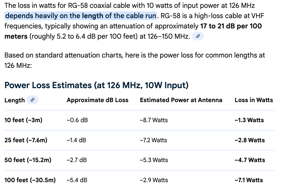

Kyle Communications Posted Sunday at 01:17 PM Posted Sunday at 01:17 PM I just used AI but the figures are correct. 3dB loss is half so if your putting out 10 watts of power out of the radio then you are losing 5watts in transmit and half of the strength of the recived signal So it depends of course how long a run of coax you use. The shorter the better and every dB counts The cost difference is not a lot between both types. I know which one I will always use. Mark At 126 MHz (the aviation band), RG400 coaxial cable has an estimated signal loss (attenuation) of approximately 14.3 to 14.5 dB per 100 meters (roughly 4.4 to 4.5 dB per 100 feet). At 126 MHz (common for aviation communications), standard RG58 coaxial cable typically exhibits a signal loss (attenuation) of approximately 17.5 to 19.5 dB per 100 meters (roughly 5.3 to 6.0 dB per 100 feet).
coljones Posted Sunday at 01:49 PM Posted Sunday at 01:49 PM 30 minutes ago, Kyle Communications said: I just used AI but the figures are correct. 3dB loss is half so if your putting out 10 watts of power out of the radio then you are losing 5watts in transmit and half of the strength of the recived signal So it depends of course how long a run of coax you use. The shorter the better and every dB counts The cost difference is not a lot between both types. I know which one I will always use. Mark At 126 MHz (the aviation band), RG400 coaxial cable has an estimated signal loss (attenuation) of approximately 14.3 to 14.5 dB per 100 meters (roughly 4.4 to 4.5 dB per 100 feet). At 126 MHz (common for aviation communications), standard RG58 coaxial cable typically exhibits a signal loss (attenuation) of approximately 17.5 to 19.5 dB per 100 meters (roughly 5.3 to 6.0 dB per 100 feet). So about 0.2db/ metre
