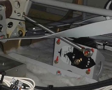

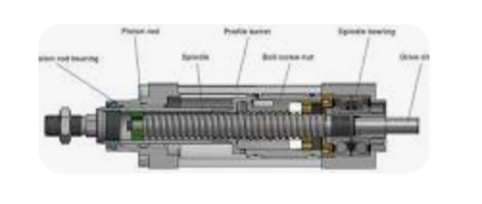

turboplanner Posted January 26, 2024 Posted January 26, 2024 10 hours ago, Steve L said: Runaway trim When that happens the trim actuator, if found in the wreckage is usually robust enough to show the position it finished up in, so seriously out of trim is obvious. I couldn't find a Technam photo but this one's just good enough to show us the screw which is spun by the motor and a "nut" equivalent which slides along the screw, like a nut moving along a bolt. When the power is cut by the crash the nut stops moving.
fallowdeer Posted January 27, 2024 Posted January 27, 2024 (edited) Looks a lot more like a Dynon autopilot servo to me.. Edited January 27, 2024 by fallowdeer
turboplanner Posted January 27, 2024 Posted January 27, 2024 19 minutes ago, fallowdeer said: Looks a lot more like a Dynon autopilot servo to me.. Can you find a P92 photo?
facthunter Posted January 27, 2024 Posted January 27, 2024 Surely you can overpower/ disconnect any servo permitted to be used? Nev 1
RFguy Posted January 27, 2024 Posted January 27, 2024 (edited) yes, that is a dynon servo which is a crude but effective device- a stepper motor and a gearbox. . that looks more like part of an autopilot than a control system trim servo, but could be. Stepper motors have high inherent torque and dont need much gear reduction to get the required torque (for this application). turbs illustration post is a screw jack - (or lead screws) are generally run at high ratio with high speed small motors and there is significant resistance to the screw jack moving when force is applied to the actuator tends to impose high friction forces dependin gon the construction (screw thread - acme screw jack) or reciprocating ball screw. A screw jack reduction ratio is the force application circumference divided by the screw pitch Edited January 27, 2024 by RFguy

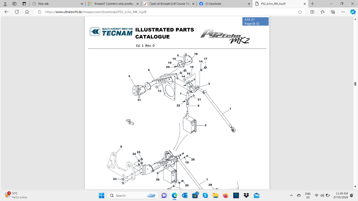

Blueadventures Posted January 27, 2024 Posted January 27, 2024 (edited) . May be this, I don't know for sure. Edited January 27, 2024 by Blueadventures

Steve L Posted January 27, 2024 Posted January 27, 2024 7 hours ago, pmccarthy said: Tecnam trim servo That’s nothing like my eaglet. I’ll take a pic of mine on the weekend 1
