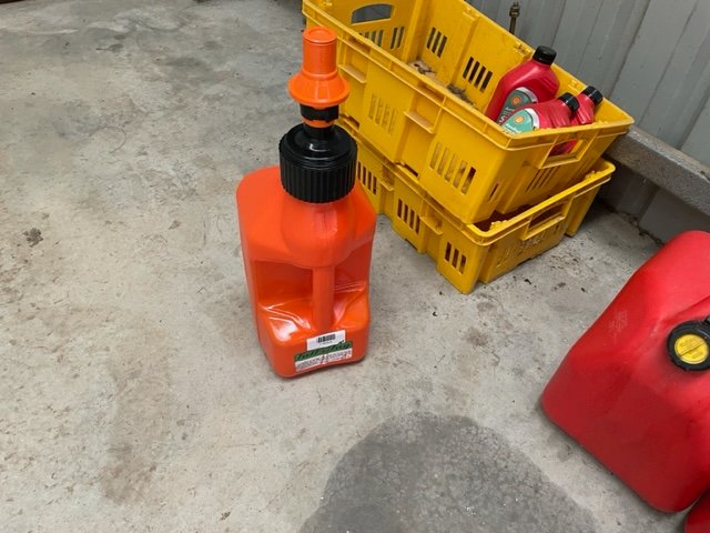

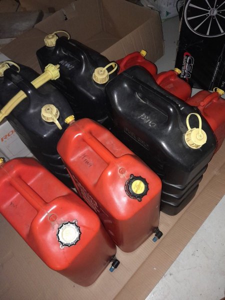

Kiwi Posted December 27, 2022 Posted December 27, 2022 7 hours ago, Carbon Canary said: If you get a chance can you ask your mate how much lift these things will deliver to ? ie. will they pump directly upwards say, 1m ….and how much slower is the delivery at that height ? For the one I posted.... At one metre it takes about 4 minutes for 20 litres, on the wing it takes just under 3 minutes. I should have mentioned that the spike is about 35mm wide and doesn't fit all drums. Fits my red "Scepter" drums not the black ones or my other red ones (SCA from Supercheap) 1 2

pmccarthy Posted January 5, 2023 Author Posted January 5, 2023 This looked like the answer and so I bought one, but the nozzle doesn't fit into the Vixxen or the Foxbat filler. It would, but they have a breather line inside the filler which fouls the nozzle. I tried discharging it manually and got fuel all over the wing as usual! The search continues. 1
