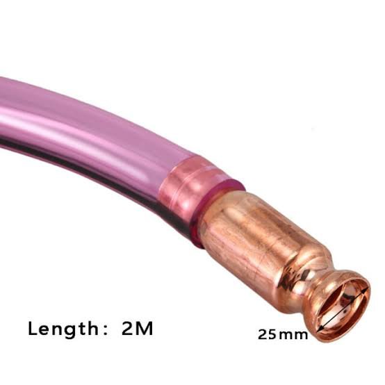

skippydiesel Posted December 23, 2022 Posted December 23, 2022 A word (or more) on syphons/jigglers/power aided syphons; Now retired to a "hobby" farm, I still have some, larger, by domestic standards, diesel & petrol powered machinery. I refuel with the aid of 20 L drums & a jiggle syphon. This works very well on the farm because I have machines with hydraulic buckets that can lift the 20 L fuel container(s) to a good height (relative to the tank fill point), so that gravity can work its little miracle . As a believer in putting clean fuel into my machines, I have an in line filter (120 mu) on my syphons. This system would work well if I had a hydraulic helper, where the aircraft lives and if I could take the hydraulic helper with me on away trips but unfortunately this is not the case. The reality is, for any sort of syphon to work effectively the supply tank must be above the receiving tank ie you must lift your 20L to a functional height - this the physical exertion I would try to avoid. Syphons would not work for me. 1

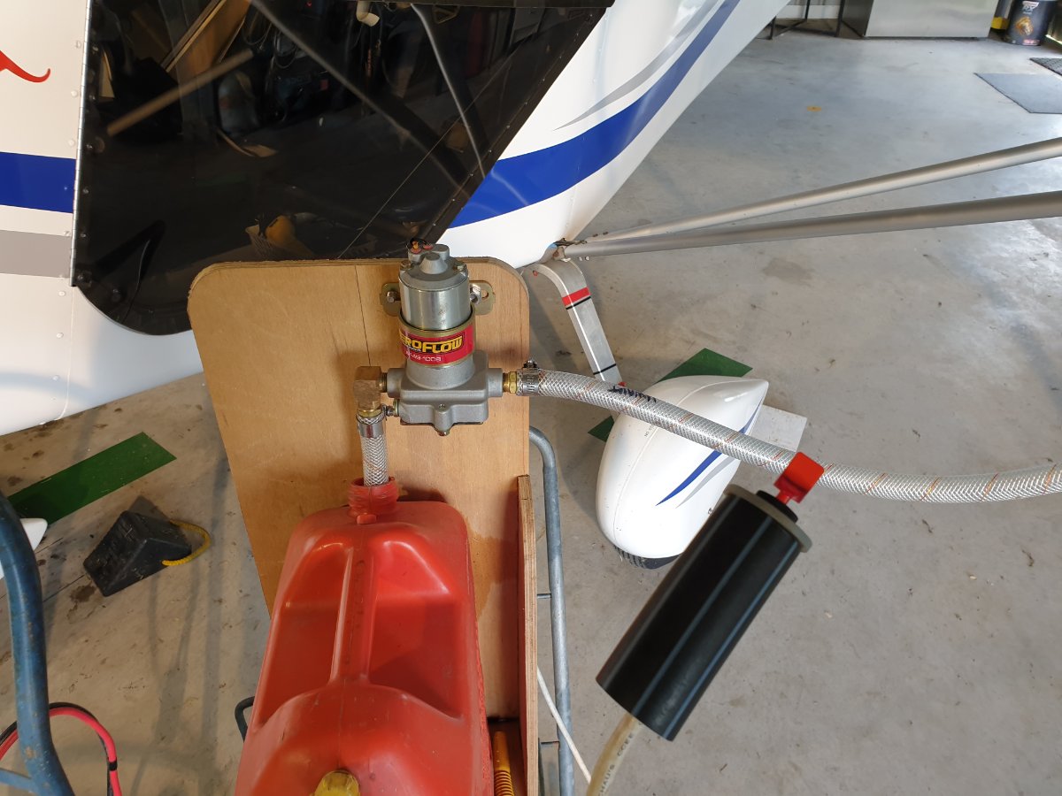

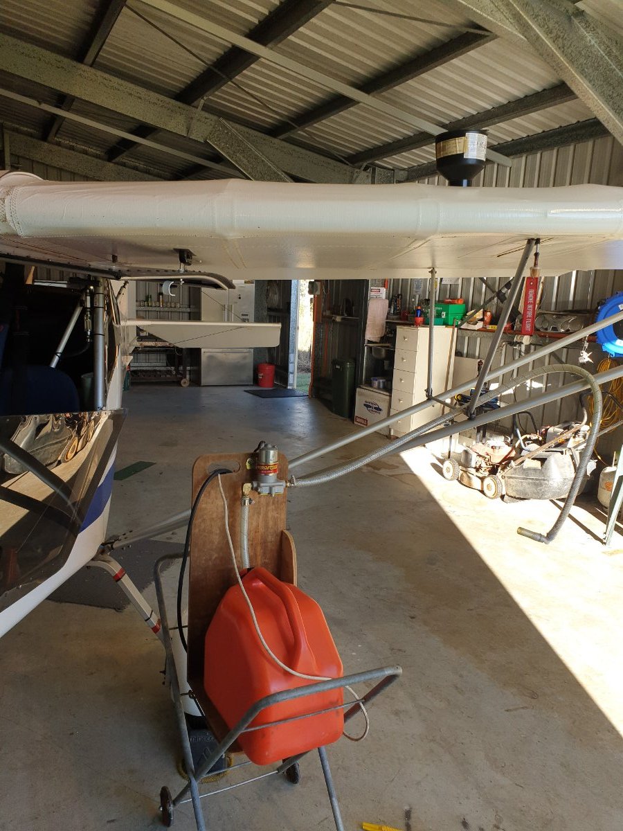

Blueadventures Posted December 24, 2022 Posted December 24, 2022 26 minutes ago, onetrack said: I have found out Scintex are selling a 75 litre petrol fuel trolley. The petrol version only comes with a manually-operated rotary hand pump, that looks a bit cheap. The diesel trolley comes with an electric pump. https://www.scintex.com.au/products/portable-fuel-tank-75l?variant=5563747794973¤cy=AUD This is an image of what I use. Voltage from aircraft or separate battery. Works great for me. 3 1

skippydiesel Posted December 24, 2022 Posted December 24, 2022 4 hours ago, Blueadventures said: This is an image of what I use. Voltage from aircraft or separate battery. Works great for me. It resembles my Holly copy but may be something different. Please name the pump or type. What is the actual flow rate (either 20L/?minutes or ?L/minute)?

Blueadventures Posted December 24, 2022 Posted December 24, 2022 (edited) 10 minutes ago, skippydiesel said: It resembles my Holly copy but may be something different. Please name the pump or type. What is the actual flow rate (either 20L/?minutes or ?L/minute)? Aeroflow Red, Black is a faster pump rate but to me speed is not every thing and can contribute to a spill situation. 20 liters in 3 1/2 minutes. Have a toggle switch on a handle on a meter lead. And 90 degree elbow at filling end so it rests on rim of Mr Funnel. Takes both 20 litre plastic jerry cans and the jug type in image. I hold the switch in one hand and the fill end into the funnel with the other hand. Edited December 24, 2022 by Blueadventures 1
