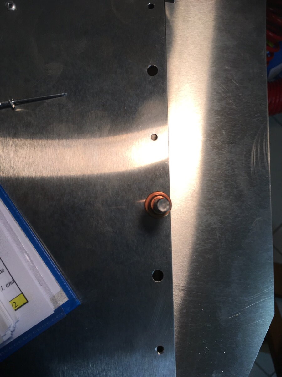

I have ordered a Savannah S kit and at the moment I m building (to make practice and exercise / I m a pharmacist ) a tail fin that I have bought separately. In the build instruction I read: Slightly countersink the holes for rivets and install  the rivets to have perfect flush head.
How should I do that without weaking the very thin alumiunm sheet?
With a drill bit? Wich Dimension ?  I have no idea.
Thank you very much in advance for any help.

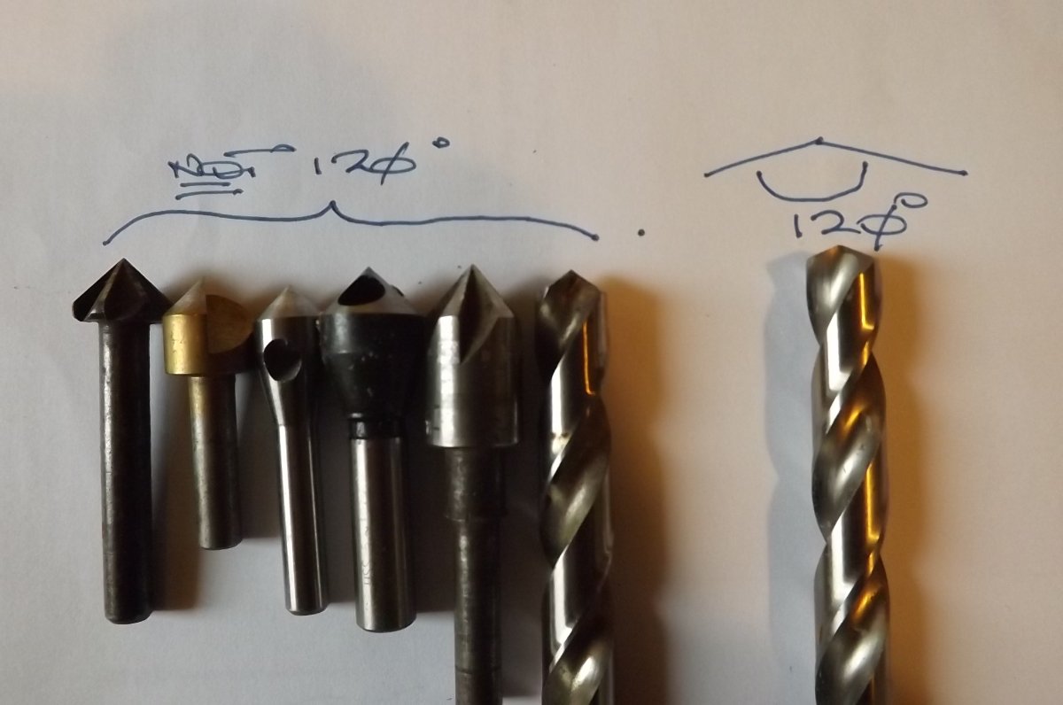

3. If doing it this way:
Use a much larger drill (8mm or larger)
Ensure that the drill tip is the correct angle (not all drills have the same tip angle, see attached pic)
Turn the drill by hand and NOT with an electric drill. It's okay to have the drill bit in a drill, but turn it by hand, not with the power. The reason for this is that if you use the drill to turn it, it is very difficult to control the depth of the cut, and very easy for the drill to grab and pull entirely through, leaving you with a big hole.
4. While this does the job, if I was building again, I would buy a countersink drill bit: this has a tip that fits through the hole and keeps the bit centered. It was the one tool I did not have that I wish I had had.
PS while there are lots of countersink drill bits advertised, almost all of them (like this one) have the wrong countersink angle for the rivets we are using.

However, here again we run into the countersink angle problem: the tools offered by Aircraft Spruce cut a 100deg countersink, but the standard countersunk blind rivet has a 120deg head.
And this is what I kept running up against when trying to source individual countersink bits...
Its called a Microstop
But be carefull the std set of countersinks that comes with it is 100 or 110 deg...NOT 120 deg...you have to buy teh 120deg set separetly
I had to get one for building my Rans S-21..Rodger who got his with mine when we bought them in found out the hard way about the wrong angle supplied bits. luckily for me as he had to put larger rivets in those spots
