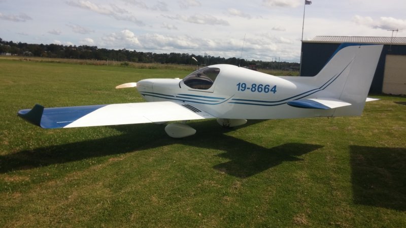

I agree about the airflow escaping due to creating a low pressure area. I have a 3mm gap around the canopy trailing edge which sucks the air through. The nozzles aren't very big but the air really blasts through. Contrary to the opinion of most people when I was building my aircraft the gap doesn't create any noise. The only time it is a problem is when the aircraft is stopped on the ground & it is raining or being hosed down as a bit of water can get in then. Also the canopy is tinted so that helps a bit too. Taxying with my arm holding the canopy up a bit as in Red photo helps to keep it a bit cooler on the ground.
