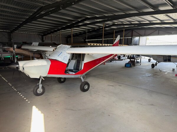

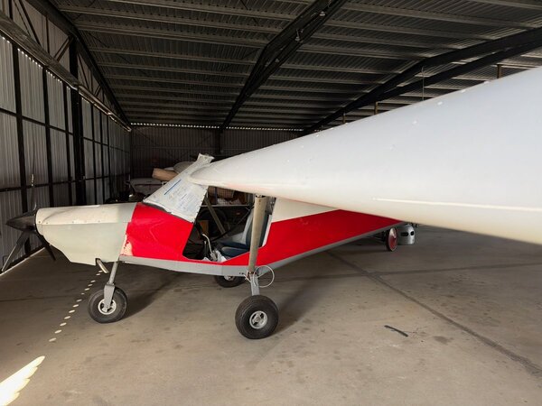

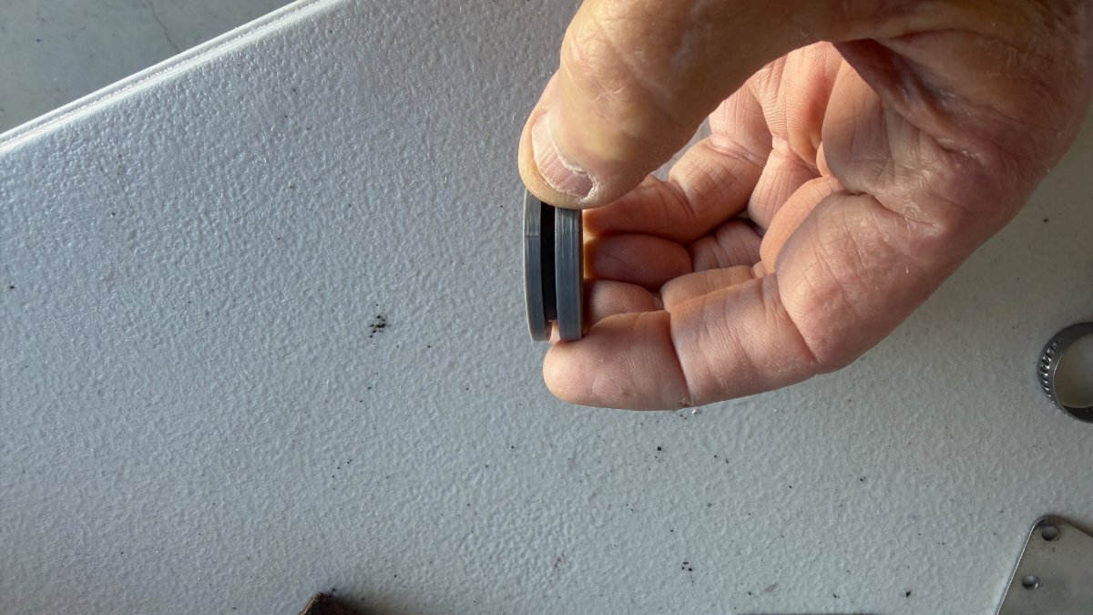

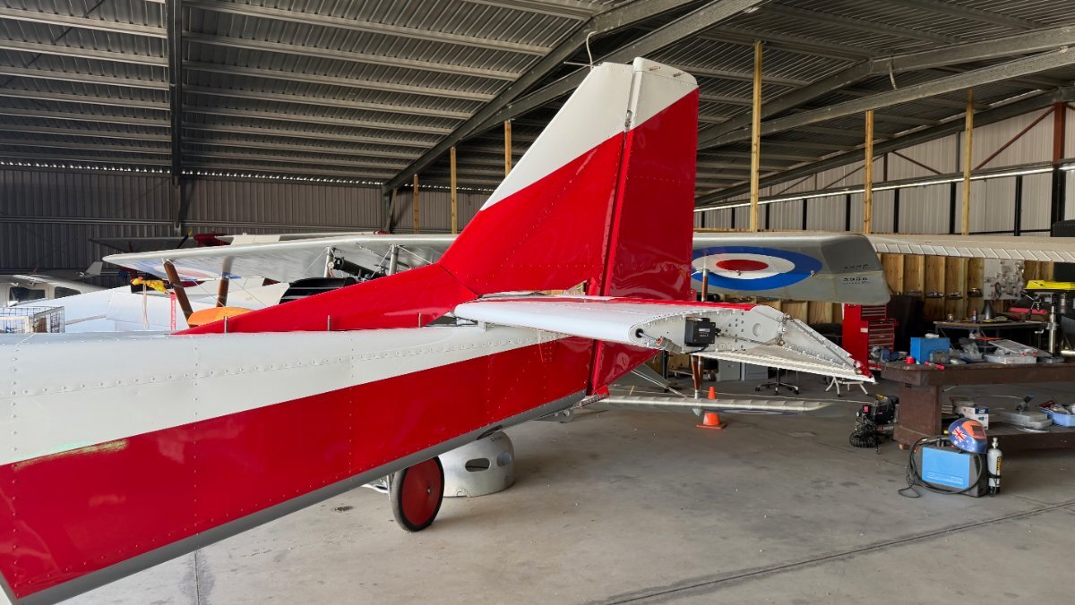

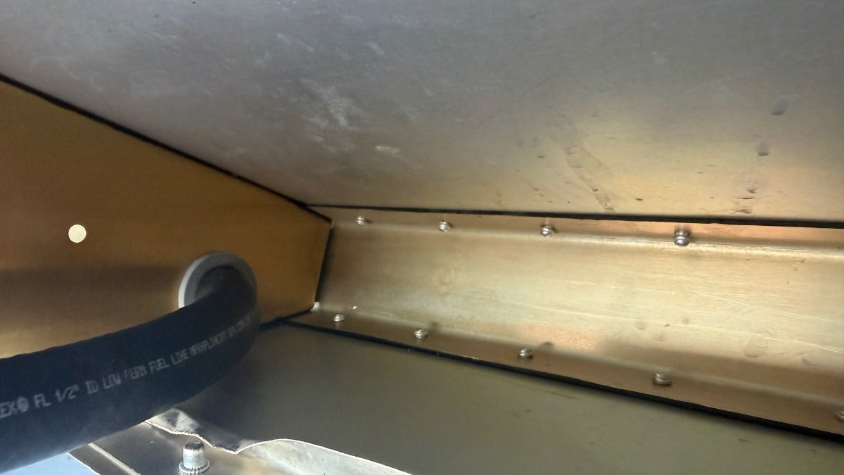

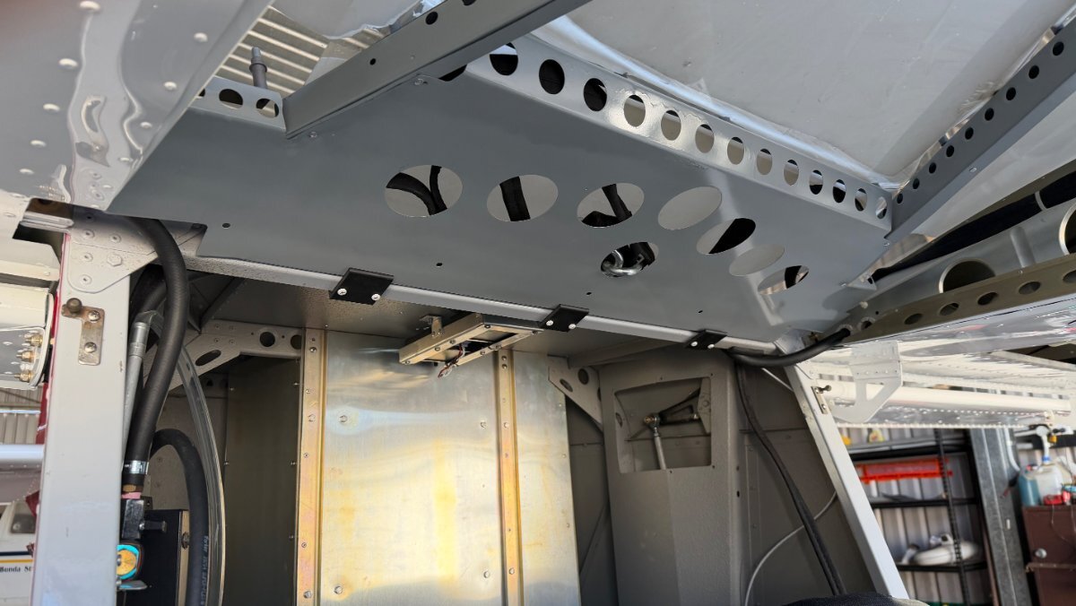

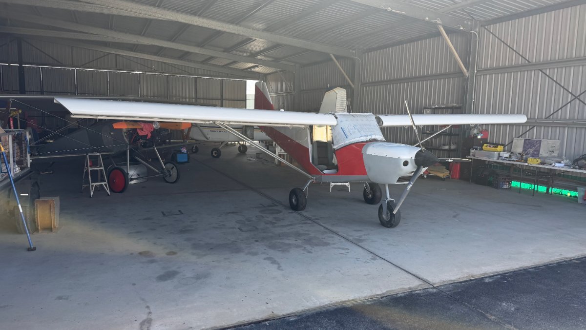

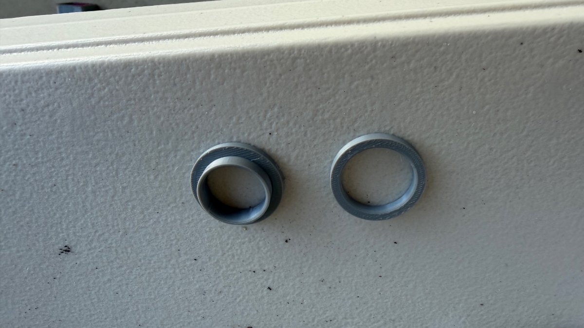

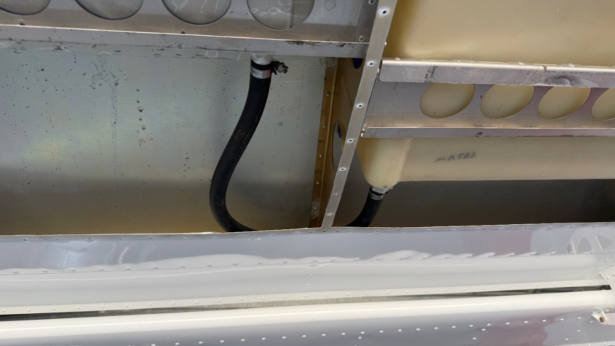

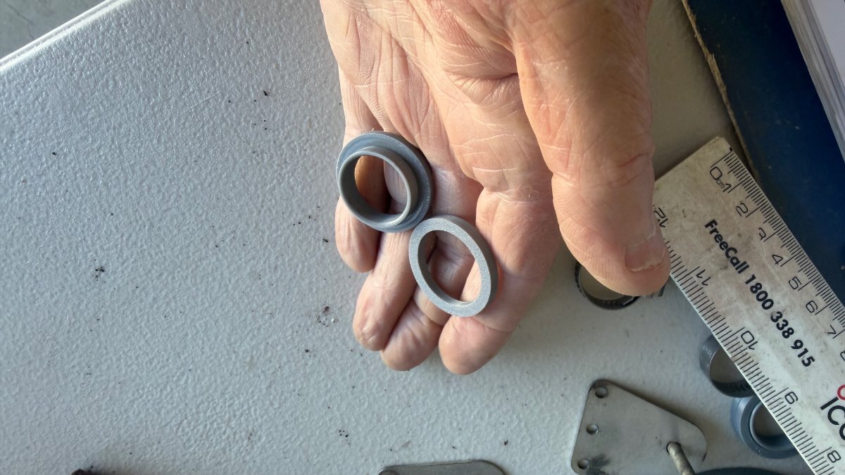

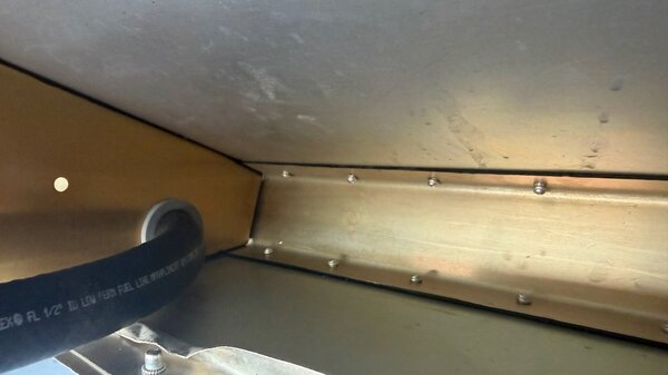

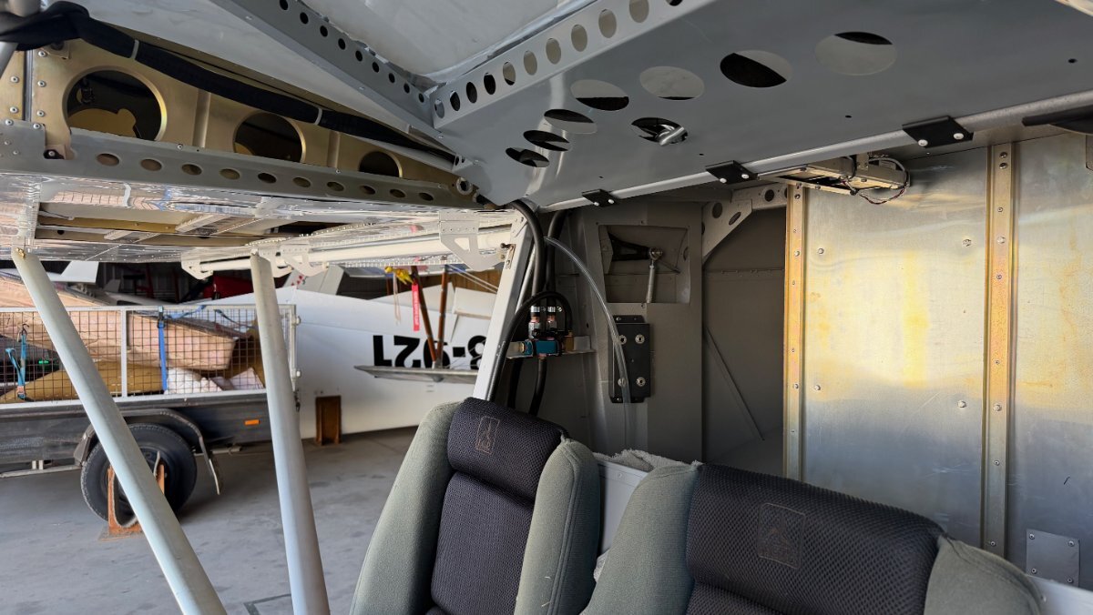

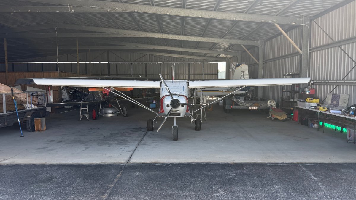

Kyle Communications Posted September 13 Author Posted September 13 Been getting a lot more done since getting the wings on. The see through top cabin cover which I have had special IR and sun tint applied to is now back on The flaperons are all now on and connected. The rudder is now fitted The fuel tanks are plumbed together and also now plumbed to the manual fuel switch The larger 1/2 inch transfer pipe that goes between the 2 tanks in each wing would not go through the rib hole at the back so I designed up a new grommet so it would fit nicely and 3D printed those from ASA filament at 100% fill The fuel tube that runs overhead to the manual switch from the left I designed up some support brackets for the fuel tube remain captured behind and above the cabin head support. These also keep the rear tray for the parachute straps supported, they are 3D printed from CF=Carbon filament and 100% fill Fitted off the brake hoses to the brake units on both sides. Glad to see the calipers still nicely fload over its bolts after such a long time since I re did both calipers Everytime I go to the hangar I put a few hours in. I am doing all those final fit off and finishing jobs that take a lot of time. The 90% done 90% to go rule The dihedral really does make the aircraft look better What is that saying. "To eat a elephant you do it one bite at a time" 7 2
