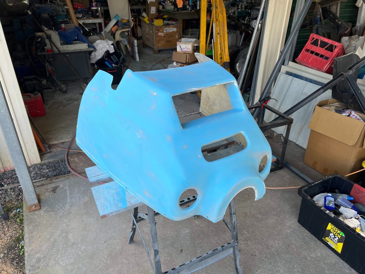

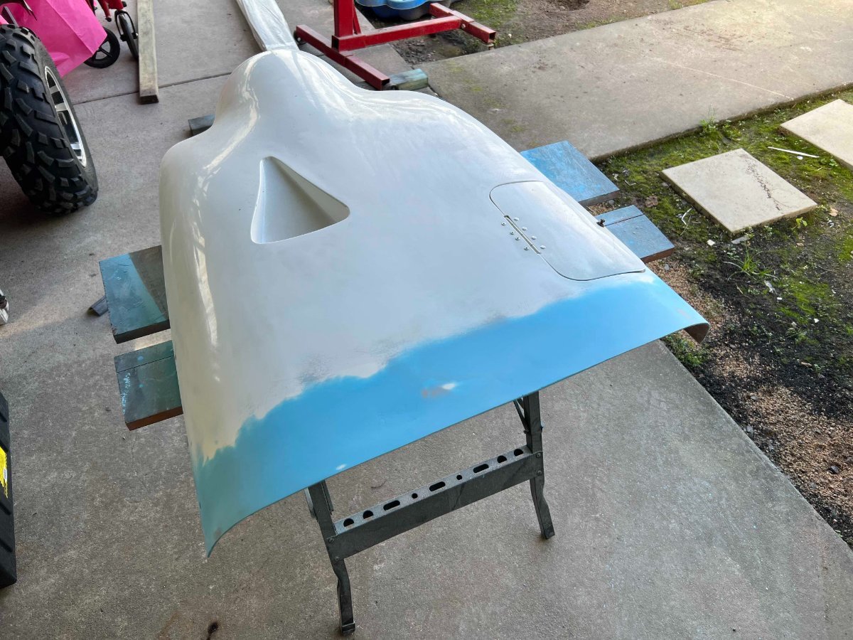

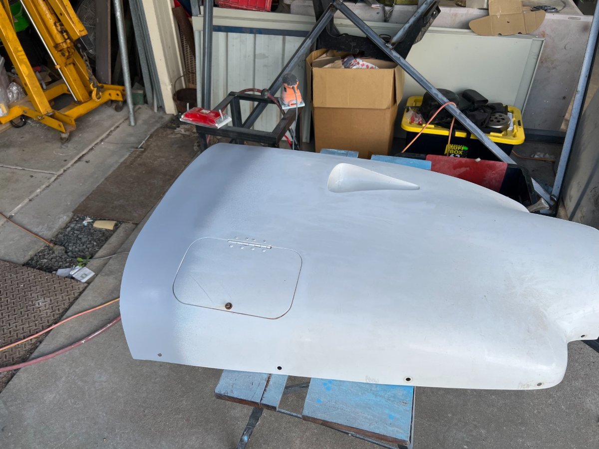

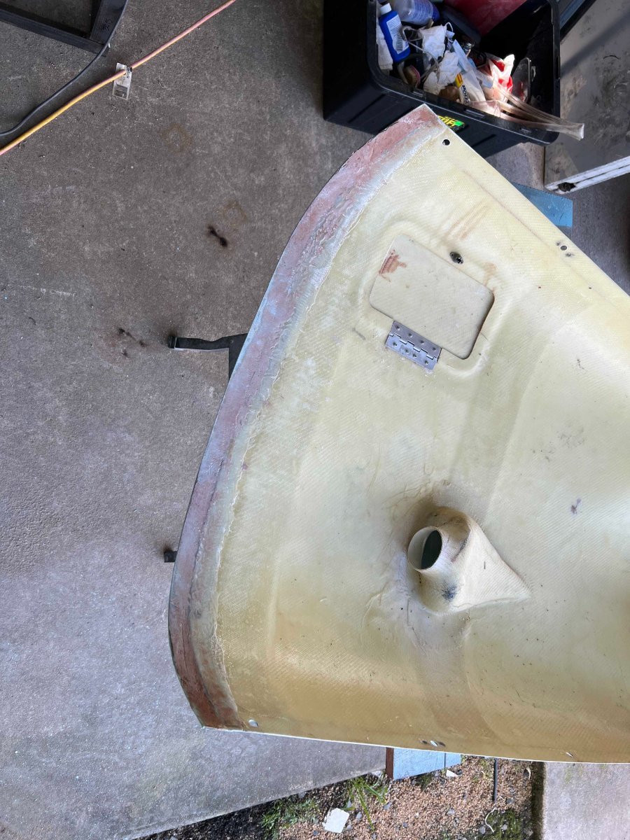

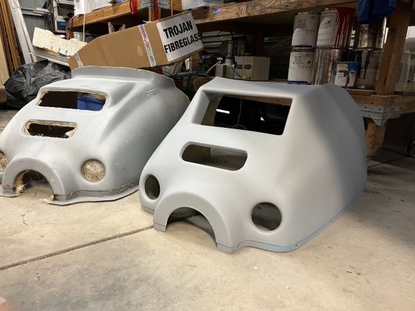

Kyle Communications Posted July 31, 2022 Author Posted July 31, 2022 I can now finally see the light at the end of the tunnel. This cowl has been the bain of my existance. Just a couple of small indents to fill and it can be prepared for painting. Finally got my tig back today. Its been used by my mate for about 6 years...like pulling teeth 🙂 The cowl has been fitted so now I can get the headers for the engine to the muffler properly repositioned. Then its a matter of finish hooking up the radiator system. I need to finish the avionics to a point where I can start the engine at least. There is a comparison pic between the 2 lower cowls. The genuine one is a plug I made 4 or so years ago so I have that one as a plug its way to heavy to be used on a aircraft. The top cowl has been extended by 25mm so it sits over the top of the skin on the dash front properly. 6

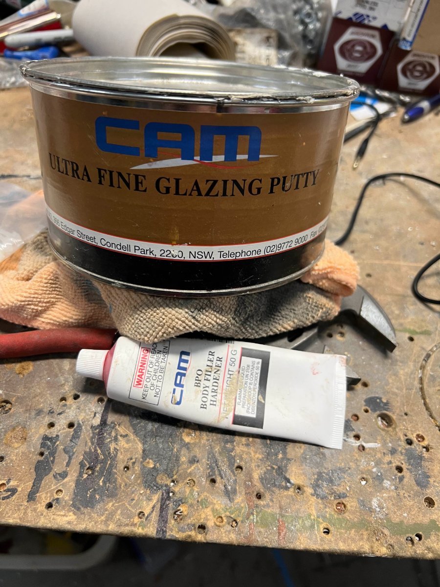

IBob Posted July 31, 2022 Posted July 31, 2022 Big job, Mark! And I never did come up with anything to (easily) fill in all the little mat holes on my kit supplied f/glass bits: sourced various products, but every sand/spray iteration showed more holes. If only they'd used a gel coat....what have you used there?
Kyle Communications Posted July 31, 2022 Author Posted July 31, 2022 I used this ultra fine filler. Its a auto one. Almost like a super smooth cream when mixed Lovely to sand as well 5 1 2

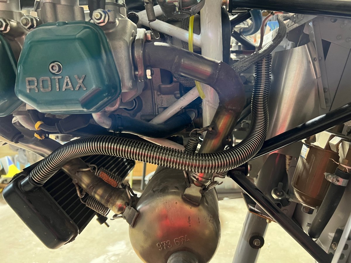

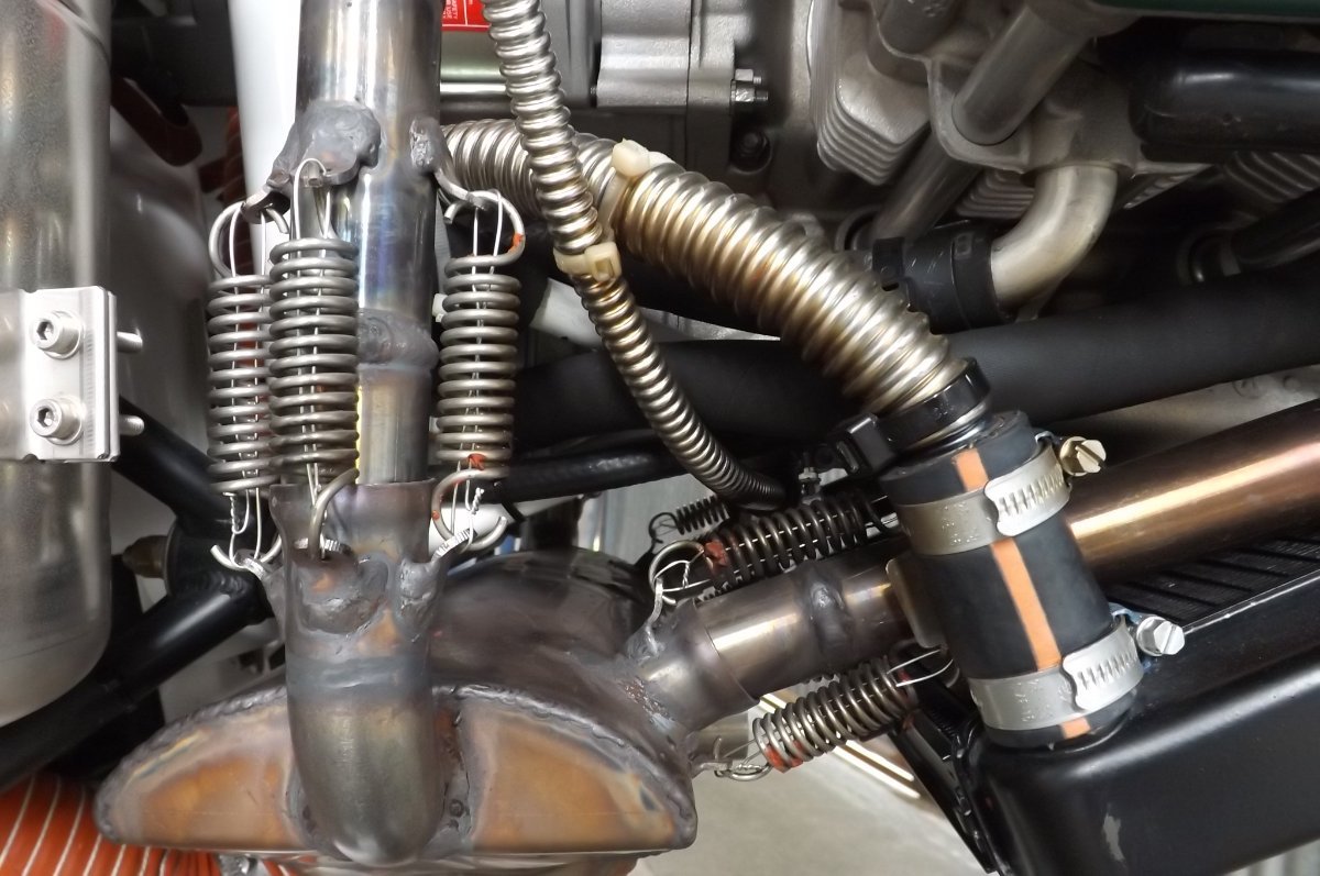

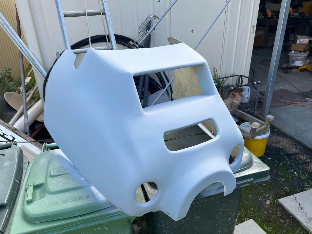

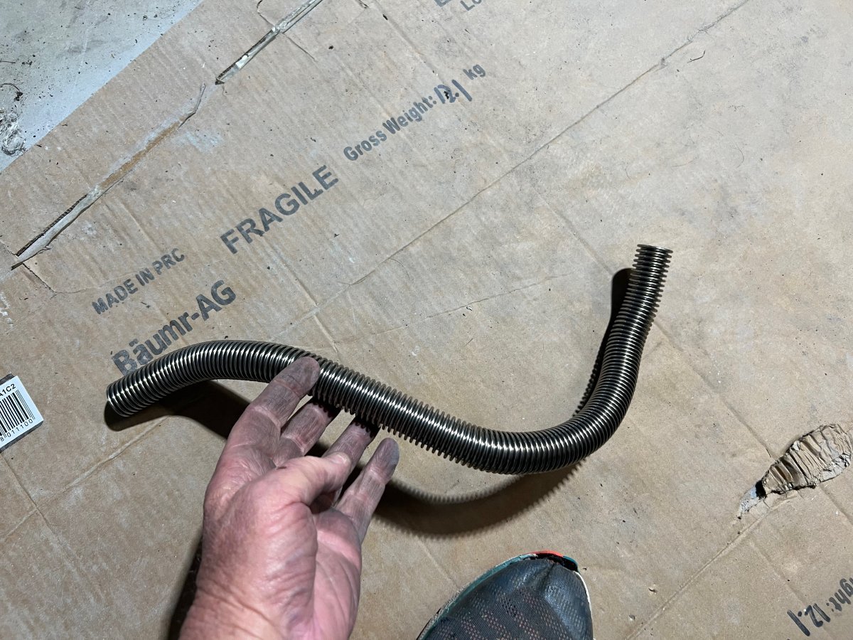

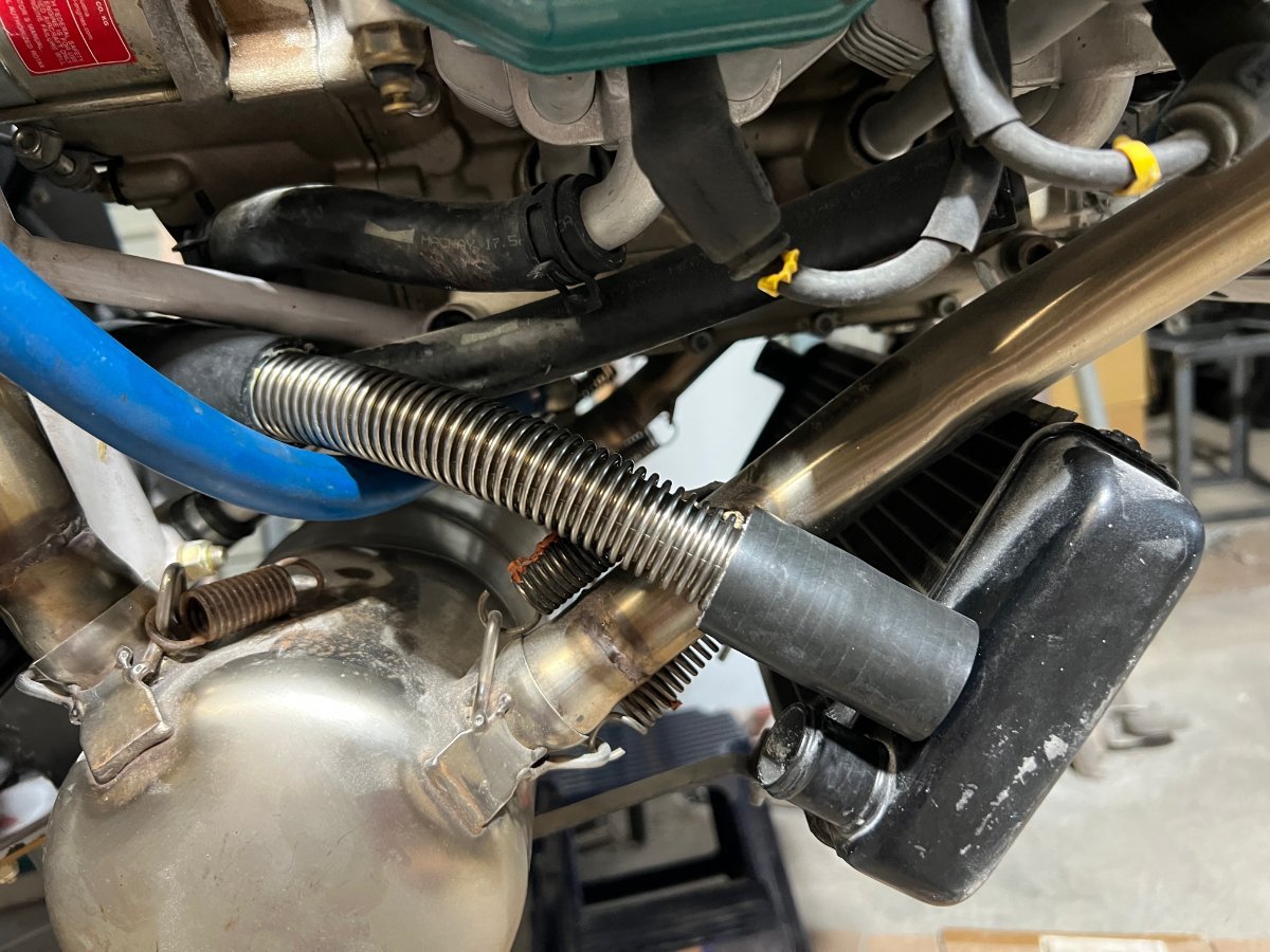

Kyle Communications Posted August 18, 2022 Author Posted August 18, 2022 My cowl is finally finished..just have to wet rub it when I am ready for paint. The next big thing was to get the water plumbing done from the waterpump to the radiator and the return to the resovoir. Because the exhaust pipes are so close to the radiator hoses in the Sav its a real PIA. So the idea of metal pipes between over the hot areas is the go...Like the pipes Mike (Blueadventures) got for his Ninja. But we have come up with what we think is easier and cheaper. ICP have been supplying this corrogated SS pipe for fuel and oil but it seems awfully thin to me and I dont like it but locally you can get a much better albeit a bit thicker and slightly heavier much better corrogated SS pipe. So after mucking up some sizing I got the right size pipe which is their 20mm which has a OD of 26.7mm and the inner of the rubber/silicone pipe used is 25mm so its a nice tight fit. I used a thin film of lithium grease to lube the inside of the rubber and silicone pipe to allow getting the SS tube into it. The beauty of this tube is you can bend it to shapes or curves you need and it is just held onto the rubber/silicone with good hose clamps. The SS tube is super strong so you literally cant crush it and over several ridges it will creeate a great seal with no leaks. So will get that done this weekend and bribe Danny to come over and see if we can finalise the cutting and welding of the exhaust system in the 2 places I need a little more room. I also have the same stuff but the diameter for the oil..so thinking of doing the same with the oil lines A few pics attached to see what its like. The 20mm SS pipe is about $20.00 a meter 3 2

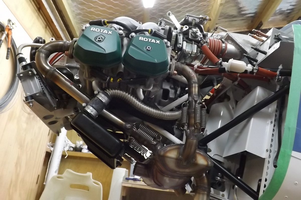

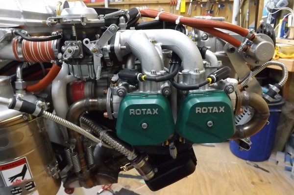

IBob Posted August 18, 2022 Posted August 18, 2022 My S kit was dated Dec 2014, Mark, ICP supplied steel pipe for fuel, oil and coolant. And you're right, it makes for a wonderfully compact installation, as I recall I formed the big coolant pipes in place. 1 1 1
Kyle Communications Posted August 18, 2022 Author Posted August 18, 2022 I thought that ICP only supplies fuel and oil pipe from what I had seen. I didnt realise that they did the water as well. As I said before I wasnt keen on how thin the pipes I saw were. I am much happier with this locally sourced stuff though. To the point where I think I may use it all the time...it is a little heavier of course but I feel more comfortable using it 1
IBob Posted August 18, 2022 Posted August 18, 2022 Mark, my pipes were further secured against vibration after those pics were taken. I also made little aluminium heat shields where the rubber is close to the exhaust, spaced from the rubber but held in place by the hose clips, you can just see the LH edge of one here. I've read a lot of critical opinion on the metal pipes, but much of it seems mainly to be resistance to something 'new'. I figured if they were failing, we would have heard about it.........the proof of the pudding and all that. 1
Marty_d Posted August 19, 2022 Posted August 19, 2022 16 hours ago, Kyle Communications said: My cowl is finally finished..just have to wet rub it when I am ready for paint. The next big thing was to get the water plumbing done from the waterpump to the radiator and the return to the resovoir. Because the exhaust pipes are so close to the radiator hoses in the Sav its a real PIA. So the idea of metal pipes between over the hot areas is the go...Like the pipes Mike (Blueadventures) got for his Ninja. But we have come up with what we think is easier and cheaper. ICP have been supplying this corrogated SS pipe for fuel and oil but it seems awfully thin to me and I dont like it but locally you can get a much better albeit a bit thicker and slightly heavier much better corrogated SS pipe. So after mucking up some sizing I got the right size pipe which is their 20mm which has a OD of 26.7mm and the inner of the rubber/silicone pipe used is 25mm so its a nice tight fit. I used a thin film of lithium grease to lube the inside of the rubber and silicone pipe to allow getting the SS tube into it. The beauty of this tube is you can bend it to shapes or curves you need and it is just held onto the rubber/silicone with good hose clamps. The SS tube is super strong so you literally cant crush it and over several ridges it will creeate a great seal with no leaks. So will get that done this weekend and bribe Danny to come over and see if we can finalise the cutting and welding of the exhaust system in the 2 places I need a little more room. I also have the same stuff but the diameter for the oil..so thinking of doing the same with the oil lines A few pics attached to see what its like. The 20mm SS pipe is about $20.00 a meter Brilliant Mark. Who's the supplier of the tube? I have to pull my finger out and order a radiator so I can get my engine install completed too - I'd like to start the engine at least once before I die of old age! Are you using some kind of standard mounting for the radiator or making one yourself?

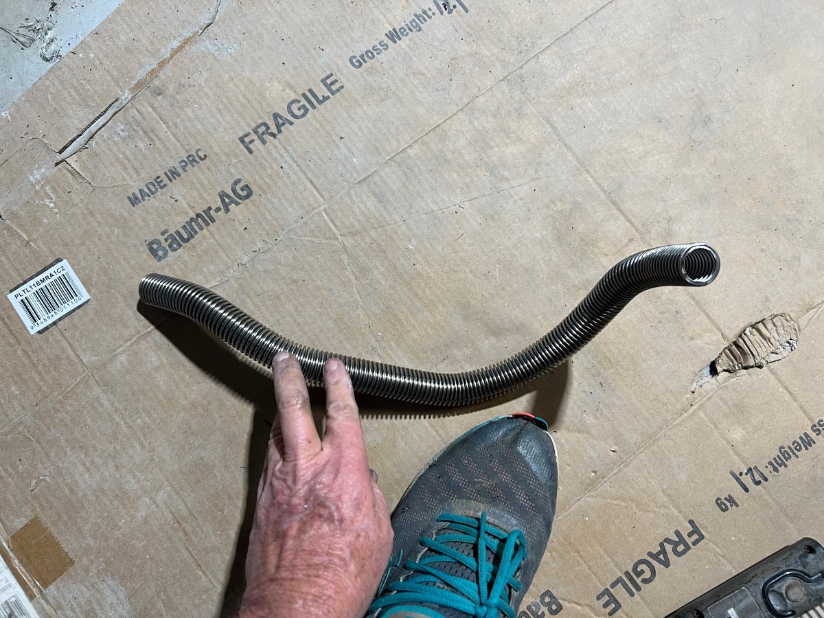

Kyle Communications Posted August 19, 2022 Author Posted August 19, 2022 Hi Marty Pacific HoseFlex..... they are in the Gold Coast and Victoria and Perth..I believe they actually manufacture it. You want the annular hose and no outside sleeve Download the chart and just be away the size is the ID. so the OD is much larger. The water pipe I used is the 20mm and the SS0-A. tube https://hoseflex.com/product/metallic-hose-annular/

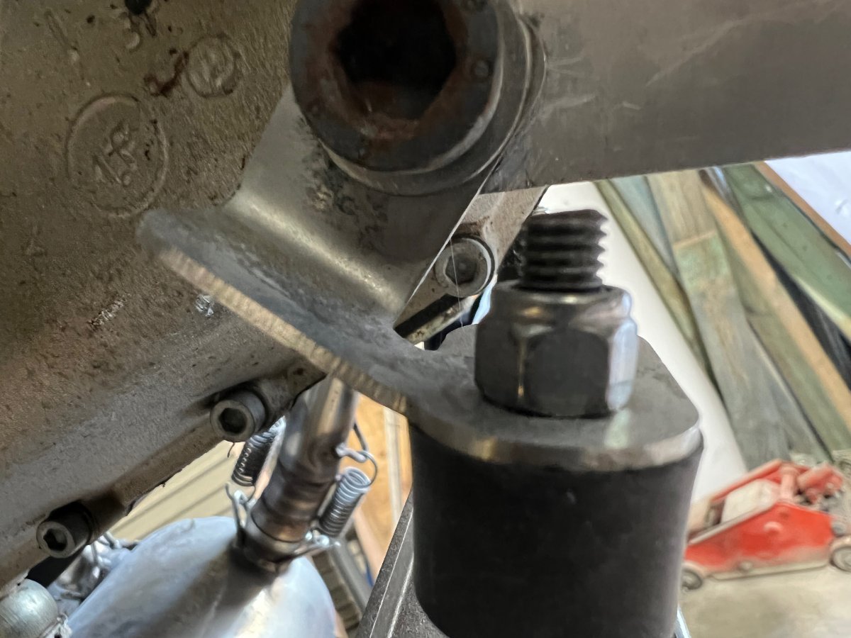

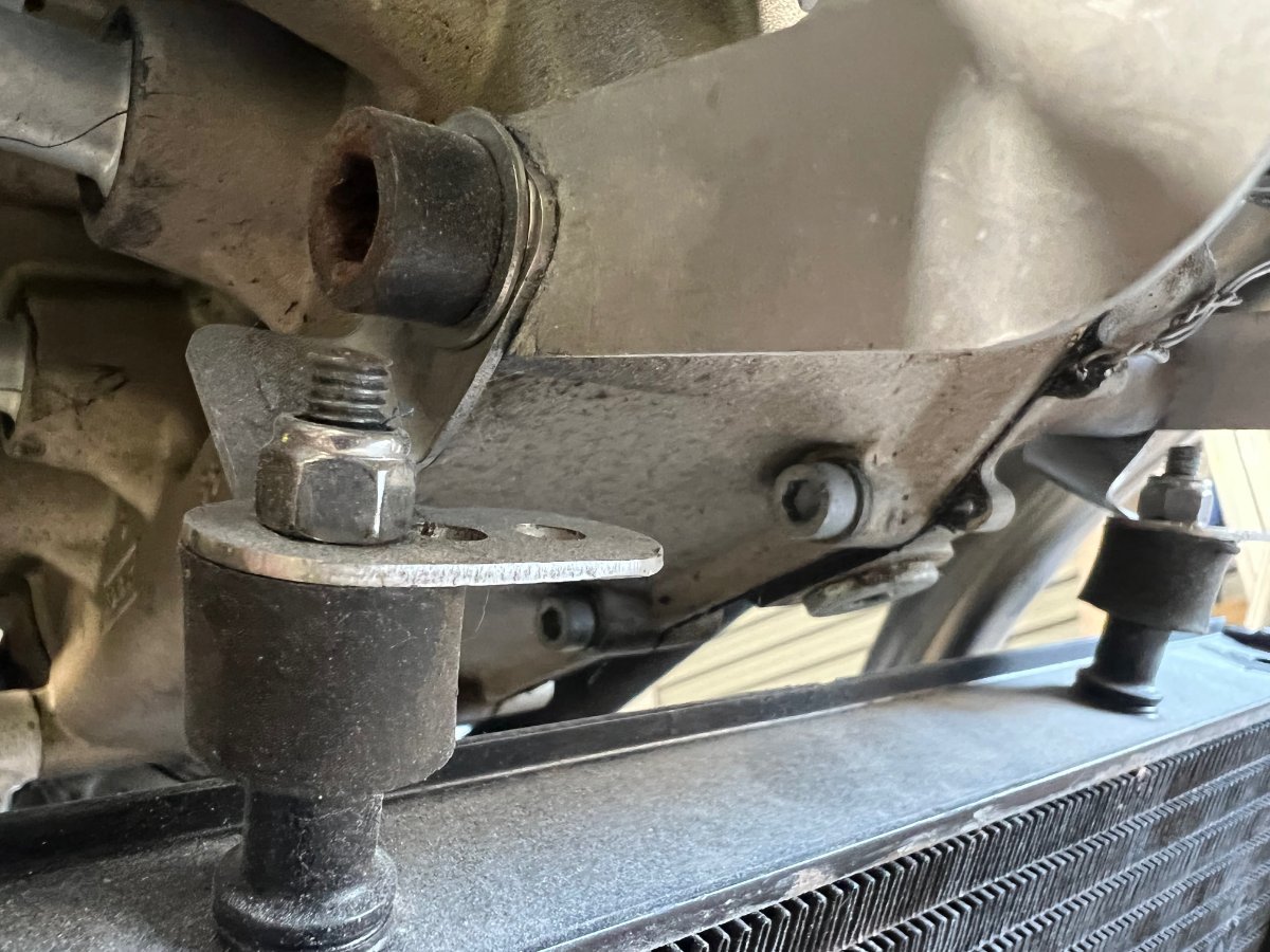

Kyle Communications Posted August 19, 2022 Author Posted August 19, 2022 2 hours ago, Marty_d said: Are you using some kind of standard mounting for the radiator or making one yourself? I used the std Sav radiator bracket which is just 2 smallish bent brackets but because my radiator is more facing forward I have 2 straps coming back to the bottom noseleg plate to achor the bottom of the radiator...I will take a pic later

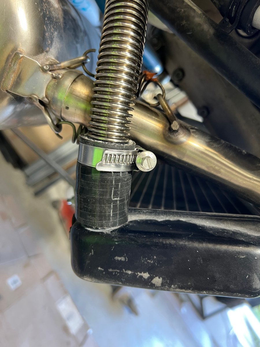

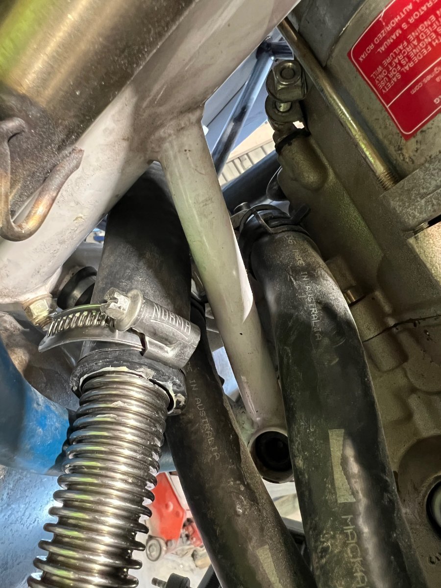

Kyle Communications Posted August 19, 2022 Author Posted August 19, 2022 Another thing about the hose...I used the 25 to 40mm clamps to grip the rubber/silicone hose to the tube..but make sure you get the 12mm wide clamps not the 9mm wide clamps..and the SS tube doesnt crush at all the clamps tighten down nicely and will make a perfect solid seal 1
Kyle Communications Posted August 19, 2022 Author Posted August 19, 2022 Still need to put a clamp on the radiator end...I am waiting for more of the 12mm wide clamps 1
IBob Posted August 19, 2022 Posted August 19, 2022 With any pipe type/diameter there is a fluid velocity point where laminar flow becomes turbulent flow, and resultant flow actually deteriorates. Lots of irrigation 'specialists' have lost the plot on this over the years: it doesn't matter how big a pump you fit, you're not going to get any more fluid through it. There are readily available online pipe flow calculators, including for this annular pipe (though I have no feel for how accurate they may be for the smaller IDs eg. 9 or 10mm as used for fuel). As you would expect in what is a corrugated pipe, the laminar to turbulent cutoff is especially sharp. 2 1
RFguy Posted August 19, 2022 Posted August 19, 2022 (edited) Bob, you beat me to it by a second... help me understand here, you are using it for fluid, or encasing a hose ? Mark, just watch out here because the Rotax flow rate is high! higher than you'd think, 65 litres per minute. I thought rotax radiator was 25mm ID on the radiator and combined flow pipes (17 on the branches) . for 20mm ID pipe, 1m long, roughness 1mm , that will be 0.21 bar pressure drop. no bends. the bend probablty costs another 0.05 bar or something. I think that is quite alot of pressure drop. - 25mm smooth is 0.03 bar drop run it up and check the flow rate you end up with. BTW- I have verified this calculated is good over a wide variety of scenarios http://www.pressure-drop.com/Online-Calculator/ Edited August 19, 2022 by RFguy 1 1

RFguy Posted August 22, 2022 Posted August 22, 2022 For other's info : 20mm ID with 1mm roughness at 1m and 65 lpm is same restriction as smooth pipe of 16mm ID. I think the important issue (apart from having enough radiator performance ) is the flow rate- for 65 litres/minute, that's *MAYBE* implying that it is important to keep the delta T across the heads low. . IE if slower flow, means higher delta T on the heads. .. and low flow in the radiator means higher delta T on the radiator. (radiator appears to do more work) . And for fast flow, delta T is low across the heads but also low on the radiator. For that flow rate for that size radiator and engine , I'd be mindful of meeting the flow requirement to minimize delta T on heads. Both will work, but depending on the flow in the heads, if the water gets a chance to get hot early (in the lower side inside the head housing) then it wont be able to remove the heat as effectively on the high side of the head. and you might get a hot spot.... If that makes sense, sort of made a mess trying to explain myself.
