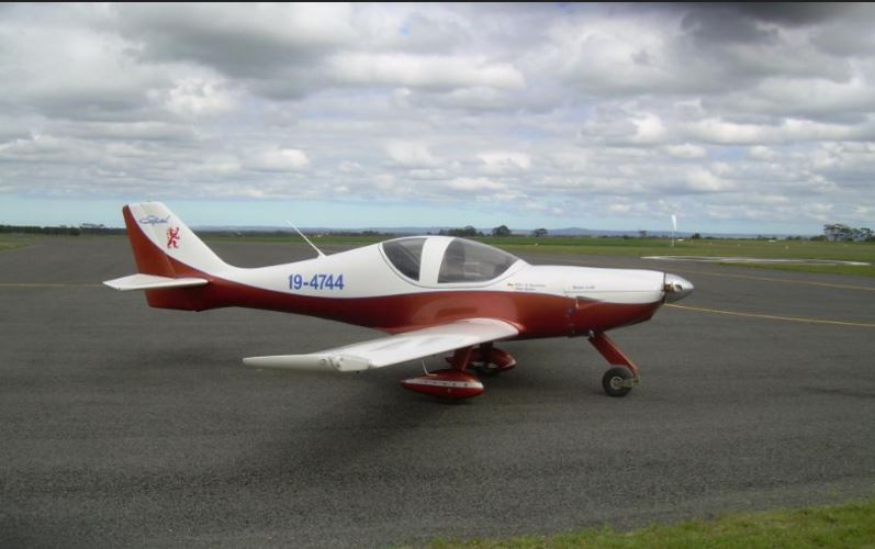

red750 Posted November 27, 2016 Posted November 27, 2016 This looks like the plane involved, rego ending 44 recently in Aviation Advertiser. 1

Piet Fil Posted November 27, 2016 Posted November 27, 2016 From the Aviation Advertiser ad ... It had a Rotax 100hp engine with around 130hrs on it.
