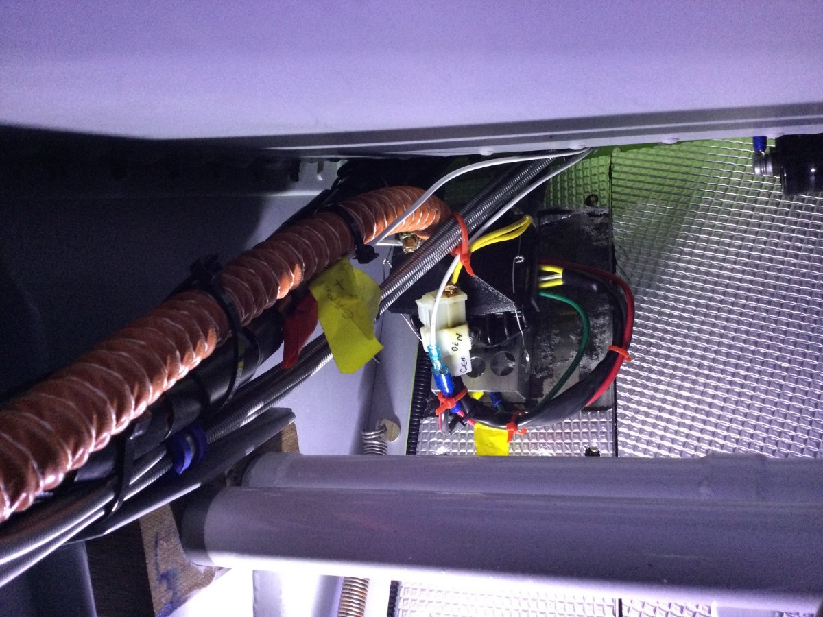

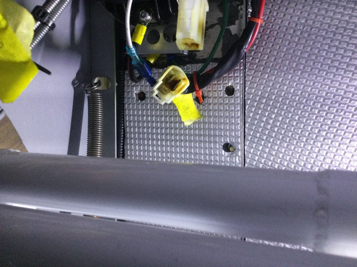

  • The wiring spade connection between Generator & VR,  significantly heat effected  (see pic)- could this be the problem?
Why did my main battery not last longer?  I think the VR must not have been charging the battery adequately, for at least the last two flights,  I somehow have not noticed (lesson learnt).
