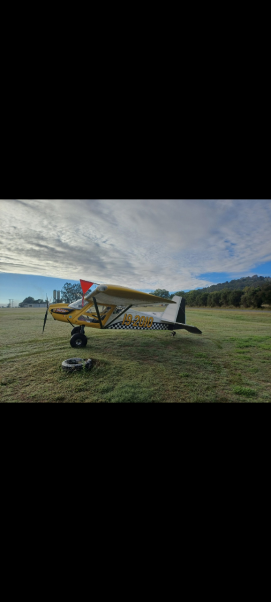

Screenshot_20260621-181051.thumb.png.eb7cf27d28a13715430bfd50650f7a11.pngScreenshot_20260621-181058.thumb.png.18f4dd481bcc878f7822d3e4b3a75071.pngScreenshot_20260621-181046.thumb.png.35fce7cf0dbd2ad5aded325f7ef51e0b.pngScreenshot_20260621-181040.thumb.png.d144ae5f3be96aa012d626d8c1251983.pngScreenshot_20260621-181026.thumb.png.0c758655074d593880c0854cc48d07c5.pngScreenshot_20260621-181005.thumb.png.52d4a87f25d0d6bdc6c1dae8f289fb4d.pngScreenshot_20260621-180957.thumb.png.c7b6af466392867584b8883aba5d5f7e.pngScreenshot_20260621-180938.thumb.png.81379d8056f7f0628a7b6fe71f8a5b62.pngIMG_20260621_180854.thumb.jpg.77fd321244a4282d39c93bc9133c9151.jpgFlight on Saturday. The usual pootle around Boonah, with passenger. Unfortunately, she started to get I'll from some exhaust fumes leaking in. I'm so used to driving bomby old cars I'm immune by now 😄. Will have to try and figure it out
