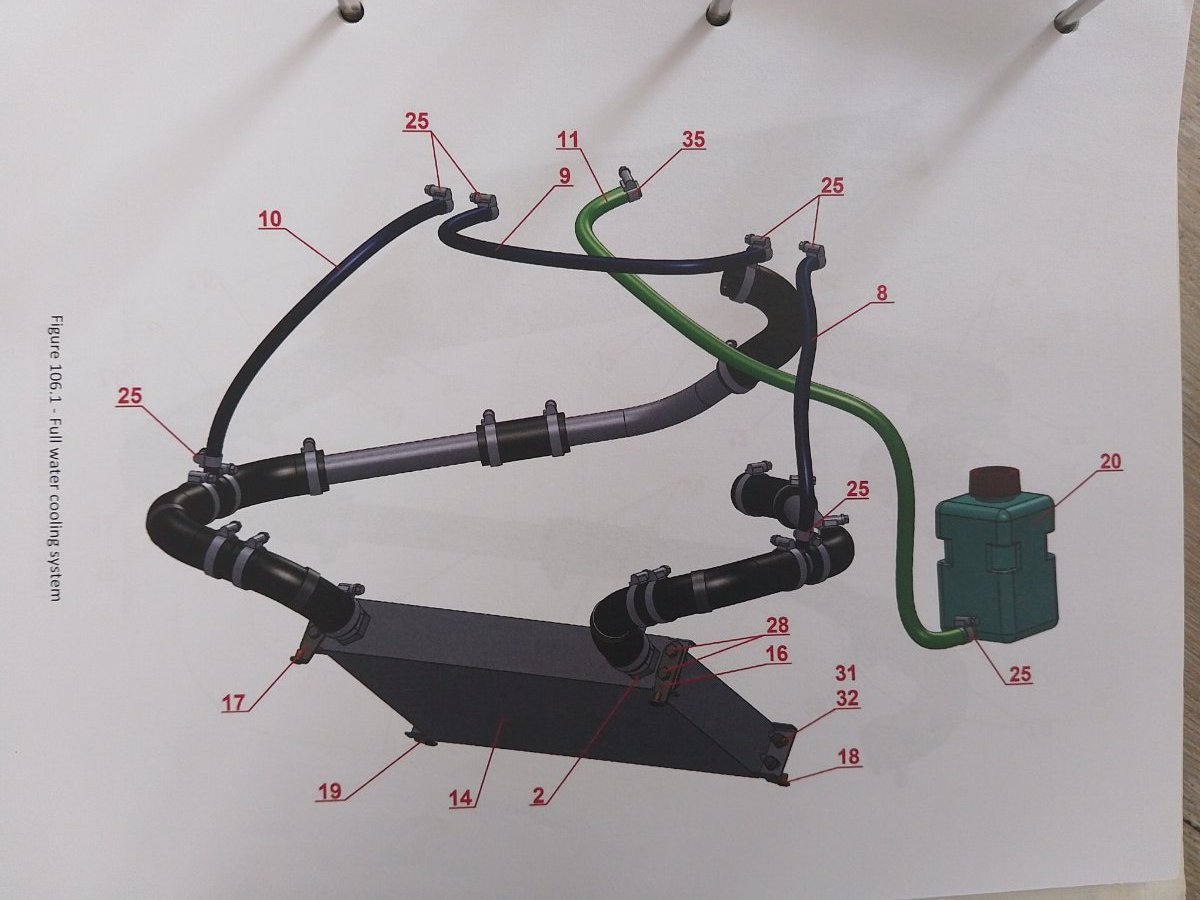

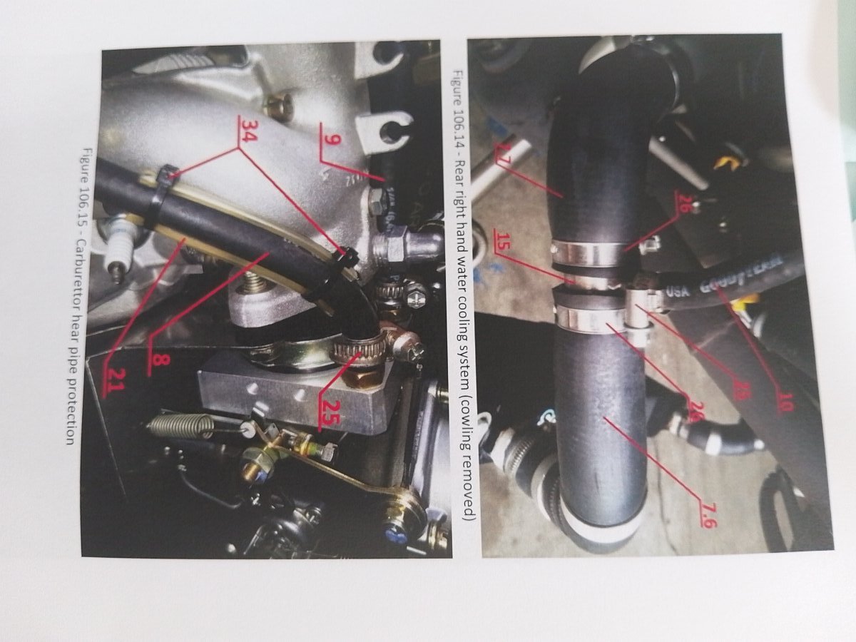

Oh, KISS applies here. See attached. the thin black hoses are the extra needed for the carb heat. Which have to splice into the main hoses. Plus I have to press fit the heating manifolds to the carbies. I am actually almost certainly going to put them on now, because despite the extra weight and complexity, they dont at least seem to rob any power. Just waiting on the kit manufacturer nowto elaborate on the loctites used. One of them in the manual is not even on loctites website. Could be a typo, but its repeated maybe 4 times. I dont wanna guess with this sort of stuff...
