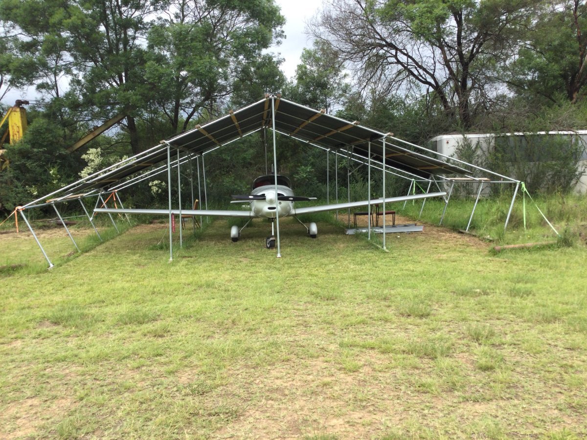

BrendAn Posted 16 hours ago Posted 16 hours ago 3 hours ago, skippydiesel said: Moneybox, Some of the figures that you are quoiting, seem way out of proportion to the value of the aircraft and the benefit that may be derived, from such a costly structure, that is unless you intend to rent space or live in it. Examples of cost effective hangers 😈 looks like you built the hangar around the plane in the top photo 1
skippydiesel Posted 16 hours ago Posted 16 hours ago 5 minutes ago, BrendAn said: looks like you built the hangar around the plane in the top photo Not mine. Front of aircraft poles, are easily removed, to get aircraft in/out. 😈 1

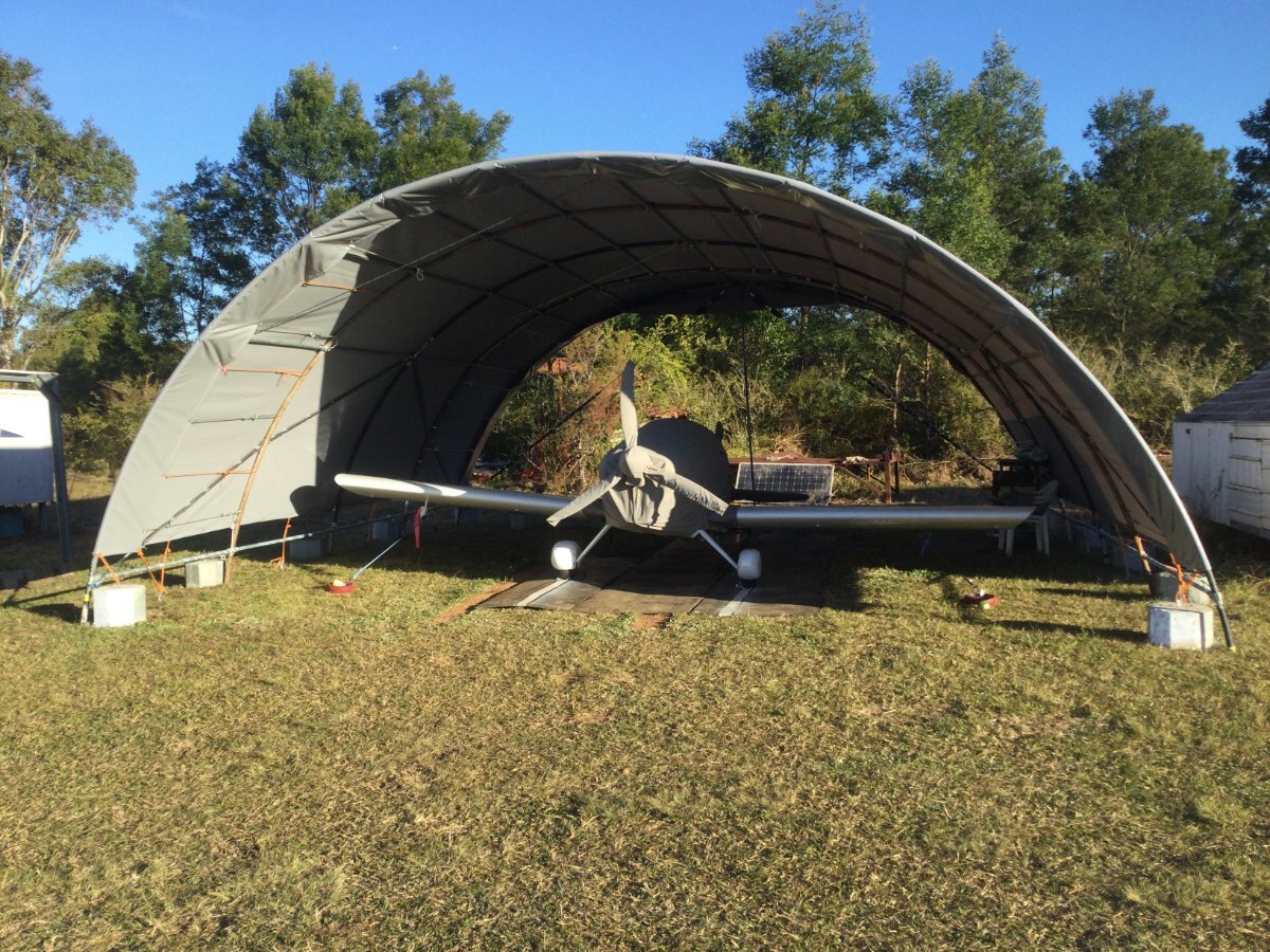

skippydiesel Posted 14 hours ago Posted 14 hours ago "A used tautliner or curtin side truck trailer side would make an excellent hangar door." One one of the reasons for the light duty structures, photos I posted, is that being open, they present little résistance to wind. Start closing them in and you will need a considerably stronger structure 😈
