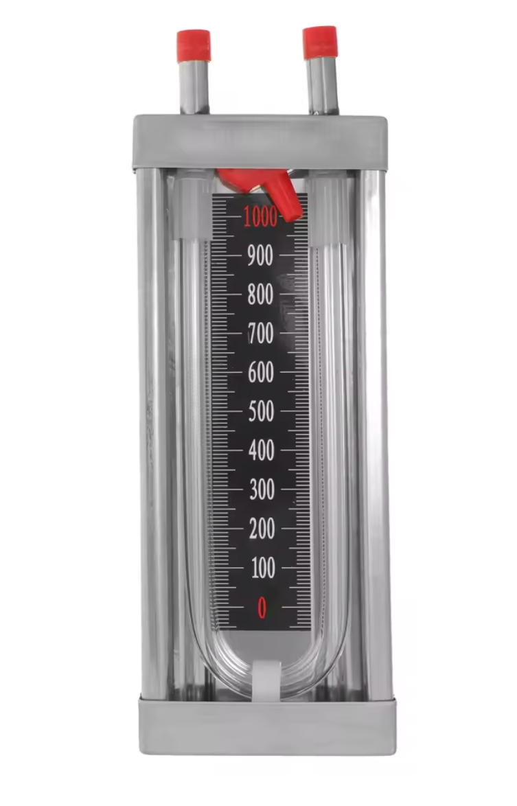

facthunter Posted 4 hours ago Posted 4 hours ago Problems are often Hard to diagnose. Sometimes only done by swapping items till the faut is corrected.. Self testing built into the system can be done. Nev 1
Blueadventures Posted 4 hours ago Author Posted 4 hours ago 8 minutes ago, BrendAn said: It's pretty rare for efi to give much trouble these days. In saying that, if you seen the Birdsnest of wiring and crap on my hks engine you would never put it on an aircraft. Agree, however I'm happy with life on my little Carby island surrounded by water. Have to be careful of the crocs, sharks and 'R is' gremlins (on the rare occasion they show their heads) and associated costs.🙃 1
facthunter Posted 4 hours ago Posted 4 hours ago A U tube connected to both sides would do that or a simple flow indicator that works in both directions. The thing you need is for the settings to remain where they are when set. Nev 1
