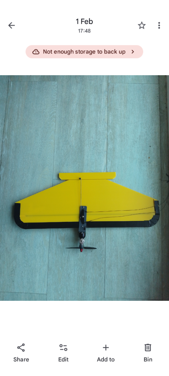

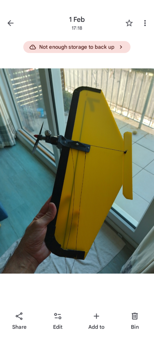

danny_galaga Posted Friday at 12:37 AM Author Posted Friday at 12:37 AM (edited) 2 hours ago, facthunter said: I don't Know if I've ENJOYED saying what I have , I've never seen an engine of that size used in control line . We considered the control lines would have too much drag. I'm interested. Don't take it as a "snob" thing as it wasn't intended as such.. Nev 049 is the classic beginners engine. But for all the reasons you imagine, they really aren't great for beginners. The reason they were so popular is price. Personally, I think a .10 is a useful minimum size for CL. My first CL model as a kid was a .15. which I still have. You aren't wrong though, since this plane (which I built over 20 years ago) isn't aerobatic it's not exactly exciting 😄. I didn't even have any other propellers to tune it. I have some now. If you think this plane is simple, wait until you see my current project 😄 We are doing a club 1/2a combat class. Made from one 3d printed mount, that I've reverse engineered (ie, stole the design) and one piece of core flute with a 3mm carbon fibre rod inserted. Took me about 1 hour to draw up and cut out 😀. Again 049. I believe the design isn't particularly aerobatic, but I've identified a few things I can improve. It has to be really simple, to get hands on handles. I just have to adjust the mount now because I didn't allow for shrinkage. Probably go about 2% larger. I'll post a pic when it's all done 🙂 Edited Friday at 12:37 AM by danny_galaga 5 1

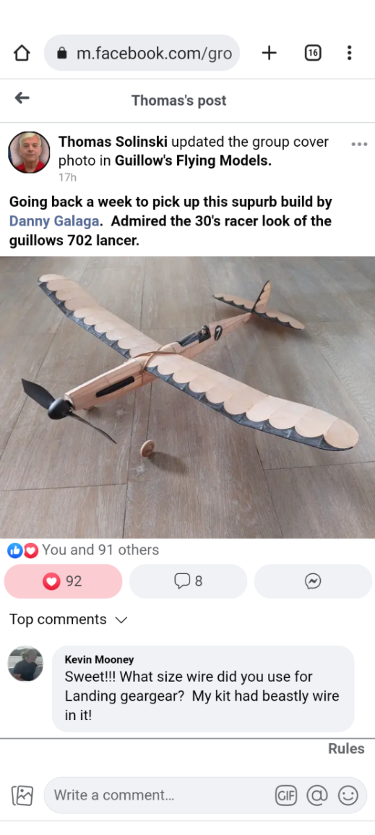

danny_galaga Posted Friday at 09:01 AM Author Posted Friday at 09:01 AM This is actually the last model I built, about three years ago. I didn't go hard core with proper FAI rubber, just the rubber in the kit so it didn't fly far or long. Just as well, I was just using a football field. I would have lost it 😄 I have much better photos somewhere, but here's a screenshot shot from FB 🙂 2 1
facthunter Posted Friday at 09:06 AM Posted Friday at 09:06 AM A good CHUCK Glider can easily get lost on a thermally day if trimmed right. Nev 1 1

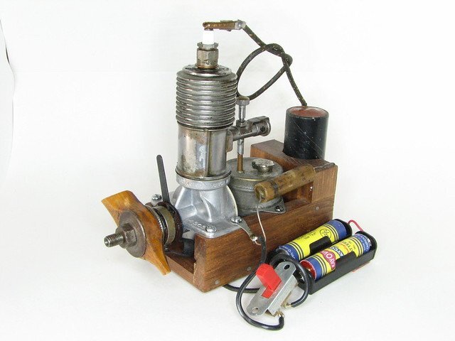

facthunter Posted 11 hours ago Posted 11 hours ago (edited) I've been looking up a lot of the MODEL engines that were made. VERY INTERESTING. recommended. I still have a Bit of what I Had but collectors persuaded me to Part with quite a Few. You need to Look after them carefully. Not good tor Run Old ones as the metal can age Harden. I know a few KEEN collectors.. One sometimes comes to the Men's shed. His FATHER built Beaufort's at GAF. Drove a car till he was 100. His Father and I used to Have LONG discussions about aircraft design and Build quality. Nev Edited 11 hours ago by facthunter

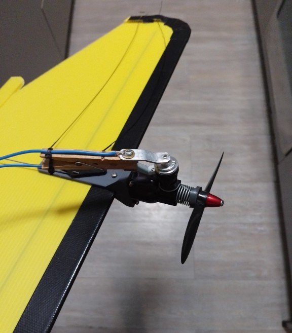

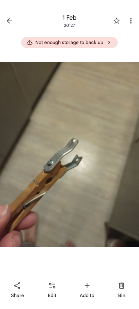

danny_galaga Posted 8 hours ago Author Posted 8 hours ago As promised, the beginner class 1/2a combat model made from core flute. The only part that is glued is the lead out guide. Engine mount is 3D printed and attached with three screws. I couldn't easily find a glow clip to suit Cox. On Lucky Lil 7 I just used alligator clips because that version is beam mounted so was easy to just clip onto an engine mount bolt. So I decided to channel the olden days and made one from a clothes peg 😊. Didn't have any handy sized wire kicking around so will finish it off during the week. 2
