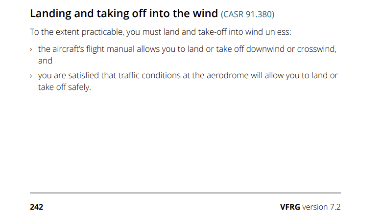

Kyle Communications Posted September 10, 2023 Posted September 10, 2023 1 hour ago, turboplanner said: There are nesting issues If SPA had used the into wind runway it wouldn't have mattered about EVR If EVR hadn't turned down his radio perhaps he wouldn't have crossed the runway Aircraft taxying for the into wind runway should have been expected etc. Who had the obligation to give way to the right etc. Different weightings at different phases. Regardless of what runway was being used. Crossing 06/24 to get to 11/29 you are required to STOP before the crossover and look. Not necessary for any radio call of crossing but the requirement like any runway crossing anywhere is to STOP and look. The radio is a secondary input 2 1
turboplanner Posted September 10, 2023 Posted September 10, 2023 16 minutes ago, Kyle Communications said: Regardless of what runway was being used. Crossing 06/24 to get to 11/29 you are required to STOP before the crossover and look. Not necessary for any radio call of crossing but the requirement like any runway crossing anywhere is to STOP and look. The radio is a secondary input I take it he didn’t stop. They’re some of the things ATSB would be going through.
