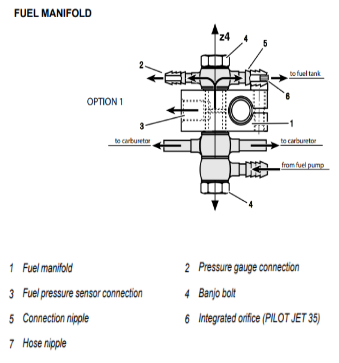

Marty_d Posted July 14, 2023 Posted July 14, 2023 Help required please... I want to create the fuel manifold as shown by the Rotax Installation Manual, (image below). Banjo bolts are easily accessible as are the fittings. They're available in M10 or M12 in various threads which I can tap myself. So all I need to manufacture is the block itself which clamps onto the crossover pipe. Essentially it's just a solid block with a threaded vertical hole right through for two banjo bolts to go into, and an unthreaded hole for the crossover pipe to go through with a small bolt to tighten it onto the pipe. Questions: 1. What would this be best manufactured from? Alloy? Any particular type? 2. What about the banjo bolts? They're available in alloy, zinc coated steel and stainless... what's best for fuel? 3. The barb for the return line to tank needs to be restricted (is it 0.35mm? The manual says "PILOT JET 35"), and the barb for the fuel pressure gauge needs to be restricted to 0.5mm. How is this usually achieved - can you buy barbs that are sealed at the end and drill them to the correct size, or is there some kind of restrictor available which seems to be suggested by 6 below? As always any suggestions gratefully received. Cheers, Marty

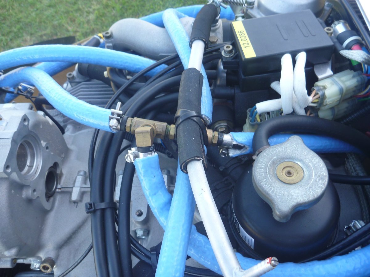

Blueadventures Posted July 14, 2023 Posted July 14, 2023 Hi Marty This is my set up a 4 way and 3 way 1/4" fittings to supply feed from fuel pump, to each carby (same length hose; important) feed to fuel pressure sensor and return (with restrictor) to starboard wing tank. Note restrictor is in a 3/16" tail so I never mix the hook up and allows using a smaller diameter hose return (lighter and cheaper:) Image shows restrictor pressed into end. Early fit-up image before sealed ends of fire sleeve. I recon the rotax item is over kill on design and good example of needing a mouse and finished up with an elephant, IMHO. Cheers. 2

Marty_d Posted July 14, 2023 Author Posted July 14, 2023 Thanks gents. So Bob - that's all brass fittings you're using? Thanks Skippy re the Mikuni jets. They seem to have an M5 thread - Bob in your photo have you pressed the jet into the end of the normal barb with the thread outward?
Blueadventures Posted July 14, 2023 Posted July 14, 2023 1 minute ago, Marty_d said: Thanks gents. So Bob - that's all brass fittings you're using? Thanks Skippy re the Mikuni jets. They seem to have an M5 thread - Bob in your photo have you pressed the jet into the end of the normal barb with the thread outward? It's Mike not Bob; yes all brass and yes pressed into, thread out and its 3/16 not 1/4 for reasons above. 1

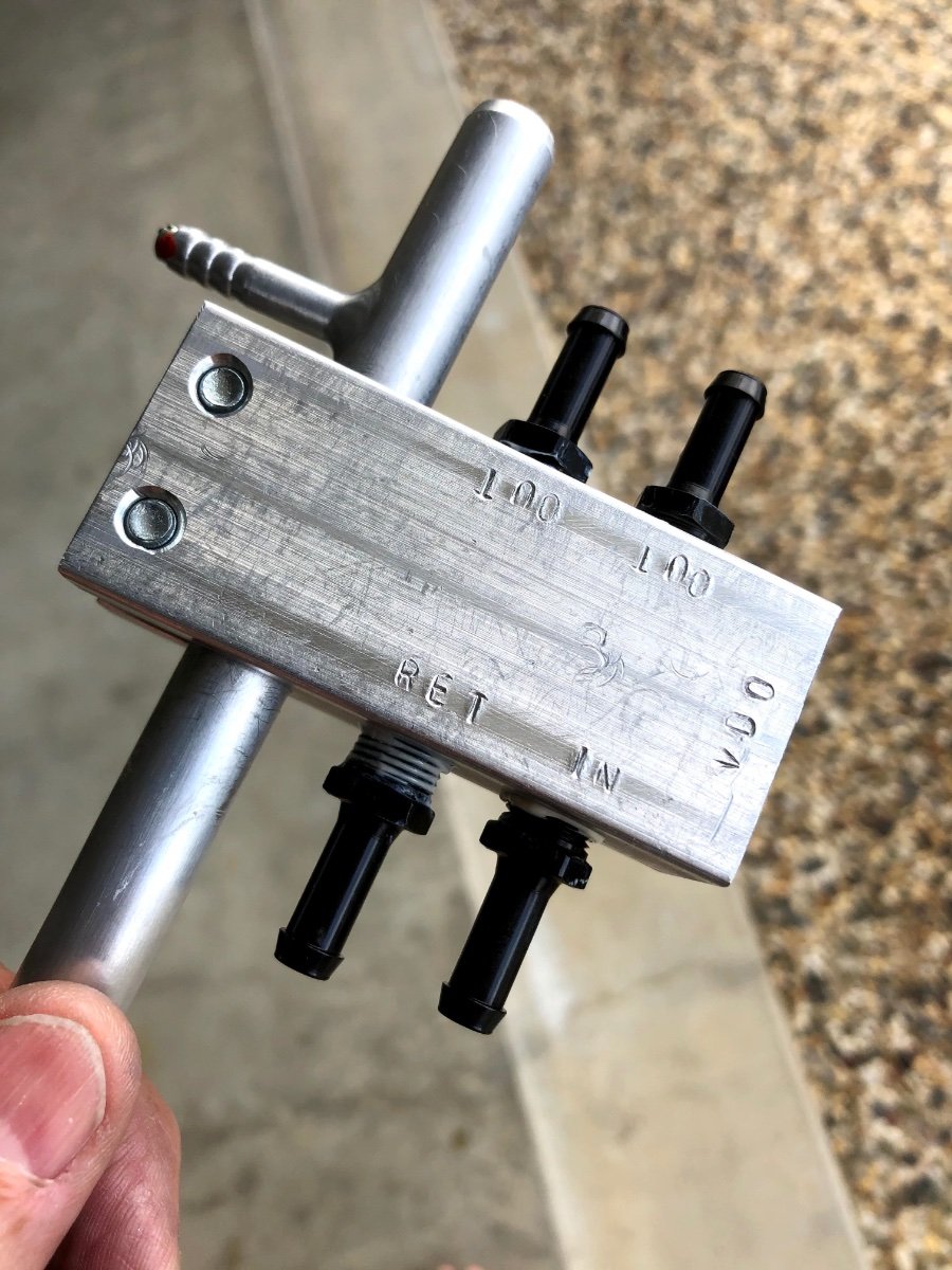

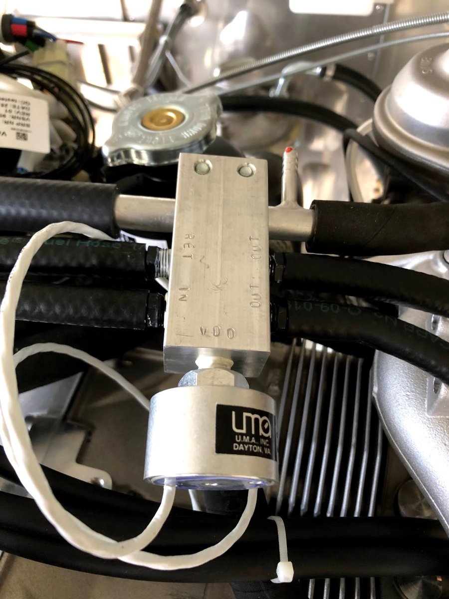

409tonner Posted July 14, 2023 Posted July 14, 2023 My Sting runs this 5 way spider type fitting with the tank return tapped for the jet to screw into 2

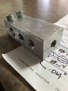

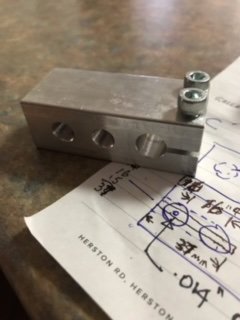

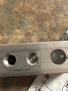

rodgerc Posted July 14, 2023 Posted July 14, 2023 6061T6….Leftover from Waiex wing attach blocks….Orifice for fuel return included in one gallery. 2
Marty_d Posted July 14, 2023 Author Posted July 14, 2023 That's very nice work @rodgerc. What's the whitish stuff on the threads?
rodgerc Posted July 14, 2023 Posted July 14, 2023 4 minutes ago, Marty_d said: That's very nice work @rodgerc. What's the whitish stuff on the threads? Loctite 567 1

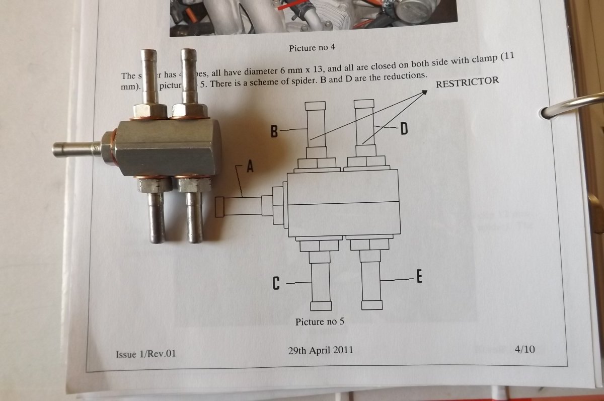

IBob Posted July 14, 2023 Posted July 14, 2023 And while we are on it: can someone point out to me where in the 912 manual it says the fuel lines to the carbs need to be identical in length? Certainly in the fuel system section it gives a set of coordinates for the fuel manifold as set out by Rotax....but if there is any note saying these coordinates are important, I haven't found it yet. I'll stick my neck further on the block: my build was done using, amongst other things, build detail pics from the then agent, which I found invaluable. Following those, my manifold is mounted where the LH upper engine mount meets the firewall, which gives a short run to the LH carb and a a longer run to the RH. And that seems to be working fine, with smoothe starts and running in all modes. 2
