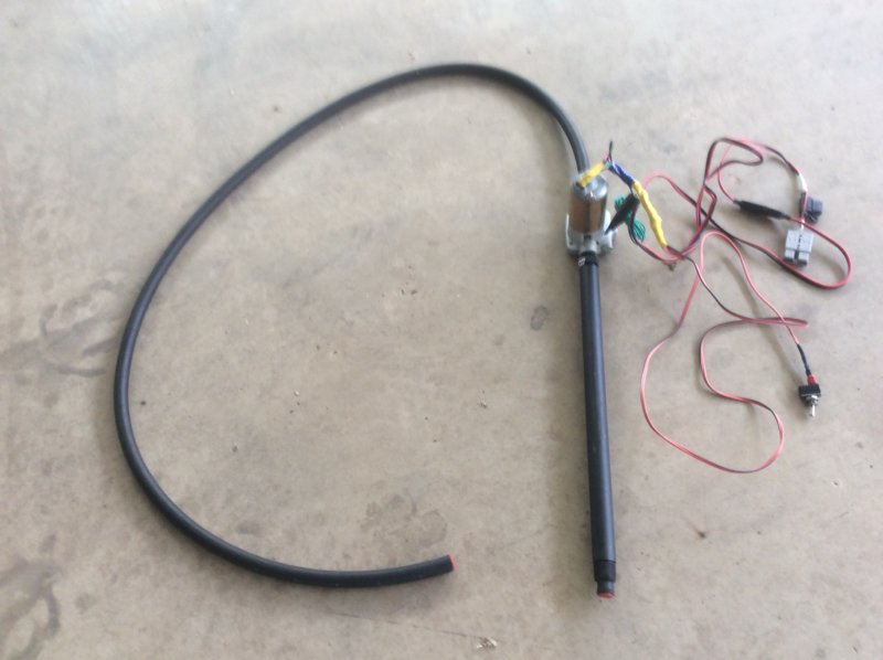

skippydiesel Posted December 24, 2022 Posted December 24, 2022 Blueadventure - I am pretty sure the Airflow is a Holly knock off and a vane type positive displacement pump - mine may not be from Airflow but is the twin of yours down to the flow rates. My set up is a bit different : my pump sits on a rigid hollow suction spike (irrigating riser) that will pump from any 20/10 L container including collapsible fuel bladders. I started with a flexible suction hose but found I needed to hold the pump in place - now it will stay in position until removed. The rigid pipe unscrews by hand for compact storage/travel. All openings have plugs to prevent contamination & any odour leakage. Like your set up, my control (shielded) switch is on a long lead allowing me to monitor inflow/level - switch off is almost instant fuel flow stop - switch on provides self priming within seconds and as you attest 20L/3.5 minutes delivery. When I started I had an in line filter on the delivery side - had a dramatic negative effect on flow rate so also like you I have always used a filter funnel to achieve best delivery with clean fuel. I can use aircraft power (through an Anderson Plug) or separate battery power through alligator clips. I have pumped both petrol & diesel with equal efficiency. Below is an old pic, the switch is now shielded, all wires to/from the pump are secured to the pump body - for the est its much the same. My apologies I miss remembered - my system is now about 4 years old. Th topic comes under "Spill Resistant Refueling" June 2018 and pretty much mirrors todays conversation.
Blueadventures Posted December 24, 2022 Posted December 24, 2022 16 minutes ago, skippydiesel said: Blueadventure - I am pretty sure the Airflow is a Holly knock off and a vane type positive displacement pump - mine may not be from Airflow but is the twin of yours down to the flow rates. My set up is a bit different : my pump sits on a rigid hollow suction spike (irrigating riser) that will pump from any 20/10 L container including collapsible fuel bladders. I started with a flexible suction hose but found I needed to hold the pump in place - now it will stay in position until removed. The rigid pipe unscrews by hand for compact storage/travel. All openings have plugs to prevent contamination & any odour leakage. Like your set up, my control (shielded) switch is on a long lead allowing me to monitor inflow/level - switch off is almost instant fuel flow stop - switch on provides self priming within seconds and as you attest 20L/3.5 minutes delivery. When I started I had an in line filter on the delivery side - had a dramatic negative effect on flow rate so also like you I have always used a filter funnel to achieve best delivery with clean fuel. I can use aircraft power (through an Anderson Plug) or separate battery power through alligator clips. I have pumped both petrol & diesel with equal efficiency. Below is an old pic, the switch is now shielded, all wires to/from the pump are secured to the pump body - for the est its much the same. My apologies I miss remembered - my system is now about 4 years old. Th topic comes under "Spill Resistant Refueling" June 2018 and pretty much mirrors todays conversation. Yes my two ends plug together after use and seal closed. Used clear tube to sight fuel emptying back down after stopping flow. Switch is in a comfortable hand grip. My images are old and will update the images. I recon that yours would be improved with a 90 degree elbow at end to improve location into fill port.

skippydiesel Posted December 24, 2022 Posted December 24, 2022 11 hours ago, Kyle Communications said: I I am thinking though of some sort of pump. They have some fuel type ones now that are like a stick and you drop it into a drum..but you really still need to decant it via the Mr funnel. mogas and a pump is coming to our airfield soon so that will make life easier When I did my research for the build of the Skippy Mk2 (2018) you could get in tank fuel pumps that would fit through a standard jerry can fill point BUT the flow rates were no where near what I have now. 1 1
skippydiesel Posted December 24, 2022 Posted December 24, 2022 13 hours ago, Blueadventures said: .................... I recon that yours would be improved with a 90 degree elbow at end to improve location into fill port. May be but my experience is that the flow rate is so vigorous, it takes a human guidance to prevent spillage from the funnel. 1 1

trailer Posted December 25, 2022 Posted December 25, 2022 15 hours ago, skippydiesel said: My set up is a bit different : my pump sits on a rigid hollow suction spike (irrigating riser) that will pump from any 20/10 L container including collapsible fuel bladders. I started with Would a 1a push to talk switch be okay to run this setup? I really like it as a solution. The ptt style switch would be useful if I dropped the switch or preventing overfill fumbling with the off switch.

skippydiesel Posted December 25, 2022 Posted December 25, 2022 (edited) 1 hour ago, trailer said: Would a 1a push to talk switch be okay to run this setup? I really like it as a solution. The ptt style switch would be useful if I dropped the switch or preventing overfill fumbling with the off switch. Any make & brake will do the job. Not so sure about the suitability of a 1A. JayCar has a good selection of switches including "Momentry" toggle type 20 Amp. Safety is the key concern - make sure the switch is fully sealed and always use a fuse. Edited December 25, 2022 by skippydiesel

trailer Posted December 25, 2022 Posted December 25, 2022 On 24/12/2022 at 7:57 PM, skippydiesel said: my control (shielded) switch is on a long lead allowing me Skippy, a stupid question, but how do you shield a switch in this application?

skippydiesel Posted December 25, 2022 Posted December 25, 2022 10 hours ago, trailer said: Skippy, a stupid question, but how do you shield a switch in this application? As a simple farmer(retired) my understanding is the danger is the combination of fuel vapour & a spark resulting in ignition. Separating the two components, will prevent or at least minimise, the chance of ignition, is the way to go. The only practical things you can do about fuel vapour, are minimise spillages (good equipment & technique) and have plenty of fresh air (hanger doors open or move aircraft outside). As for the spark (when you switch off/ on); I would start with a good quality (terminals/mechanism may not wear so rapidly, have strong positive action, be of generous proportion and thus minimise arcing/spark) switch with more than required amp rating and if available sealed (as in prevention of fuel vapour entry) mechanism. If unable to find a factory sealed switch the next best thing is to coat/wrap as much of the switch body as you can. Coating with paintable insulating (rubber) material is probably the best followed by carefully applied insulating tape. A button style switch could be completely sealed with a flexible membrane over the button. Its probably not possible to completely seal a toggle type switch. As an added precaution I keep the switch in my left hand (I am right handed) away from the exposed fuel. Note: All of the observations/advise are without any technical research or training in the field - just seem to me to be a good idea. 1 1
RFguy Posted December 25, 2022 Posted December 25, 2022 The F15 Mr funnel was a bit over a hundred dollars from memory. not a big price tag...... Use a collar of 6" PVC pipe to have it sit square and stable. You need IS grade switches, or a solid state switch. or the switch a long way upwind of each end of the fueling . A switch potted inside a box should be OK. Absolutely NO 'figure 8 ' cable (bonded along a centre line) , and no multicore cable without stainless steel braid and appropriate specifications. Fuse has to be IS rated or encapsulated also.... Consult AS/NZS 60079 part 11. ......part 14, 18 and part 31 are also applicable. (yes I do this for a living) https://law.resource.org/pub/in/bis/S05/is.iec.60079.11.2006.pdf 1 1
