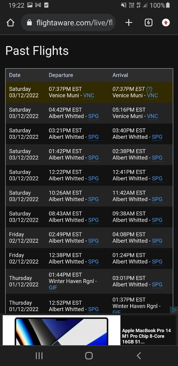

Bosi72 Posted December 11, 2022 Posted December 11, 2022 It appears the Cherokee was well utilised. It was the 7th flight on that day. https://flightaware.com/live/flight/N4676F 1
