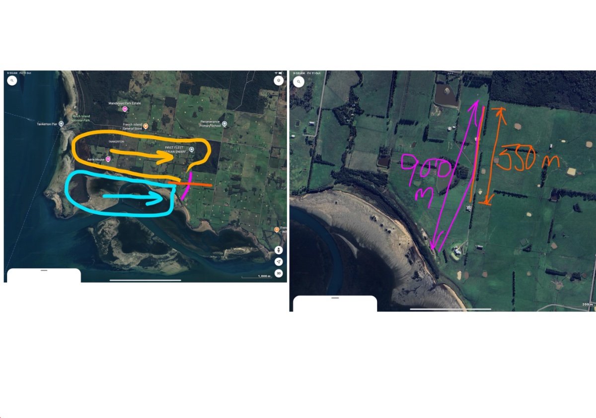

Mike Gearon Posted October 11, 2024 Author Posted October 11, 2024 1 hour ago, facthunter said: A small hill or some trees won't stop a wind but will modify it.. Usually makes it more turbulent.. Nev True. But I’m very sure of what’s happening here. I’m living it. The blue area has virtually no protection from westerlies. As you go up the hill it changes quite dramatically. The whole orange shaded area is low hills and trees. Other bonus of the extension is there is nearly a km to sort where the cape barren and water hens are to land before or after them. Useless buzzing them with low passes. They ignore the aircraft. I’ve been flying here long enough that a number of them will have been born in the runway area and grown up with the big noisy bird as normal. I’ve made landings where the pair ahead of me as I slow down don’t move at all. I have go around them. Makes juggling the idiosyncrasies of a tail wheel even more interesting. 1

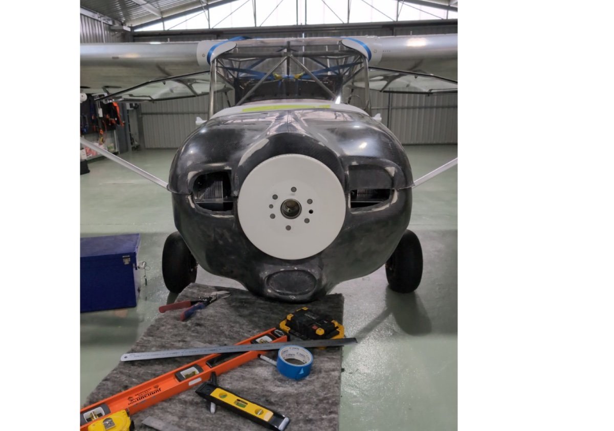

rodgerc Posted October 11, 2024 Posted October 11, 2024 Given the amount of heat you’ll be managing with that big ULPower engine, have you considered adding the Coandra exit fairing and cowling lip that other S-21 (and RV) builders have resorted to, before your first flight? Since the clecoes are still in your lower firewall, it might be easier to do before riveting and painting. 1
Mike Gearon Posted October 11, 2024 Author Posted October 11, 2024 Wow, that’s a good idea! I know just enough to understand that it’s that exit air that’s most important if the inlets are sized okay. That and the air is ramped up on the inlet and not leaking anywhere/ everywhere. I believe the plan is to do the minimal and then test. Pic here from today. We are choosing if the spinner area should be lowered or lower the top cowling and raise the inlets. The cowling provided from UL USA obviously needs a bit of massaging.

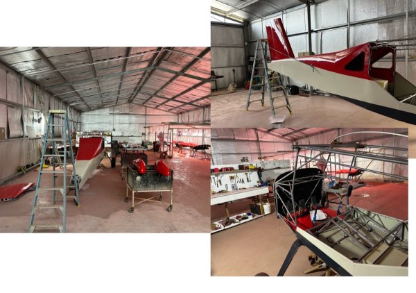

Mike Gearon Posted November 5, 2024 Author Posted November 5, 2024 (edited) Update Aircraft 1 We hope to be flying today. Test pilot visiting and if all go we fly. We are higher temp on cylinders 3 and 4 on high rev taxi so this could influence our decision making. Nic was very certain we wouldn’t have a vacuum explosion when vacuuming out the tanks with a little gas in the bottom. Thankfully he was correct. I must admit I was a little chicken and stayed back out of shrapnel range. Aircraft 2 I had a moment where deep red seemed the modern option looking at the latest car colors. Returned to a more traditional fire engine red. Which red is better? I still don’t know 🙂 We are thinking of leaving the wings off aircraft 2 and maybe even the wheels to make interior/ avionics easier to work on. Sit the fuselage on a box about half what it’d be on wheels and no climbing over wheels or ducking under wing to work. Only disadvantage I can see is it won’t be looking as finished and exciting as sitting on wheels with wings on. little yellow balloon stayed up for 24 hours on 1 wing tank without deflating. Made it through 6 hours on tank 2. No visible leaks with soap test so I think okay. No proseal used between gasket and tank. Proseal between gasket and wing skin. Edited November 5, 2024 by Mike Gearon 2
sfGnome Posted November 6, 2024 Posted November 6, 2024 My beloved gets to choose our car colours, and her choice is normally red. However, her current car is white because she hated the ugly dark reds that seem to be the only option these days. Definitely a vote for nice bright fire engine red! 1
Mike Gearon Posted November 6, 2024 Author Posted November 6, 2024 10 hours ago, sfGnome said: My beloved gets to choose our car colours, and her choice is normally red. However, her current car is white because she hated the ugly dark reds that seem to be the only option these days. Definitely a vote for nice bright fire engine red! Glad to hear that. I’ve also seen dark gray in the new car pool. It’s a really popular option. I can’t understand that one at all. Should aircraft builders follow color fashion? I think it was peer group pressure driving down the road and seeing the dark reds one after another. The decider was when I was reviewing old pics and came across this one. Contrast between the inner and outer wasn’t going to work well. Also, I’d put a fair bit of work into the interior paint. Blasting it deep red didn’t seem right. Wing painting today.

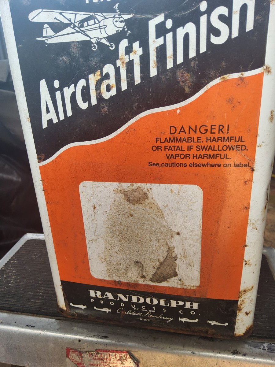

spacesailor Posted November 6, 2024 Posted November 6, 2024 A query on !. Were to donate aircraft paint/thinners . As I have a couple of old cans to go . As you can see . No label. spacesailor
facthunter Posted November 6, 2024 Posted November 6, 2024 Use it to remove sludge etc from the innards of old engines. or to remove grease and wax prior to painting. Nev

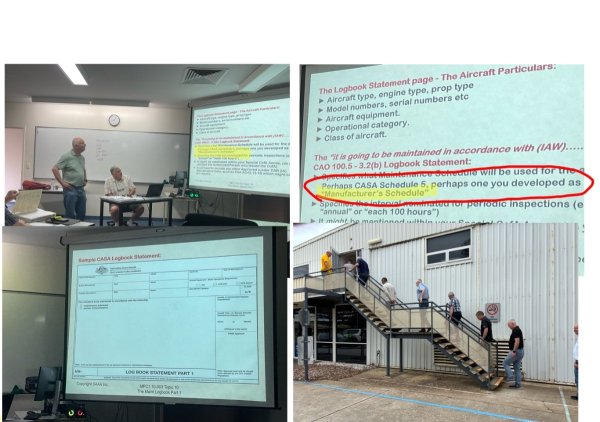

Mike Gearon Posted November 29, 2024 Author Posted November 29, 2024 SAAA Maintenance course. Adelaide at Parafield. Norm, Greg and Martin presented. Must complete this course to sign off annual. Also involves about 3 hours of online exam. Even open book it takes time. First day is a lot of regulations and it’s extremely difficult to stay awake. Norm did his best to make it lively and I don’t think it could have been presented better. The side detours to aircraft war stories make it much more interesting and I think we really benefit from those decades of experience. Second day is a bit more hands on but we don’t get greasy hands. Just writing up info as if we are doing actual maintenance logs. I get it. We become the Lamie/ A&P. It’s a bit like radio calls with who we are, where we are and what we are going to do. In this case it’s roughly….. Why we are qualified to do it. What reg we do it under. Why we are doing what we are doing. What we are doing/ replacing the thing and what maintenance info we referred to. Biggest benefit of doing all this properly is our own reference and a secondary but I ortant consideration is that the aircraft is worth more to sell if the records look good. So, in conclusion it’s a big hassle but worth it! Aircraft 1 is still about to fly, maybe next week. Aircraft 2 is starting to move along. Brake lines, header tank and fuel lines in. Controls mostly complete. Painted most surfaces and tail feathers and engine possibly on next week. 5

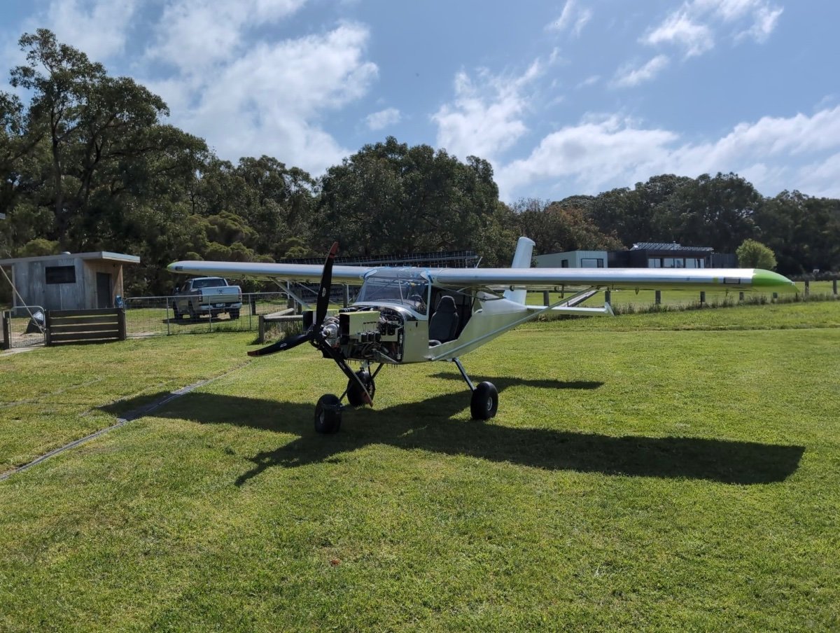

Mike Gearon Posted January 14, 2025 Author Posted January 14, 2025 (edited) Finally I can report on the S21 with UL520t We have 140kn TAS cruise at 2700rpm 1500ft. We also have stable oil and CHT temps. Game changer was talking to Steve at Sensenich this morning. We moved 2 degrees past the maximum gauge setting of 7. Each gauge is .7 degrees. So, we are at a ten. Static is 2150rpm and as you’ll see in video it’s almost spot on 2700max in the air. About 2300climb out max rpm. So, we’ve gone from a frustrating overrevving overheating 115k aircraft to the aircraft we thought it should be. Up high TAS? Maybe 150kn. Pity the American and Australian UL distributors aren’t more personable. The Australian guy suggested we f&$k off when we first visited. That should have been the red flag we ignored. The American guy is nicer with communication problems. UL Europe and UL Dutch guy in Florida USA are really good so it’s not all difficult people Edited January 14, 2025 by Mike Gearon YouTube 4 1
RFguy Posted January 14, 2025 Posted January 14, 2025 Mike, any reason this aircraft didnt get a CS /IFA prop ? particularly suited to a turbocharged engine? DOes it operate boost (>30") or is it pressure normalizing ? Seems like takeoff engine power left on the table with low static RPM.....
Mike Gearon Posted January 14, 2025 Author Posted January 14, 2025 4 hours ago, RFguy said: Mike, any reason this aircraft didnt get a CS /IFA prop ? particularly suited to a turbocharged engine? DOes it operate boost (>30") or is it pressure normalizing ? Seems like takeoff engine power left on the table with low static RPM..... There was an airmaster 4 blade on an S21 that broke a crank. It looked like a monster blade assembly. We didn’t want to go the same way just in case. There were a number of circumstances around that crank break such as a very hard landing and some other unusual things went on. I’ve personally been against a CSU based on the RV6 I fly. I could leave it at 2400RPM and it’ll still take off and climb at some 1500fpm then cruise up high at 170kn. Only reason for the CSU in that aircraft I can see is aerobatic or perhaps short runway/ obstacle performance. However, this morning was an eye opener. We were maxed out at 2350rpm on take off and climb then finally levelled out it started to get longer legs and the rpm and speed climbed. So, yeah… maybe a CSU is possible with reference to concerns over the aircraft that had the crank break. That aircraft now runs a 520 non turbo. another “however”… Steve, the Sensenich guy said he’s considering running a smaller dia prop of say 74” against the 79.5” we have and working his magic with taper, twist etc. Sensenich are one of the manufacturers who are willing to work hard at getting it right. He said the Rans S21 is a real challenge with its speed envelope between stall and high speed. 2 1
RFguy Posted January 14, 2025 Posted January 14, 2025 that's the thing- speed envelope... if you have plenty of power and runway, tune for top end.... no need for a CSU.... . how many ml/nm at 140k TAS ? (lph / TAS) as for the busted crank, could be anything. but one needs ot be careful of the situation of having a heavy weight at both ends of the crank. 520 manual says "Propellers with a Rotational Moment of Inertia of up to 0,8kgm² have been used with no known problems" whatever that means... The airmaster https://www.propellor.com/ap533hctf-snr67je says it's 0.5kg.m2 But ya dont know about the possible harmonic behaviour without some instrumentation attached.... I'd go with a 3 blade. and put some vibration instrumentation in xyz on the crankcase. 1

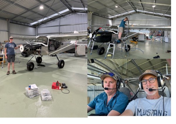

Mike Gearon Posted January 14, 2025 Author Posted January 14, 2025 Aircraft 2 has the engine mounted and avionics are near finished. Nic is a work maniac as I think I’ve mentioned. I have to get down to hangar by 7am or he’s beaten me to it. I take a break at lunchtime and a little siesta then comeback and often Nic is still there and worked through. I don’t think he’ll be back for the more mechanical stuff and he’s a bit over the avionics and just wanting it finished. Still, I appreciate the help and very grateful he’s giving me time. Deb is top left. She’s lost 50lb last 4 months (American so she loses lb’s). Only started flying with me recently and happy to come into Tyabb but not so keen on the island runway landings between trees, birds, cows and the uneven ground. She’s surprised herself by looking forward to the Rans being finished and going on adventures. It’s heaps more comfortable than the RV. The seats are like armchairs in comparison and the big tyres make my runway feel smooth. Those things along with the slower landing speeds will really help her confidence in flying with me. Job today is antennae’s so Nic doesn’t run out of things to do. Then onto wiring the light speed ignition in. After that the big jobs are wings on (we learned from first aircraft… don’t put the wings on early. They are just in the way) then skylight, windscreen, prop and engine cowl. After that it’s flying and trying to keep up with Nic. 3
