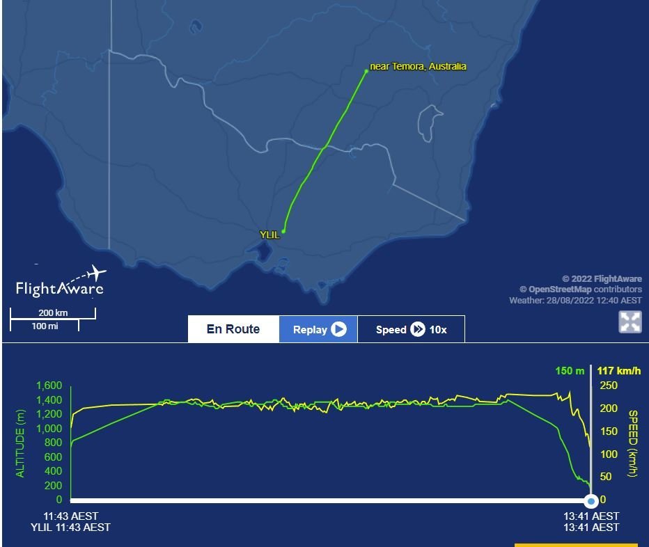

RossK Posted August 29, 2022 Posted August 29, 2022 Took the new SE2 to Temora for the weekend. Had plenty of battery for the trip up and back Below is the track log from FlightAware for the trip home. 3 1 1
