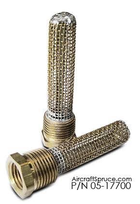

Thruster88 Posted May 31, 2021 Posted May 31, 2021 Another difference I see between certified and RAAus type aircraft is fuel tank finger strainers. Certified aircraft always have them and we check some depending on the system of maintenance. I fitted one to the thruster many years ago after a piece of my farm machinery suffered a blockage at the fuel outlet. In the case of the tecnam the blockage was not at the fuel tank but may have originated from a tank. 5 2
KRviator Posted May 31, 2021 Posted May 31, 2021 The RVs have an even simpler one, a piece of standard fuel tubing. Bent to sit a bees d!ck off the bottom of the tank, a flared fitting on one end, squashed flat at the other, with a series of thin hacksaw cuts partway through it. I couldn't imagine anyone flying without something to catch the bigger contaminants before they reach (and/or) block the filter. 1 1

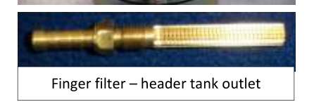

RFguy Posted May 31, 2021 Posted May 31, 2021 I fill using the dual filter funnel, and very careful that the funnel itself is super clean. Ya know when working on water pressure sensors in dams and ponds, the tiny breather holes got filled up with tiny snails. Howover, I will retrofit the Jabiru with some sort of broad mesh as to catch whatever could clog down stream. ideally, meshes need to be progressively finer as to prevent a single orifice blockage soemwhere down stream. 1
Old Koreelah Posted June 1, 2021 Posted June 1, 2021 56 minutes ago, RFguy said: ... I will retrofit the Jabiru with some sort of broad mesh as to catch whatever could clog down stream. ideally, meshes need to be progressively finer as to prevent a single orifice blockage soemwhere down stream. I thought they were standard in Jabs. I fitted a pair of finger filters (like those in T88’s post) taken from a Jab kit.
Jaba-who Posted June 1, 2021 Posted June 1, 2021 5 hours ago, RFguy said: I fill using the dual filter funnel, and very careful that the funnel itself is super clean. Ya know when working on water pressure sensors in dams and ponds, the tiny breather holes got filled up with tiny snails. Howover, I will retrofit the Jabiru with some sort of broad mesh as to catch whatever could clog down stream. ideally, meshes need to be progressively finer as to prevent a single orifice blockage soemwhere down stream. Finger strainers are standard in Jabs 1 1
RFguy Posted June 1, 2021 Posted June 1, 2021 (edited) And there is it- it's behind the header-tank outlet barb. so that's where it is. Despite my Jabiru company related engine troubles, I will be sticking with the airframe. Edited June 1, 2021 by RFguy
Jaba-who Posted June 1, 2021 Posted June 1, 2021 2 hours ago, RFguy said: And there is it- it's behind the header-tank outlet barb. so that's where it is. Despite my Jabiru company related engine troubles, I will be sticking with the airframe. There are also similar ones in the main wing tank outlets. At least in mine which is a 2006 model J430. I remember installing them in the tanks when I built it. So all up there’s at least three. 1
Old Koreelah Posted June 1, 2021 Posted June 1, 2021 Removing them from the tank to clean off accumulated debris is pretty easy; you just need the correct-sized replacement O-ring.
RFguy Posted June 1, 2021 Posted June 1, 2021 (edited) Yeah when I want to know "what is behind" I go to the Jabiru constructor's manuals for photos.... Edited June 1, 2021 by RFguy
