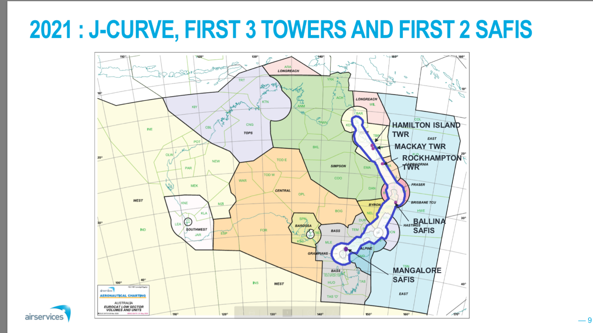

bizwise Posted January 28, 2021 Posted January 28, 2021 The ASA presentation gives a map of the East Coast showing the airspace J Curve from Melbourne to Cairns that is being discussed.
