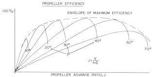

RFguy Posted August 19, 2021 Posted August 19, 2021 Of general interest of propellors, is how peaky the maximum efficiency point is. IE- Does the prop have a very steep fall in efficiency beyond max efficiency screw speed ? Does the prop trade a fast fall on the high airspeed side of peak efficiency for a gentle rise on the lower side ? Those things are more important than you'd think, much more beyond the basic equation of best prop speed = (RPM x pitch) / 1215 curves like this or taking some of the info away 1

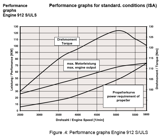

RFguy Posted August 21, 2021 Posted August 21, 2021 (edited) There isnt much extra power for the 5500>5800 RPM segment. Beyond 5500 you are over the top of the torque curve and the engine starts running out of breath. I'd consider the region 5500-5800 to be 'temporary operating headroom' against over-speed. (IE your 5 minutes) Mark, I wonder if the narrow E prop has a lower drag when stopped compared to the wide blade ?. Of course it looks that way but frontal area of course is only 1/3 of the story ! Edited August 21, 2021 by RFguy

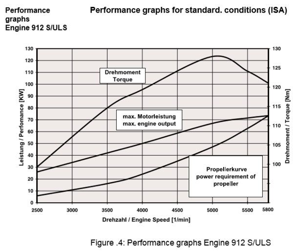

RFguy Posted August 22, 2021 Posted August 22, 2021 (edited) SKippy - ROTAX say that is a MINIMUM OF 5200 @ STATIC RPM ( WOT of course). Edited August 22, 2021 by RFguy 1 1

RFguy Posted August 22, 2021 Posted August 22, 2021 (edited) Skip, et al. At the end of the day, there is always going to be a compromise with a fixed prop. a) If you pitch for 5500 static, - beyond the peak torque point, it's likely to be 5650-5700 once you are at established in climb . You have 5 minutes like that, before you must reduce power. There's very little power increase beyond 5500 because of the falling torque .. This also means you are likely unable to fly WOT in S&L, since you will certainly overspeed, and there isnt much point because the extra engine output is minimal So from that point of view pitching at 5500 would seem a good option for a STOL machine that never goes very fast and every ounce of HP should be reamed out of the engine for the TO, Or you need to be fairly active with engine throttle control as not to exceed the ratings. = Lots of attention !!! b) now if you pitch for say 5300 static, that might be 5500 in established climb, that's max continuous, you can just keep climbing like that and not worry about being active on the throttle / RPM management . Not a bad scenario. You have given a bit away in TO power for ease of operation and attention margin . Likely WOT will be in the 5500-5800 region in S&L. But you don't fly that often like that eh ? Enter the in flight adjustable. (not strictly a CS prop, but I rpesume there is some overspeed limit in there), I specifically reference in-flight-adjustable. Now, you can have it all ! you can pitch for 5500 static and just hold the engine right on the continuous limit with pitch adjustment, not worry about the 5500-5800 region - the system only uses it to avoid been excessive on the control loop. Skip, you know you want it. Edited August 22, 2021 by RFguy

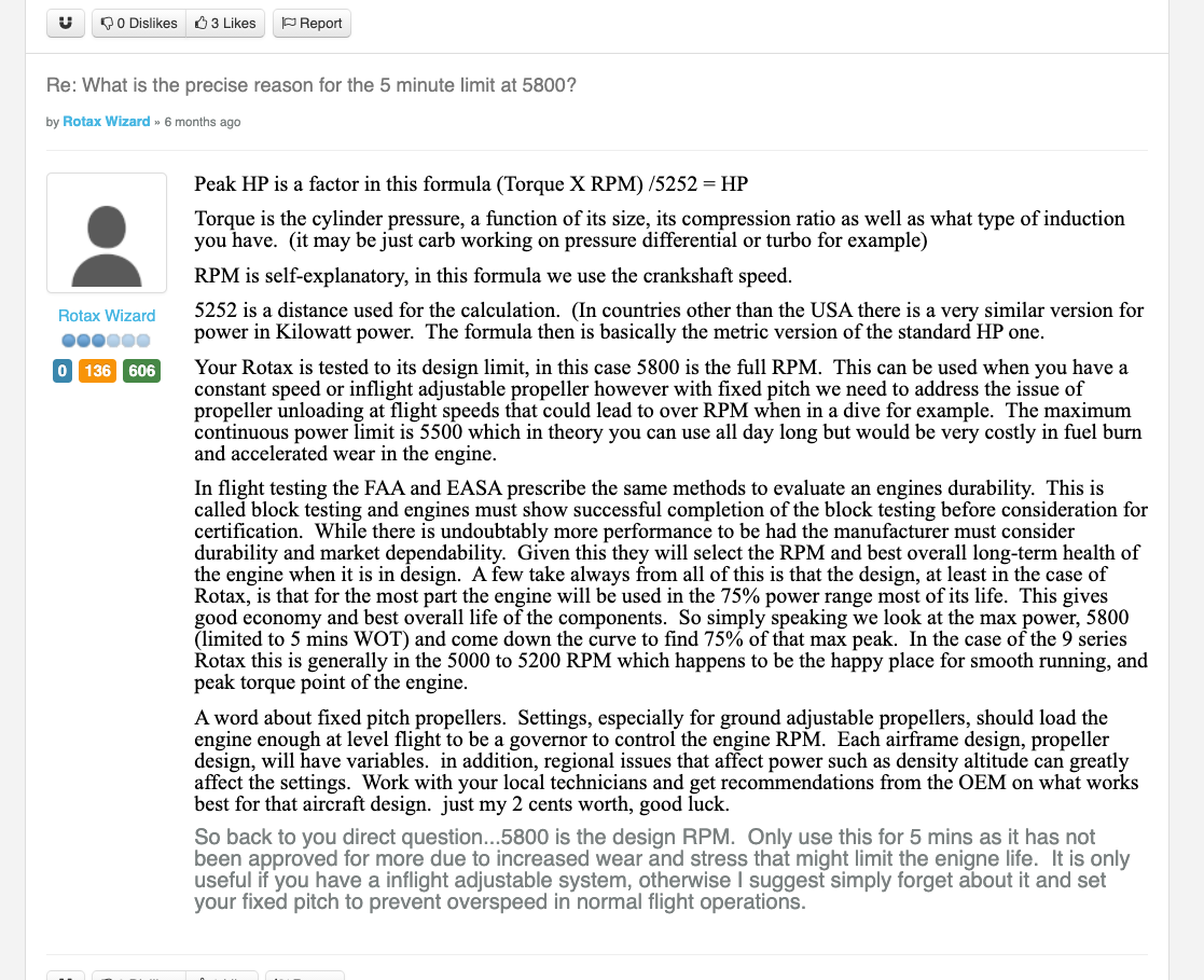

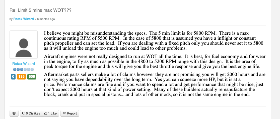

JG3 Posted August 22, 2021 Posted August 22, 2021 I do need to step in here and try once again to clear up some misunderstandings that are being tossed around. First of all, if an aircraft is pitched to 5500rpm wide open throttle (WOT) straight and level, then 5500 is no longer max continuous, not at all, it's now wide open throttle full power and is limited to 5 minutes! I guess I need to try to explain that.... The max continuous specification for an engine is not governed by the revs but rather by the amount of power being generated. That max continuous power is limited by the ability of the internals of the engine to dissipate heat away from such items as exhaust valves and pistons. The thermal efficiency of a Rotax at constant rpm will be better than a car on the road, but still only about 35% for the carbureted version. That means that only 35% of the energy in the fuel being burned goes to driving the propeller while 65% of that energy needs to be dissipated as heat. About half goes out in the hot exhaust gas and the rest through air cooled cylinder walls and liquid cooled heads. But the critical part is getting that heat away from the internals exposed to the fire and out into the cooling medium. Imagine a poor little exhaust valve with all that super hot gas going by and only the little valve stem to carry away the heat and through a layer of oil into the valve guide. That contact can only carry away heat at a limited rate, and the recommended max continuous is based on that conducting ability. At the Rotax recommended max continuous of 5500 when pitched to 5800 WOT, I measured fuel consumption to be about 20 litres/hr. That's as much fuel burn and thus heat as Rotax recommends for continuous operation. When pitched to 5500 WOT and then flown at 5500 I measured the fuel consumption to be 26 litres/hr. That extra 6 litres/hr is a lot of extra heat to be dissipated, and why Rotax recommends only 5 minutes at that power rate. The torque curve published by Rotax is based on WOT 5800rpm, and the top of the torque curve is between 5000 and 5200rpm. That's what they have determined by dyno testing to be the most efficient operating speed for this engine. If pitched to 5500 WOT then that curve will probably be very different. I measured the fuel burn at Rotax's recommended max continuous to be 20 litres/hr when pitched at 5800 WOT. When I pitched to 5500 WOT that 20 litre/hr showed to be at 5200rpm so 5200 should be the max continuous in that case. Fuel burn is a very dependable indication of power generated so I am very confident in these results. No doubt Rotax's recommendations are conservative, but are you comfortable exceeding those recommendations in your engine?? 2 1
Kyle Communications Posted August 22, 2021 Posted August 22, 2021 From the Rotax forum..where there are some very good Rotax experts

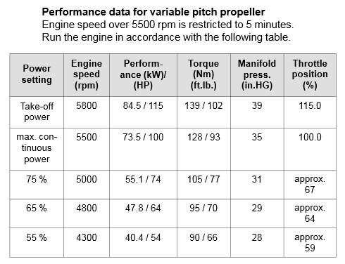

RFguy Posted August 22, 2021 Posted August 22, 2021 (edited) Right On, Mark ! That's the point I make, sure fixed pitch you could ptich for 5500 static but you'd need to be a very attentive throttle controller once the speed was up. ! JG3 you have a few errors ! TECHNICAL DATA FROM THE ROTAX BOOK max continuous performance : 69kW at 5500 RPM. fuel consumption at max continuous performance : 25 litres per hour. **** specific consumption at max continuous performance is 286g/kW/hour **** premium ULP caloric value ~ 46 MJ/kg, so translates to 13.15MJ/kW/hour, efficiency about 3600/13150 = ~ 27% probably +/- 7 % depending on how you value the weight of the fuel, the calorific value of that specific fuel etc Edited August 22, 2021 by RFguy

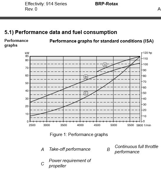

RFguy Posted August 22, 2021 Posted August 22, 2021 (edited) BTW posted out of interest : Rotax 914 see how the torque just keeps on going beyond max continuous ? the 912 is flatish beyond max cont. runs out of breath I think. see how the manifold pressure keeps rising at high RPM? MP on the 912 doesnt go far beyond 5500 WOT. Edited August 22, 2021 by RFguy

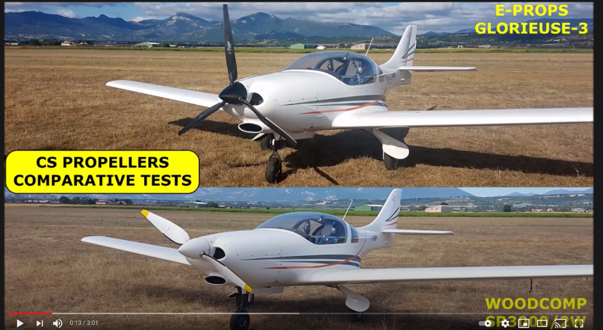

Kyle Communications Posted August 24, 2021 Posted August 24, 2021 First video out on the new Constant Speed Prop 1 1
Thruster88 Posted August 24, 2021 Posted August 24, 2021 Would be more interesting to see how it compared to the fixed e-prop. How good is the woodcomp? Compared to other fixed props.
skippydiesel Posted August 24, 2021 Posted August 24, 2021 On 22/08/2021 at 2:47 PM, RFguy said: SKippy - ROTAX say that is a MINIMUM OF 5200 @ STATIC RPM ( WOT of course). RFguy - you seemed to have missed my point(s) ; We are talking fixed pitch (which includes ground adjust) - you just muddy the waters when you bring in CS comments Static is always WOT (as far as I understand) If you follow Rotax recommendations, static should be 5200 rpm - with care this may be reduced slightly but pilot management, particularly in climb, becomes more critical, that is if you want to look after the engine. Of course the climb out at full throttle (WOT) will result in an increase in rpm - that's what you want for best climb performance - to 5800 if you so desire OR if you understand that climb angle can be used as a governor, you can increase/reduce angle, to control rpm/prevent overspeed and stay below max 5 minutes at 5800 if you wish. This should be part of the pilots engine management skill set. However I do not see how you can pitch your prop to achieve an inflight cruise WOT of 5500 rpm (or whatever) and still expect to see 5200 rpm static. I am not even convinced that this is even a desirable objective given the astonishing number of runaway Rotax 91 engines. To suggest that a Rotax 91 set for 5220 static will somehow unload/overspeed in level flight is just to suggest there are pilots who do not seem able to manage their engine.
skippydiesel Posted August 24, 2021 Posted August 24, 2021 1 hour ago, Kyle Communications said: First video out on the new Constant Speed Prop Sorry didn't want to duplicate the video - just to talk about the figures posted at the end. Some points: The two props not used on same aircraft - hardly a good comparison. Nor is the lack of data for aircraft weights, fuel loads, multiple tests results . etc etc I am impressed by the weight of the E-prop but given the above comment, hard to see the actual real world advantage of this feature It is usually accepted that a 3 blade propeller is likely to give greater initial acceleration, thus providing shorter ground role and often better initial climb performance - so no surprises here. What I would ask is why no better at cruise speed 3-4 kph to the E -prop is very disappointing ? as is a 7 % fuel advantage. Like Thruster88 - I would like to see some comparative data with ground adjust props, including E-prop.
Kyle Communications Posted August 24, 2021 Posted August 24, 2021 It came out at 6.30 tonight..it hasnt been released yet. I expect more to come of course. Dont know what video you are watching Skippy but its the same aircraft. They claim in the video better takeoff roll, better climb and 3 to4 kph faster...same aircraft same weight same day same conditions I am sure Eprop have consulted with Rotax on the numbers they require for all modes of flight. Eprop are no dills. IF YOU adjust it as they say in their fitting and running instruction then you will get the performance they quote and also we have seen the difference in performance in the ones fitted here. It all goes back to rule #1 ....RTFM
