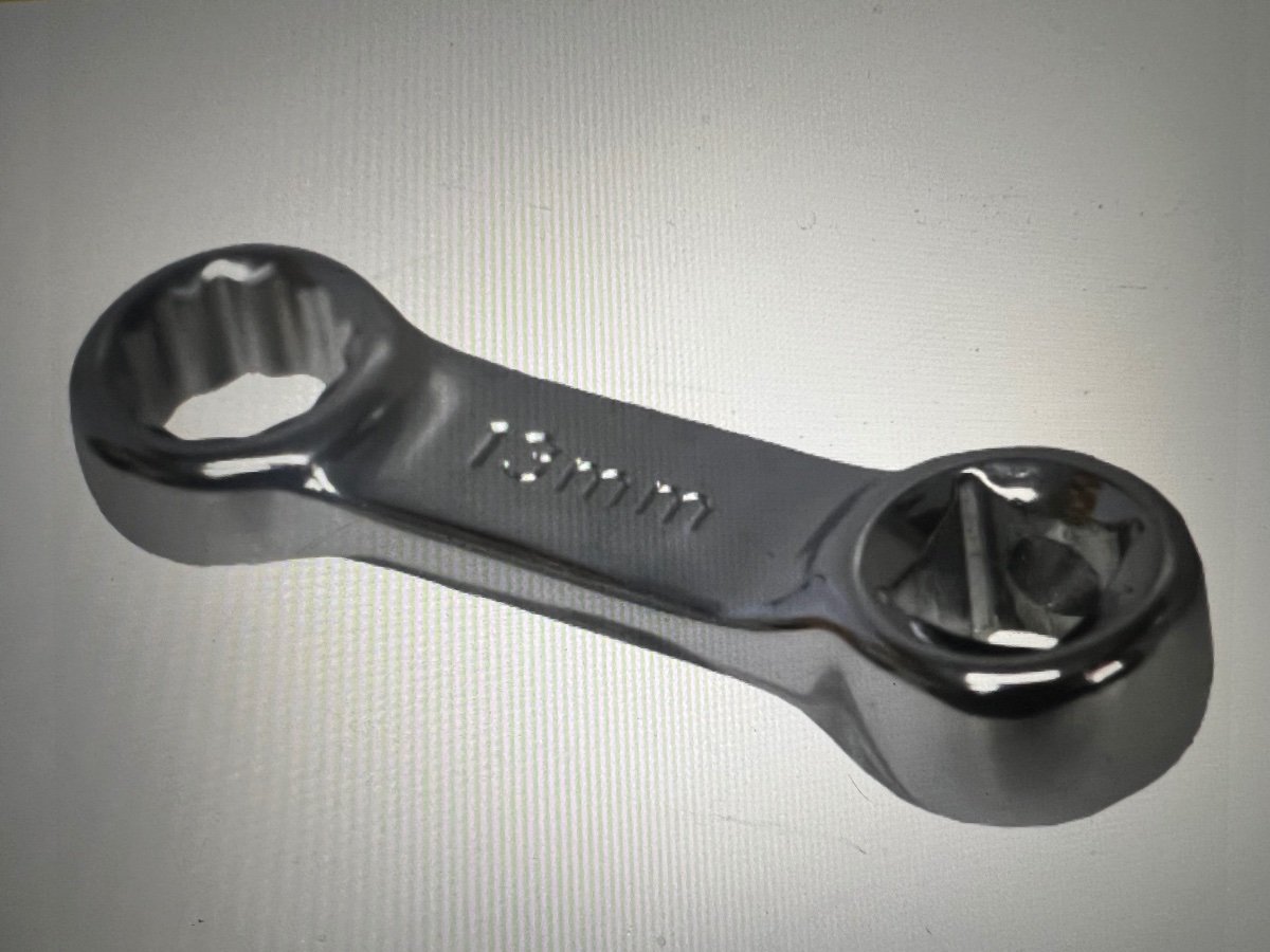

Blueadventures Posted February 27, 2025 Posted February 27, 2025 For info I have recently purchased this adaptor tool for torquing the prop hub to flange nuts used for Eprops and some other propeller brands that are not attached using the usual drive lugs on the Rotax flanges. Will be handy. Just need to do calculation for reduced Nm setting. 1
rgmwa Posted February 27, 2025 Posted February 27, 2025 If you attach the adaptor at right angles to the torque wrench there is no need to adjust the recommended torque. 1 1 1
