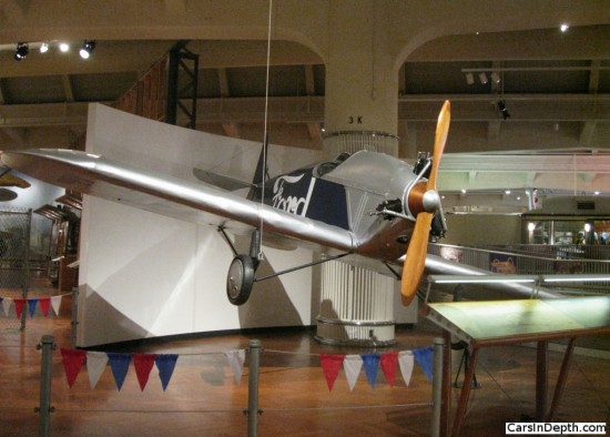

Just about every aeroplane has wing diherdral. The only one I've really looked at that doesn't as the Ford Flivver.
https://www.thetruthaboutcars.com/2014/07/henry-fords-flying-flivver-the-model-t-of-the-air/

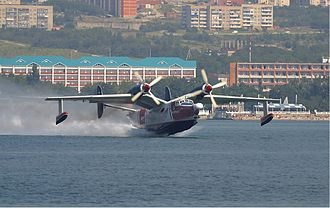

I can see the advantage in gull wings for flying boats, and the wonderful Piaggio P.166B,
but where's the advantage in the inverted gull wing for the Stuka?
