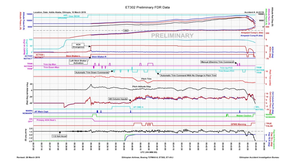

And second, if they physically could not manually trim due to the pressures on the stab/elevator (and only one crew member would have been available for that if the other was fighting to get the nose up) then maybe re-engaging the trim servos was a last desperate effort to trim using the trim switches. Certainly there are 2 videos from different pilots in this thread so far suggesting that manually working the trim wheels could have been very hard, and harder by the moment with the speed rising: in one of the sim recordings the copilot makes a futile attempt to hand trim, and the pilot then gives him a hand.
In that situation the trim wheels are almost impossible to turn manually unless pressure is relieved by pushing the nose down. The assumption is that they did not follow this recommended procedure as they did not have the luxury of altitude. They were at almost 500 knots heading towards the ground at 40 degrees nose angle when the trim was switched back on with less that 2000 feet of altitude. All the armchair experts saying they should never have retracted the flaps when there were indications of abnormalities not long after takeoff are not helpful. The pilot was very experienced with an excellent record. There was never any time in the entire flight to get the manual out & start working through options.

Both problems they had are memory items.
Interesting to note the pilots never touched the throttle during the whole process and ultimately were WAY over Vne
