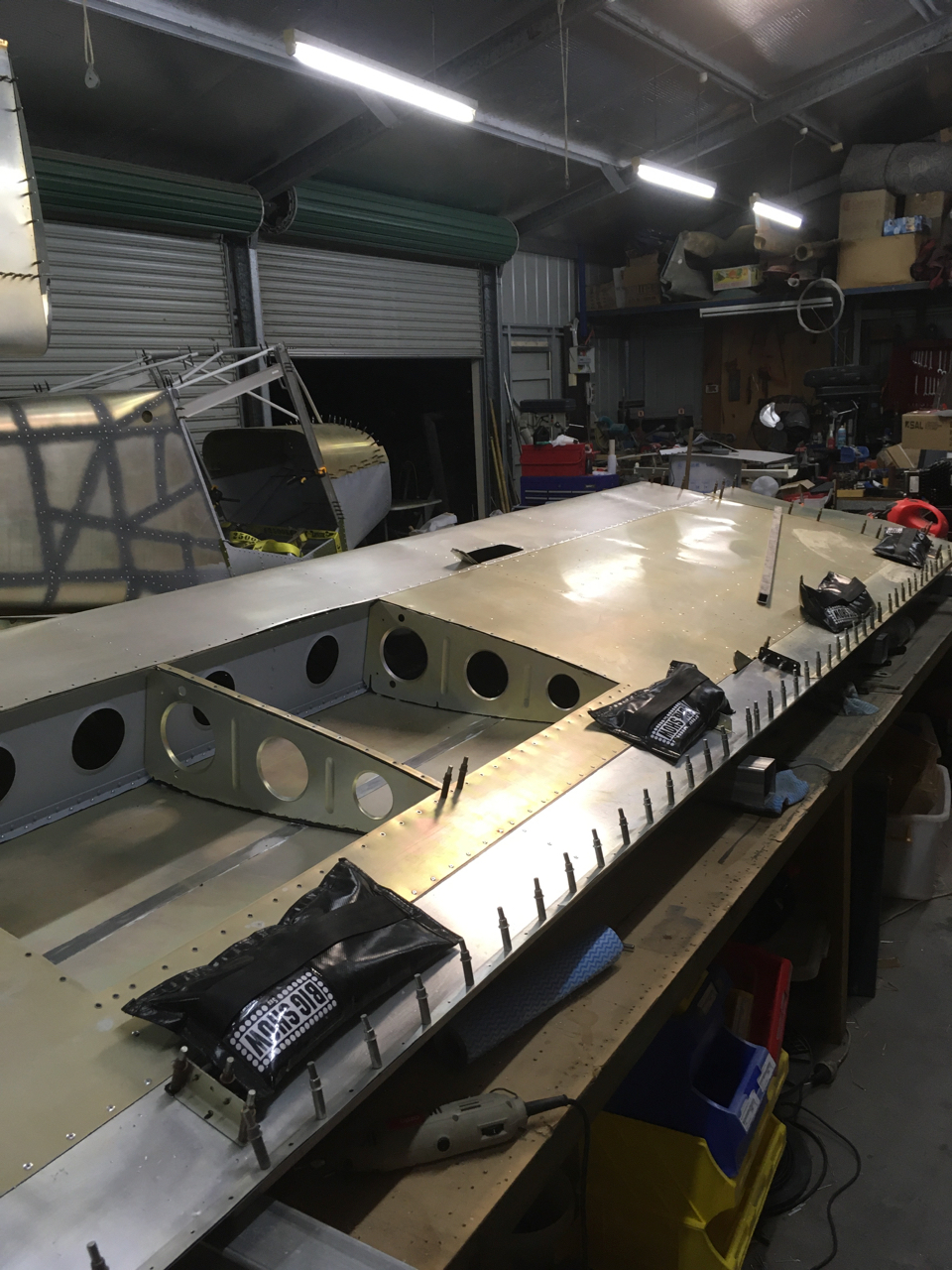

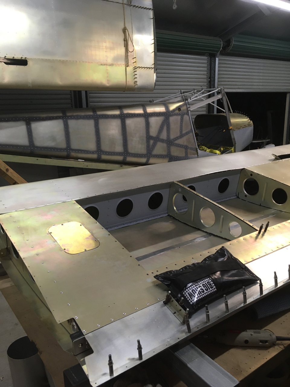

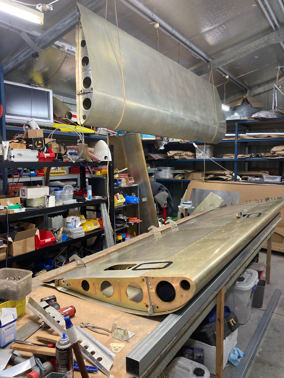

I tapped and drilled the alu strips for the angle on the spar for the tank cover tonight. Then spot the sikaflex so when it gets pulled up by all the screws it doesnt get into the threads and make the screws impossible to get out. Pics should tell the story. Quite a few havent seen these tapping drills. They come in metric and imperial and they are fantastic. i use them so much its not funny. just in the battery drill it drills its own hole and then taps then just reverse out but anything more than 3mm alu becareful as you can easily break it off in the hole. But with care they are great. Also quite cheap I get them from Banggood..
[ATTACH alt=IMG_8349.jpg]50789[/ATTACH][ATTACH alt=IMG_8348.jpg]50790[/ATTACH][ATTACH alt=IMG_8350.jpg]50788[/ATTACH][ATTACH alt=IMG_8351.jpg]50787[/ATTACH][ATTACH alt=IMG_8355.jpg]50791[/ATTACH][ATTACH alt=IMG_8352.jpg]50786[/ATTACH][ATTACH alt=IMG_8354.jpg]50793[/ATTACH]
I'm one that hadn't seen the tapping drill before. Fantastic idea! Jeez why did I muck around with those bloody nut plates, could have just put some small bits of ally there and tapped them.
Might do that for all the other places I want to screw together. Sounds good for where the cowling joins the skins overhanging the firewall.

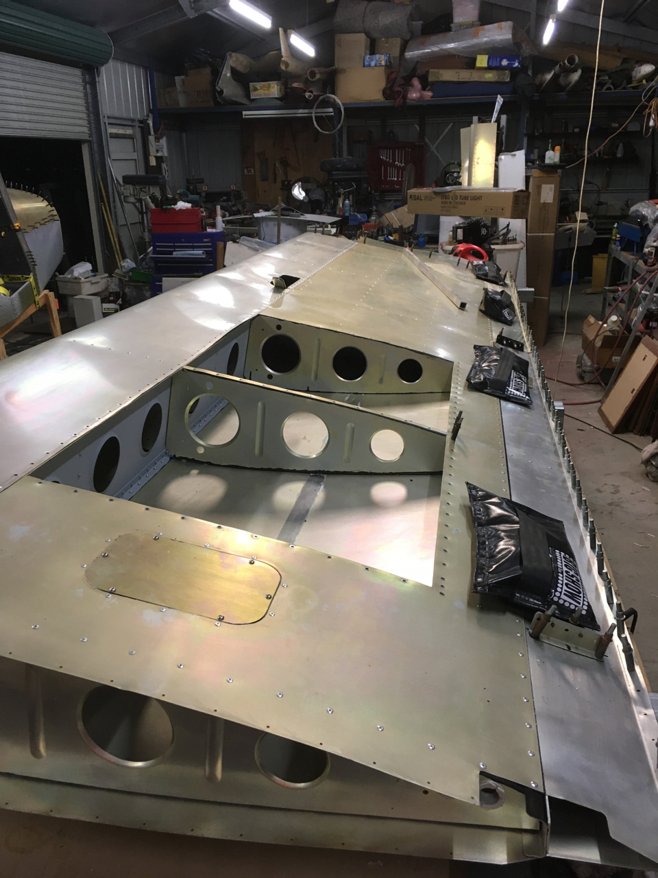

Just finishised putting masking tape under the front rib edges ready for the Dskin and to epoxy the holes to allow the sheet to have its proper curve without pulling the skins in when riveted. Tomorrow night should get the bottom skin on and rivnuts around the fuel tank cells. Was away at the farm for last weekend so no work done on Mabel but hope to have the wing pretty much all skinned and done by the end of the week.

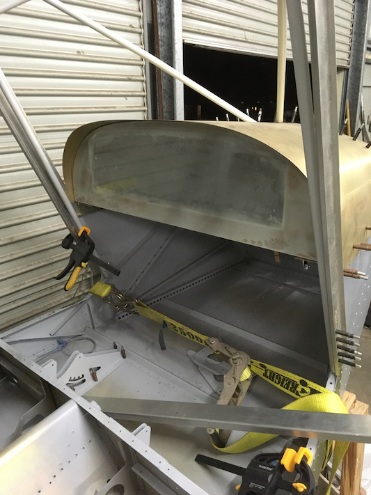

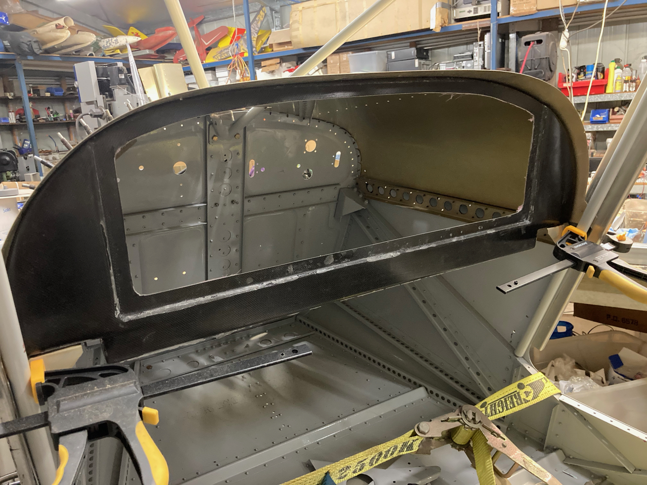

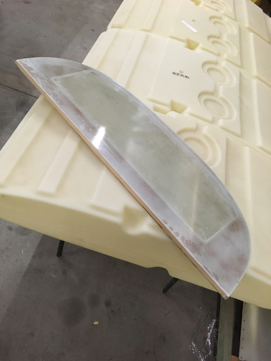

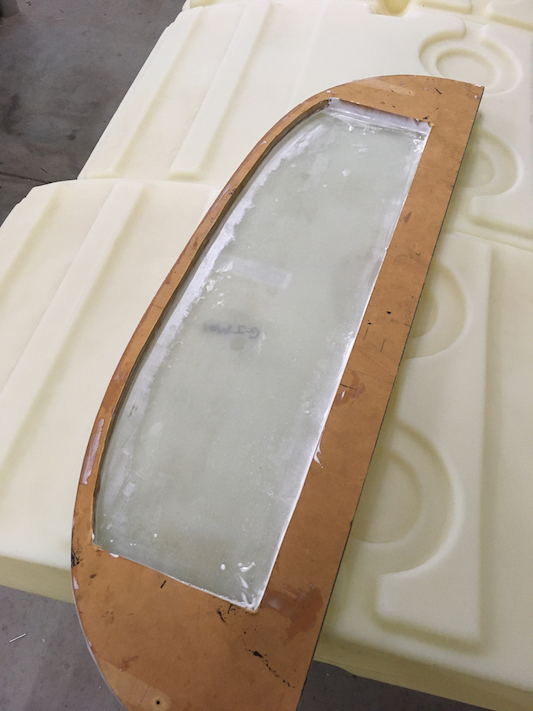

Just got the mold plug from Danny tonight for the new dash I just have to shave the ends to get it to a good fit at the boot cowl side then he can finish the plug and we can get the new dash frames done. We are both pushing the dash a bit further to the front of the plane to allow a better look angle to the dash. The dash itself will must likely be carbon and finished with that nice looking weave and also hinged at the bottom to make easy access to the instruments. Also we will have a fixed section either side like the new style ICP dash for throttle and choke and other stuff that you dont need to get at.
This is a reverse plug so the inlays are added to the plate to create the plug
Hey Marty, just be aware that:
1. Nut plates (broadly speaking) offer a far stronger fixing then a hole tapped in ally strap.
2. Nut plates also grab the screw/bolt very tightly, effectively providing their own 'self-locking'
As I see it, it's a horses for courses thing. For instance:
Mark is using a row of tapped ally holes to secure the LE of his tank underskin, and that seems like an entirely appropriate application to me. However, the LE of the Savannah tailfin is held in place by 2 bolts into nutplates, and there's no way I would be replacing them with tapped ally.
Yes I agree with Bob...the places I use this method are not for high strength of course. I wouldnt be attaching the sides of my cowl to the skin of the fuselage with it. I would use the steel nutplates. On the top of my cowl though I used rivnuts into alu thinish plate the main cowl attachments at the side use nutplates. The top and bottom seams of the cowl I use Camlocks

Back at working on Mabel again. I have had a few weeks off mainly because I couldnt work on her or anything else really as I couldnt see properly. I had a skin cancer cut out of my right cheek...no not my bum cheek :)....It wasnt supposed to be too much drama but when the surgeon got in there he had to mod what he planned. So basically he removed my whole cheek to cut it out and so he had to get enough skin to cover it all back up..so the right side of my face had a facelift. I had to stay in bed for at least 3 days after the op and after that I couldnt see as my right eye was totally closed. Its been 3 and a half weeks since the op and now pretty much back to normal.
So since the last episode.... I have continued working on the last wing. Its almost finished now. Just have to fit the last half of the solid rivets into the trailing edge and do the wing tip outer panels and tip. Should hopefully get that finished this weekend. I have to scrounge some more rivets from Danny and a few more rivnuts (those tank skins use up a lot of rivnuts) then it will be finished all bar having to panel beat that triangular section that fits in the root rib above the door. Its a bit crushed so have to spend a bit of time to straighten it...its very difficult to make a new one so quicker to panelbeat. Did the usual trick of the epoxy in the holes on the front 3 holes in the Dskin over the ribs and the 2 rivets behind the spar... really happy with how it came out. I did have a couple of whoopies in the Dskin which I had to form out..I am getting much better now getting those dents out of these skins.
So after this just waiting on the new dash frame from Danny and I can lock up the cabin frame and will finish the tail bracket that attaches to the tailplane mount so I can fit the fuselage in the rotisserie. Then pretty much everything will be ready for painting

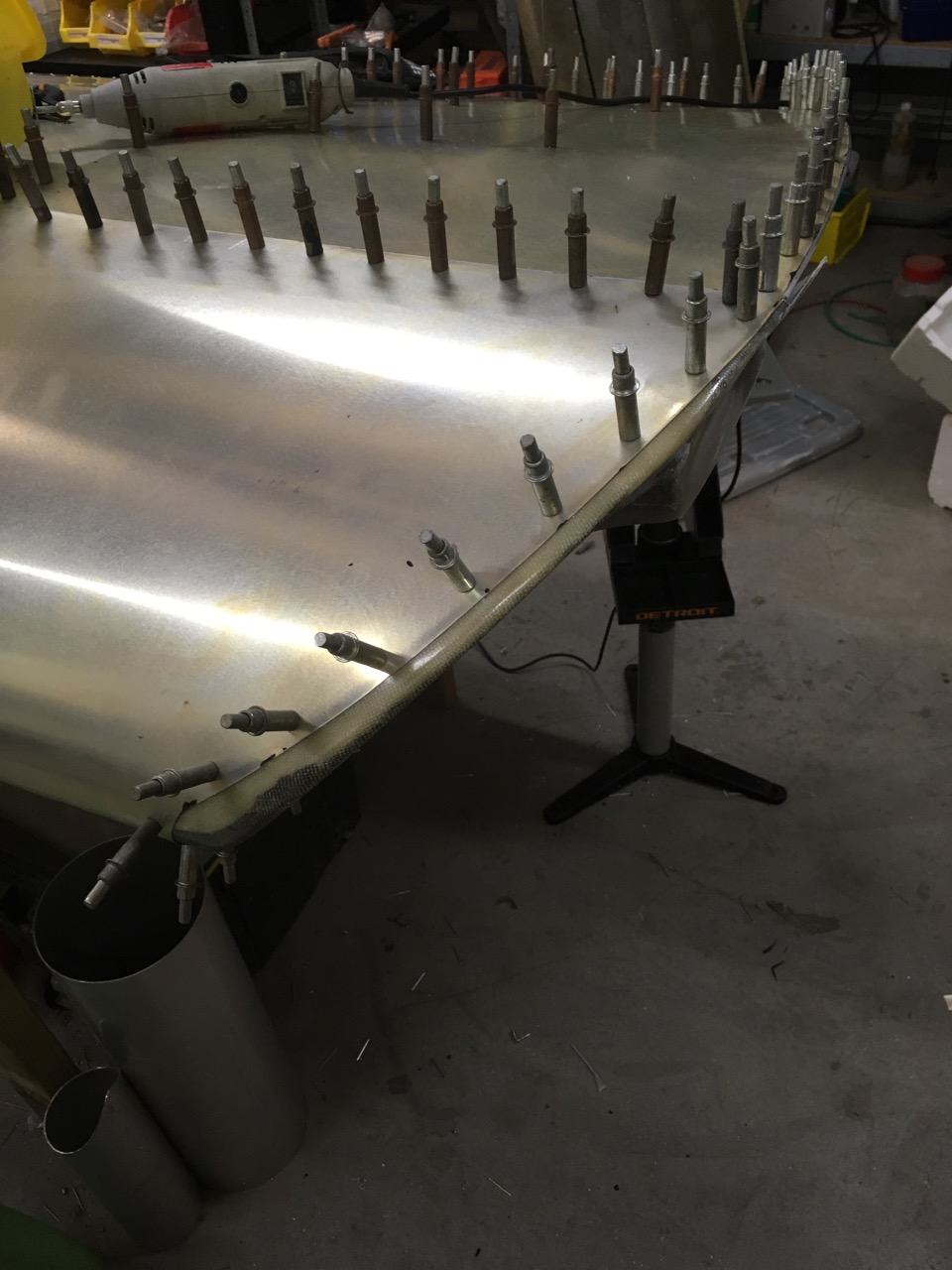

When you said 'whoopies in the D skin taht you had to form out'....do you mean the sort of dent you get when you fumble the sheet in a certain way and it leaves a sort of little crease at the edge of the dent? I think I may have seen it referred to as 'fishscale'........I'm not sure???
Yes Bob I have not heard of them being referred to as a fish scale but that would certainly describe it. Danny Leach showed me how to get them out..its time and patience and a little tool I made on the lathe..after a little practice it actually works quite well

If we're talking about the same sort of LE dent, I read somewhere that it could be taken out by careful burnishing with smooth hard convex object...like the face of a hammer.
I have had good success using this method: first using a very fine emery to polish the face of the hammer to ensure it was entirely smoothe, then applying a little grease to prevent it grabbing, and burnishing the crease in the LE with a tight circular motion and steady pressure.
I have done this on both my own wing (where I attempted to wrap the LE from top to bottom, resulting in a fishscale dent near the strut attachment point) and also on a another builder's wing. These were small but unsightly dents, and in both cases they were completely removed.

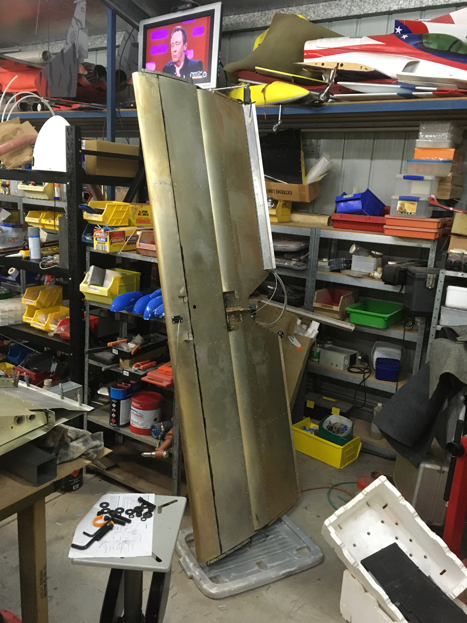

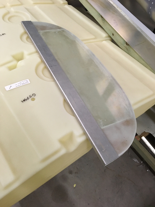

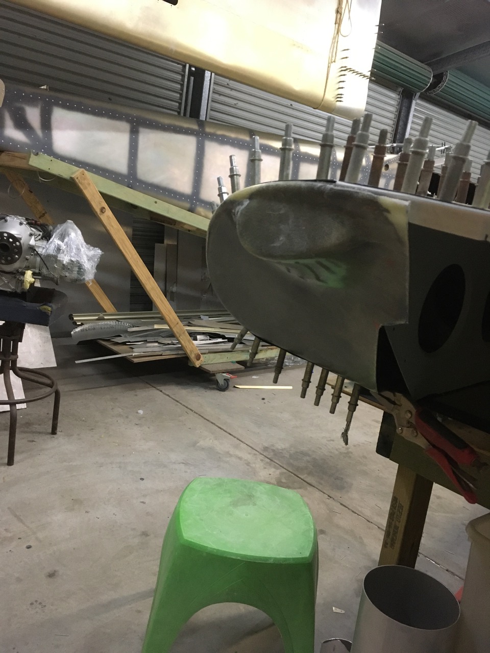

Worked on the tip today. Went really well. The tips that Danny pulled out of the mold he made of the original split tip style used on these earlier 2010 type savs fitted just like a dream. They would be able to be used on any of the new style ones that have those horrible new fibreglass tips or the latest metal tip
I am sure I posted some pics of them earlier in this thread. So easy to do literally too 15 mins and it was fitted. It helps of course using the plywood former I made to make sure the outer tip LE skin is held to the proper shape. I also had to make the tip V at the top . That turned out pretty easy with a pair of fluting pliers I bought for the S-21. It is a heavily vee'd strip at about 60 deg and then when you flute it the piece curves to conform to the shape of the tip skin.
Just have to make the bottom 120deg straight V strip then I can finish the tip with the rear flat plate section

Similar to the Zenith tips, the plastic only goes back to the spar.

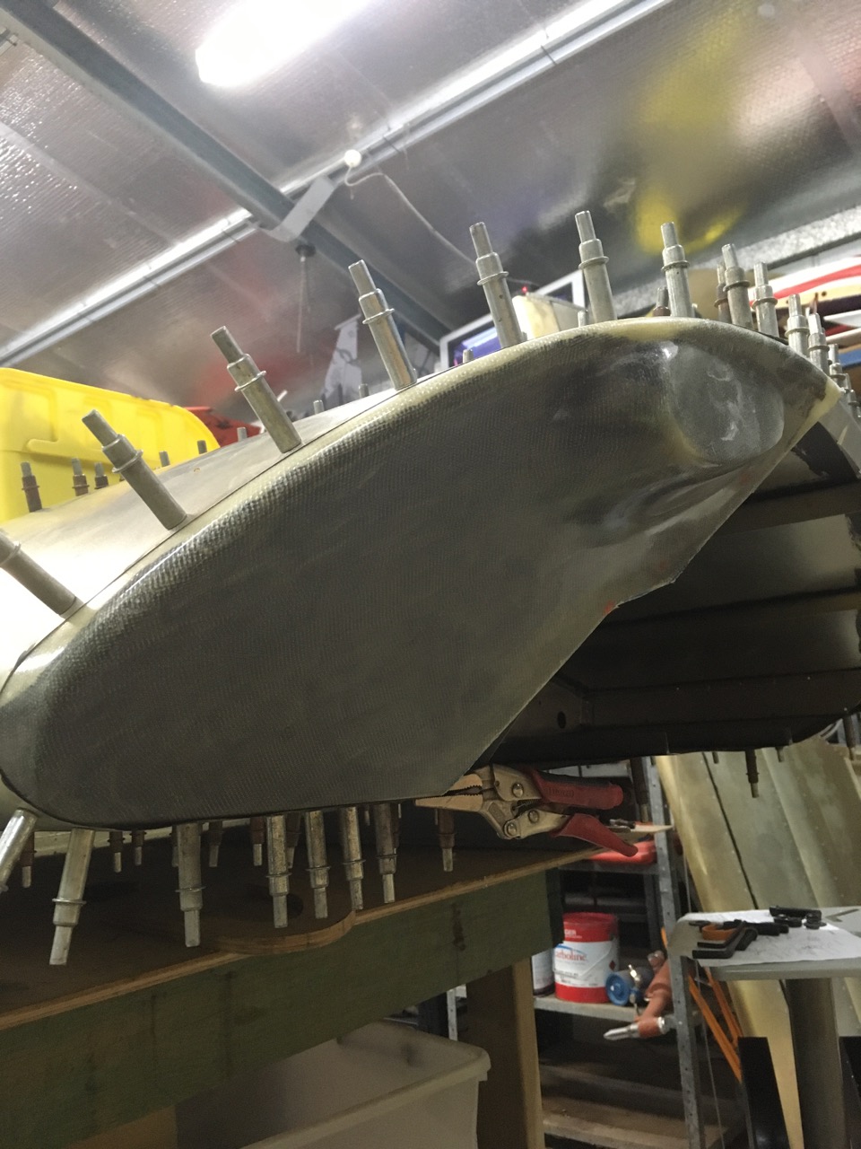

Second wing pretty much completed. Wasnt happy with the tip section..it didnt look right so pulled it all apart and redid it but this time not freehand I used my table jig to make sure the skins were flat and level compared to the top skin. The first wing is now back on the table and the second wing is now hung up out of the way so I can finish the tip off on that first wing. Danny had not finished the fibreglass tips from the new mould he has back then so time to do another tip and a few other finishing bits

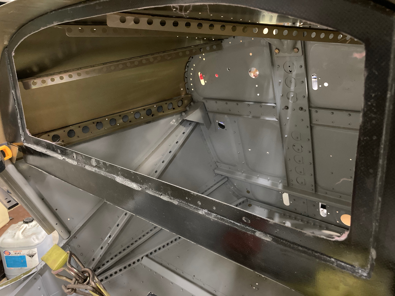

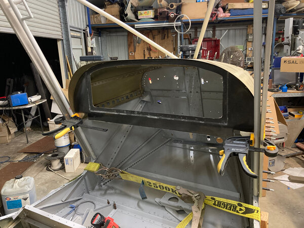

First dash frame out of the mold and the cutout done. Trialed fitted it into Mabel tonight. Looks really great !. Its stronger by at least 2 fold compared to the original and just as light. Main coverage is carbon fibre and the rest is high spec twill glass matt. The frame is sized so that it sits back at the top by about 30 mm from the original to make the dash look angle better for us larger/taller people here in OZ. It is similar in design to the later dash panel with the fixed side areas and the panel cutout. The bottom rail is about 25mm deeper to allow more room for the switches and to give more panel space for instruments. The sav throttles will be in the same place but I am fitting the McFarlane throttle and putting it in the bottom rail area. I will make a small bracket to hold the throttle and carb heat there. I of course have twin sticks in Mabel so a centre throttle is a no brainer especially when the Rans is the same so it will allow me to get more comfortable with that throttle position
The dash instrument section will be alu and the bottom will be hinged to make it easy to get at everything for the wiring instead of laying on your back trying to get all the wiring done. The panel will also be rubber mounted on grommets so to dampen any vibration on the instruments.
Once I have all the mounting holes done for the dash frame then it will come out and be finnessed as far as edges and finish. We were going to have a carbon matt look finish but it really needs to be vac bagged to get that so it will be hand finished then painted

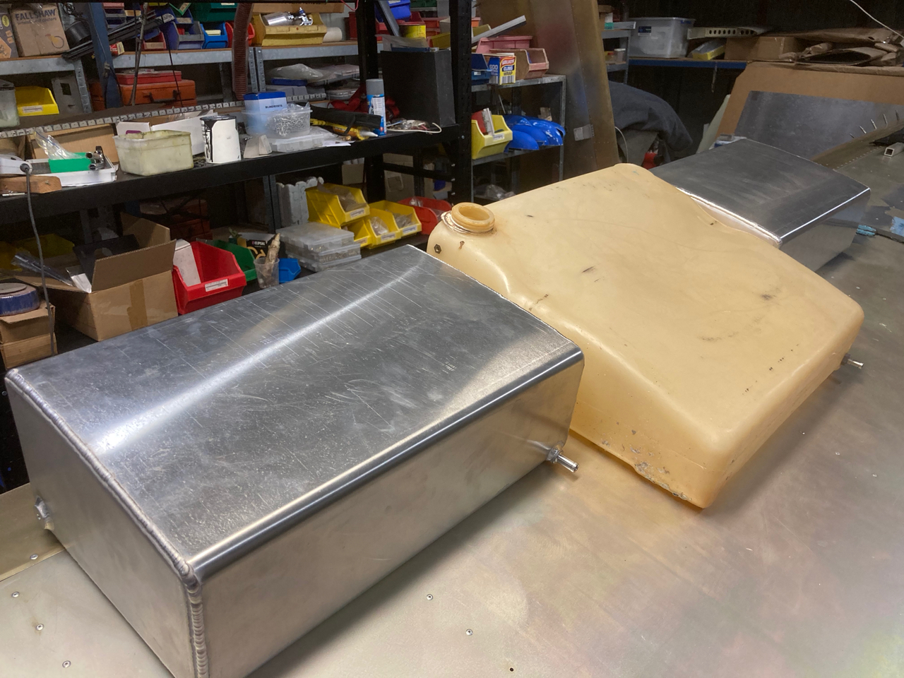

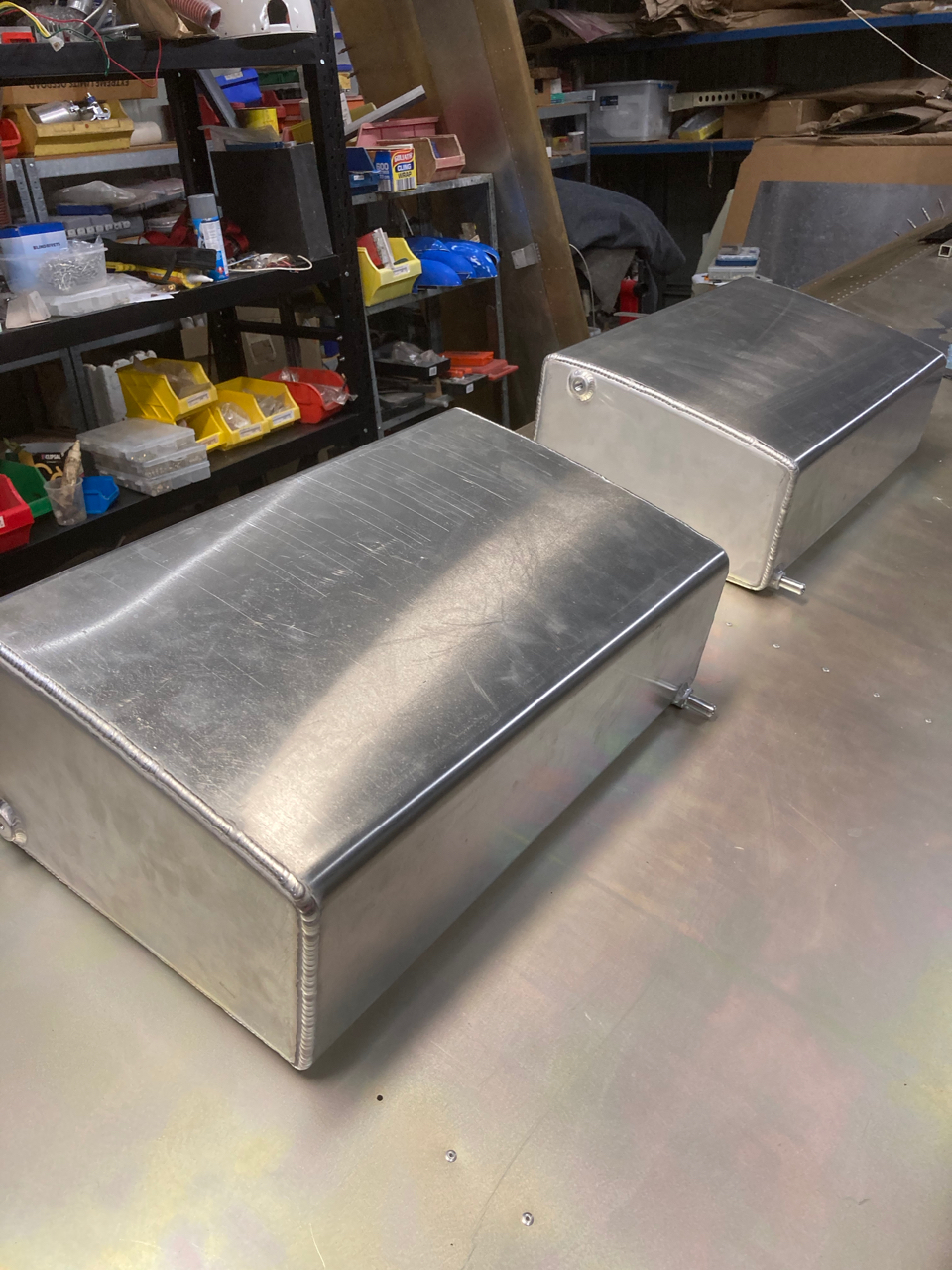

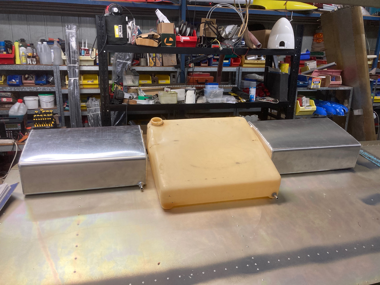

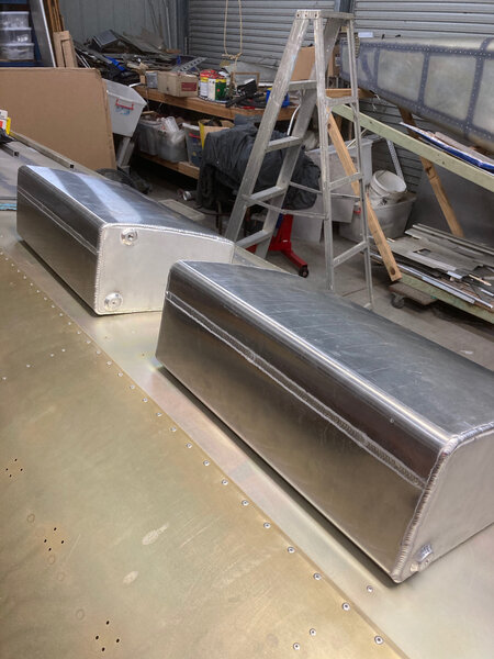

Got the new wing tanks back today from the welder. Danny made up the tanks and the end caps and did a fantastic job on them. He took them to the local gun welder and boy its a nice job too. Tanks have been pressure tested as well. These will replace the outer plastic tanks. The way they are designed it to work in series with the inner tanks but the bottom area is much smaller and the outlet will be higher than the plastic tanks so should be able to drain every ounce of fuel out not leave quite a few litres like the plastic tanks. I will measure the capacity but we think they should be around 24 litres each so 72 plus 48 gives heaps of fuel for what I want to do and also will require less switching of the fuel. Also 2 breathers on the tanks should allow better flow. My plastic tanks I have to mod yet. I am making proper flush fuel fillers for them so should be less disruption on the wing so no two big caps hanging in the breeze. The new tanks will be mounted similar to the originals you can see the side mounting bosses. Its a 1/2 inch outlet so will take a little extra time with filling but pretty sure it will all work better and still give me much more than peeing range
