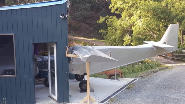

Blueadventures Posted April 15 Posted April 15 From your image face plane towards the big door. Have prop line just forward of the drain grate line. Chock the wheels good, maybe even level up the lower main wheel. Add a double securing with rope or a strap to a secure point behind the plane so it does not travel forward when engine running. This way you won't pick up any stones or rocks. 1 3

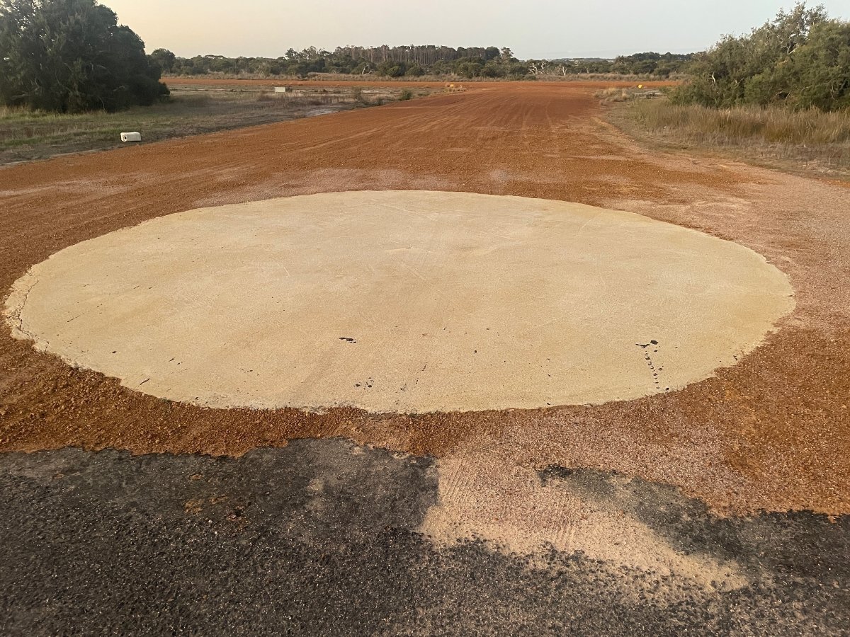

Moneybox Posted April 15 Posted April 15 (edited) I was considering laying a bit of concrete or laying a area of artificial grass that is pegged down with sand laid in it. Here at Myrup, Esperance they have a circular patch of concrete, about 30m from the gravel airstrip, that looks like the top of a tank of some kind. It's about 3m across and does the job nicely. Edited April 15 by Moneybox 1 1
Marty_d Posted April 15 Author Posted April 15 5 hours ago, Blueadventures said: From your image face plane towards the big door. Have prop line just forward of the drain grate line. Chock the wheels good, maybe even level up the lower main wheel. Add a double securing with rope or a strap to a secure point behind the plane so it does not travel forward when engine running. This way you won't pick up any stones or rocks. Oh, thanks, but she's not in that shed. Up the road in a bigger one. 2 1
Moneybox Posted April 16 Posted April 16 I realise now these are poured just for the purpose. Each taxi way has a runup pad like this. 3

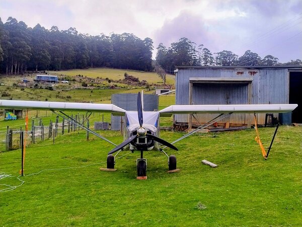

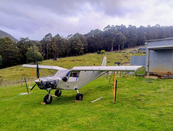

Marty_d Posted September 13 Author Posted September 13 Okay, it's a few months later, but finally ready to start the engine. Today with the help of some good friends I got the plane out of the shed, got the wings on and pounded in some star pickets to tie down to. Tomorrow I will also tie the main gear back to a very solid post before trying a start. I also made a control lock that I'm quite happy with. That's locking up the rudder and elevators now, if the flaperons were attached it'd lock those too. Will post photos of that later. Any final words of advice? 9 3
IBob Posted September 13 Posted September 13 Looking great, Marty! I fired mine up with the cowls off, allows an observer to check for leaks during the initial run, I had a fuel leak at the splitter. Also for any pipework or wiring etc that is vibrating and requires further securing. 2
